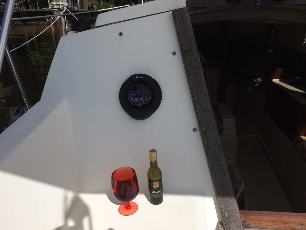

Admiral bought a nice Richie SR2 compass to install on the port cockpit bulkhead, requires a 4 5/8" hole saw to drill thru the bulkhead. Before I drop $50 buks on one to drill one hole, anyone have one in their tool collection they care to loan out, for shipping & handling? ...long shot I know, but thought I'd ask...

WOW, Gene, you 'da man!....just reviewed the template, min hole is 4 1/2" (max 4.80"), so it'll work! If I need a bit more a 1/2 round file/rasp will fix that. Check your pm and thank you!!

hate drilling holes in boat, especially BIG ones, but this was necessary...gotta have a decent compass...and many thx to Gene for his assist, toasted to him with a nice Cab once done...Cheers!....

WOW. I haven't got a set to do that yet. Still looking at surface mount compass's for the cabin top

Sharp looking compass. Which one is it, exactly? Daydream came with a compass, but I removed it and cut an even bigger hole, for a chartplotter. :yikes:
It's definitely not something you do lightly. Holes that size don't just go away.
tis a Richie SR2...contrary to youtube vid and some of their other models, it doesn't need to be mounted plumb/vertical so no fairing block needed (per their tech folks)....comes w/inside & outside covers and inclinometer....install was eze, albeit scary drillin that hole...!

We have a nice bulkhead compass, but I hesitate to install it there. I'm leaning towards 2 compasses, one mounted on each side of the cockpit. have you tested leaning against yours ?
So I may end up with 2 smaller holes, more expense, but better placement. Unfortunately the size of these boats forces some compromises.
