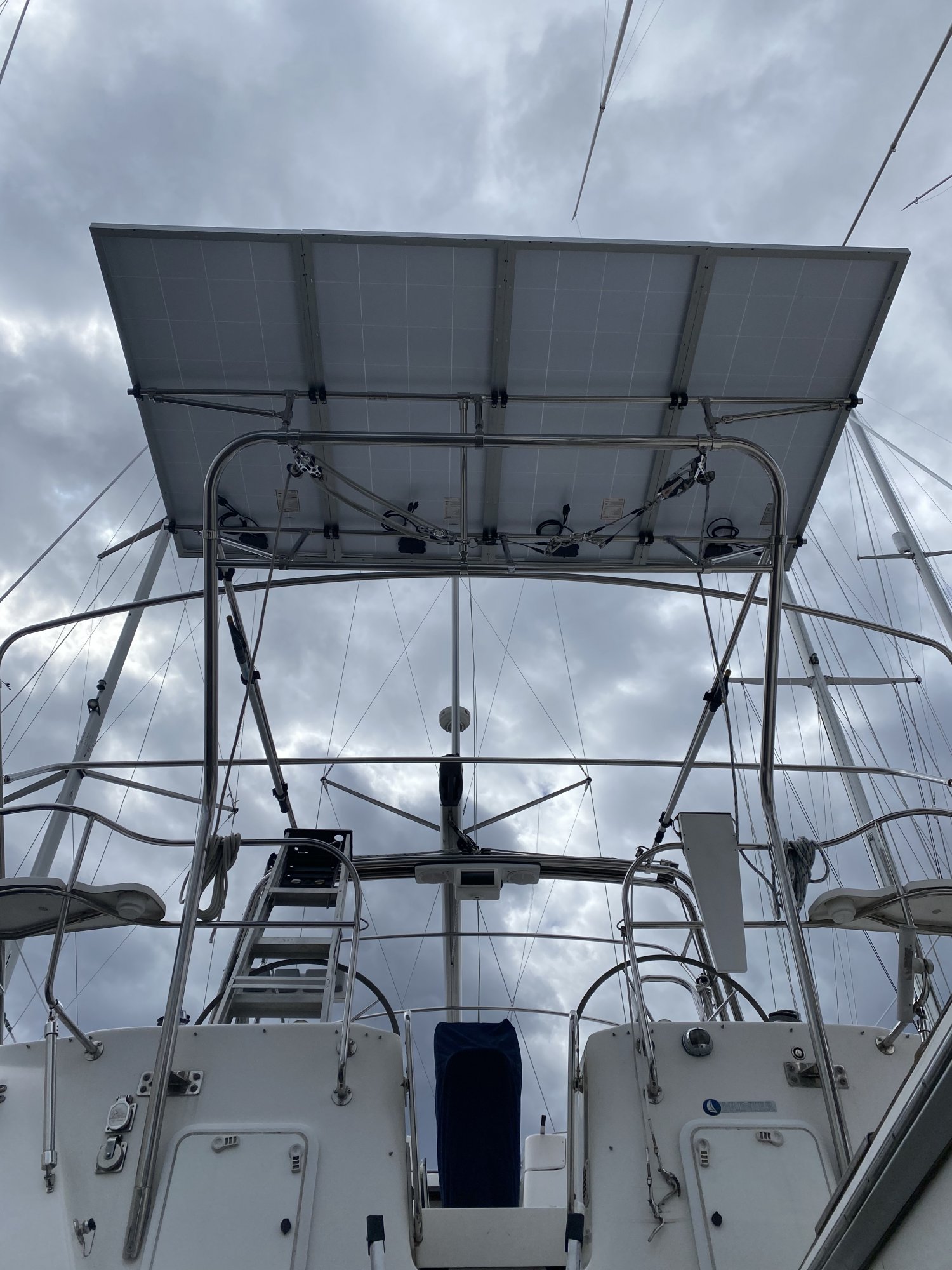

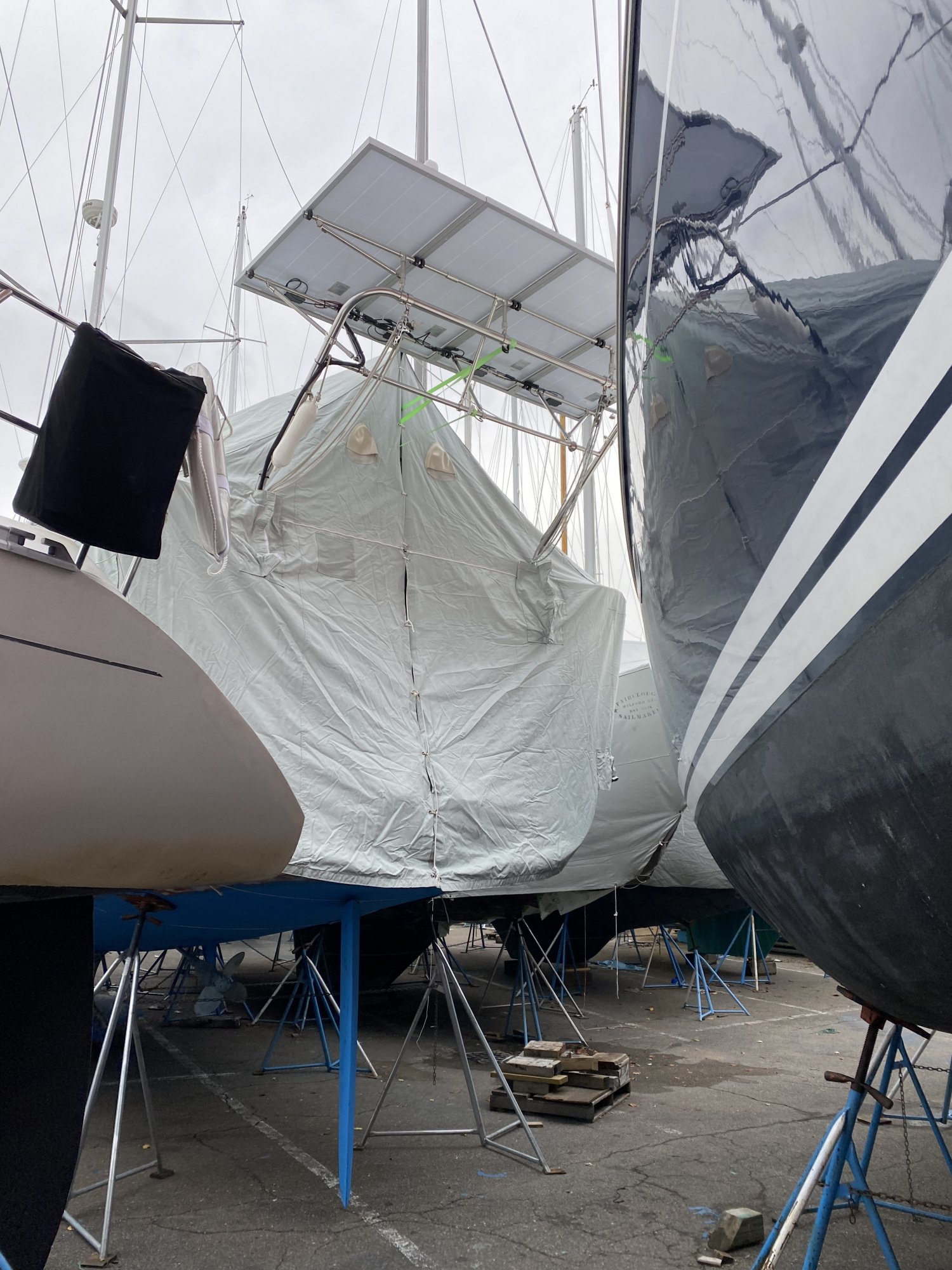

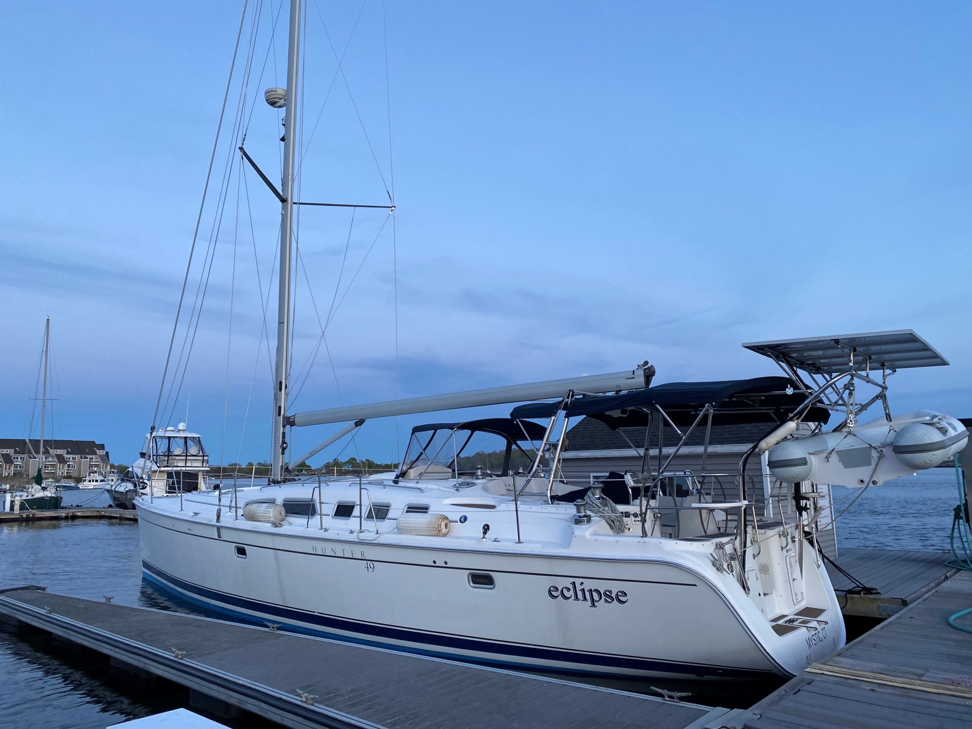

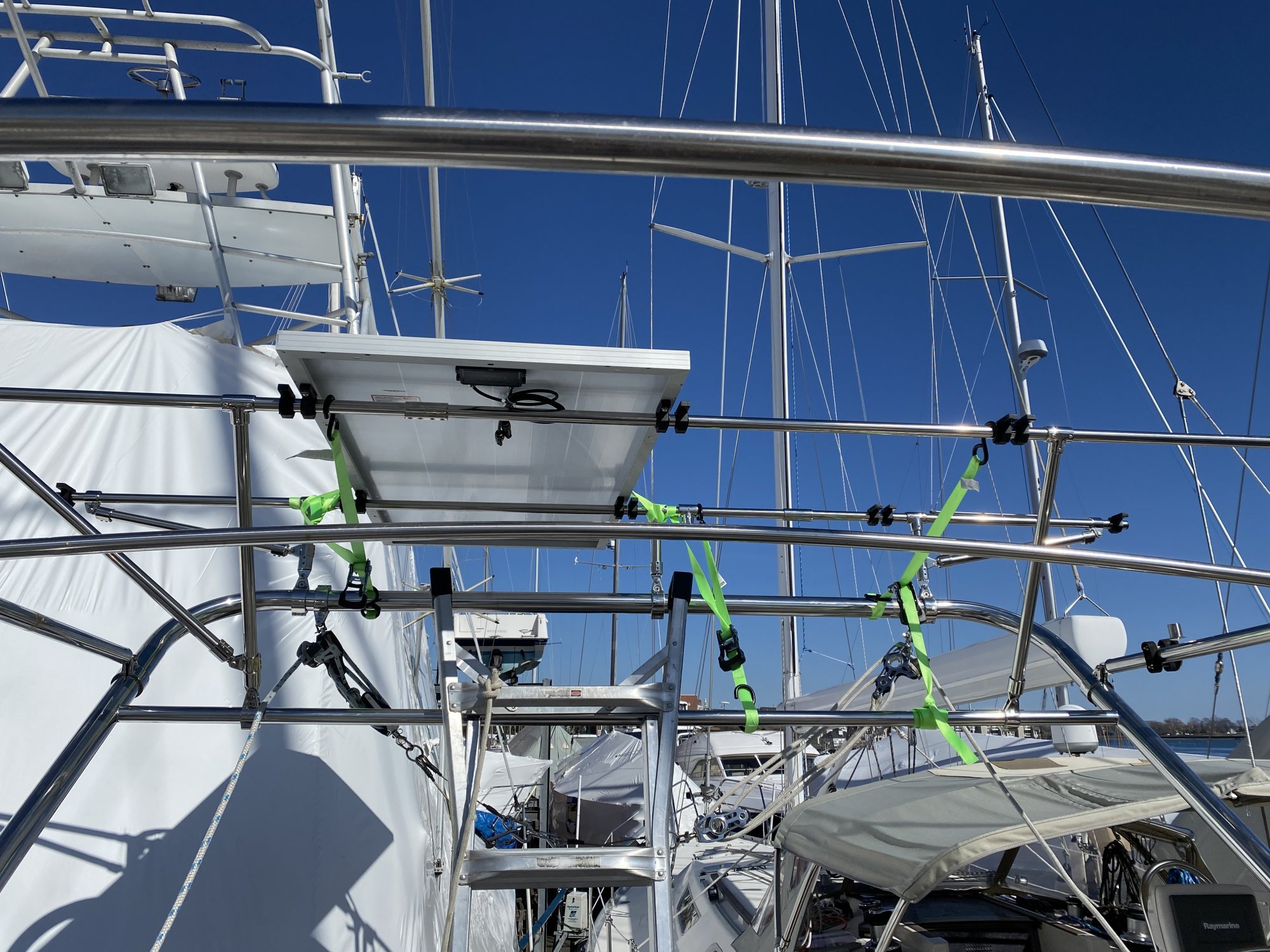

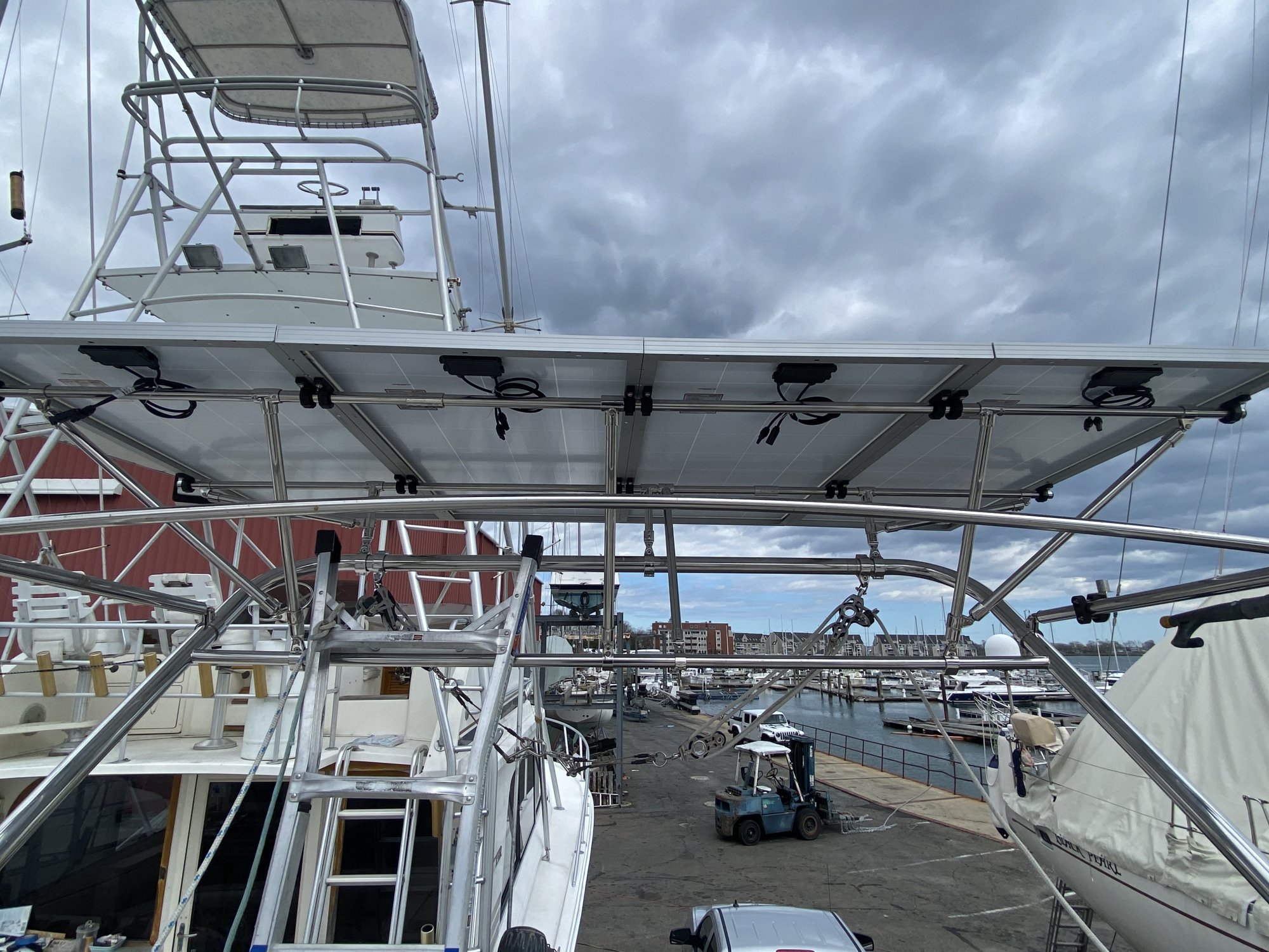

Any chance you could send pictures of how your solar array is mounted on the factory davits?
@tkwhalen Kevin - Attached are some pics of how I mounted my solar panels to my H49 davits. I mounted the panels astern enough to allow for my winter canvas cover to still be used. The panels sit outside of the cover as shown in one of the pics. There is also a pic of when I was fabricating it using ratchet tie downs to assist in holding things in place.
286
Hunter 49 60803 Lake Erie
These pictures are very helpful. I want to mount mine in a similar way. Did you have all of the hardware to do it fabricated or buy it off the shelf from some where? Any issues in heavy wind that you have noted?

I purchased the tubing from Defender. Connectors from various on-line sources - US Marine Canvas (best source I found for 1x 2" Stainless Steel Hinged Jaw Slide), Amazon, Wholesale Marine are the ones I remember. The array has been through two seasons and I have not had any problems with high winds. I am on a mooring or at anchor most of the time when not sailing, so wind is typically from the front. If I were on a fixed dock in an area prone to high winds, I might add additional support on the aft part of the panels. Highest wind sailing has been 35 knot gusts with no issues that I experienced but I was probably focused on other things the time, LOL. Panels are fixed in the level position reducing windage.
Feel free to reach out with any other questions or if you need additional pics. I'm sure my design can be improved upon but it's worked well for me and I was able to fab and install myself.
