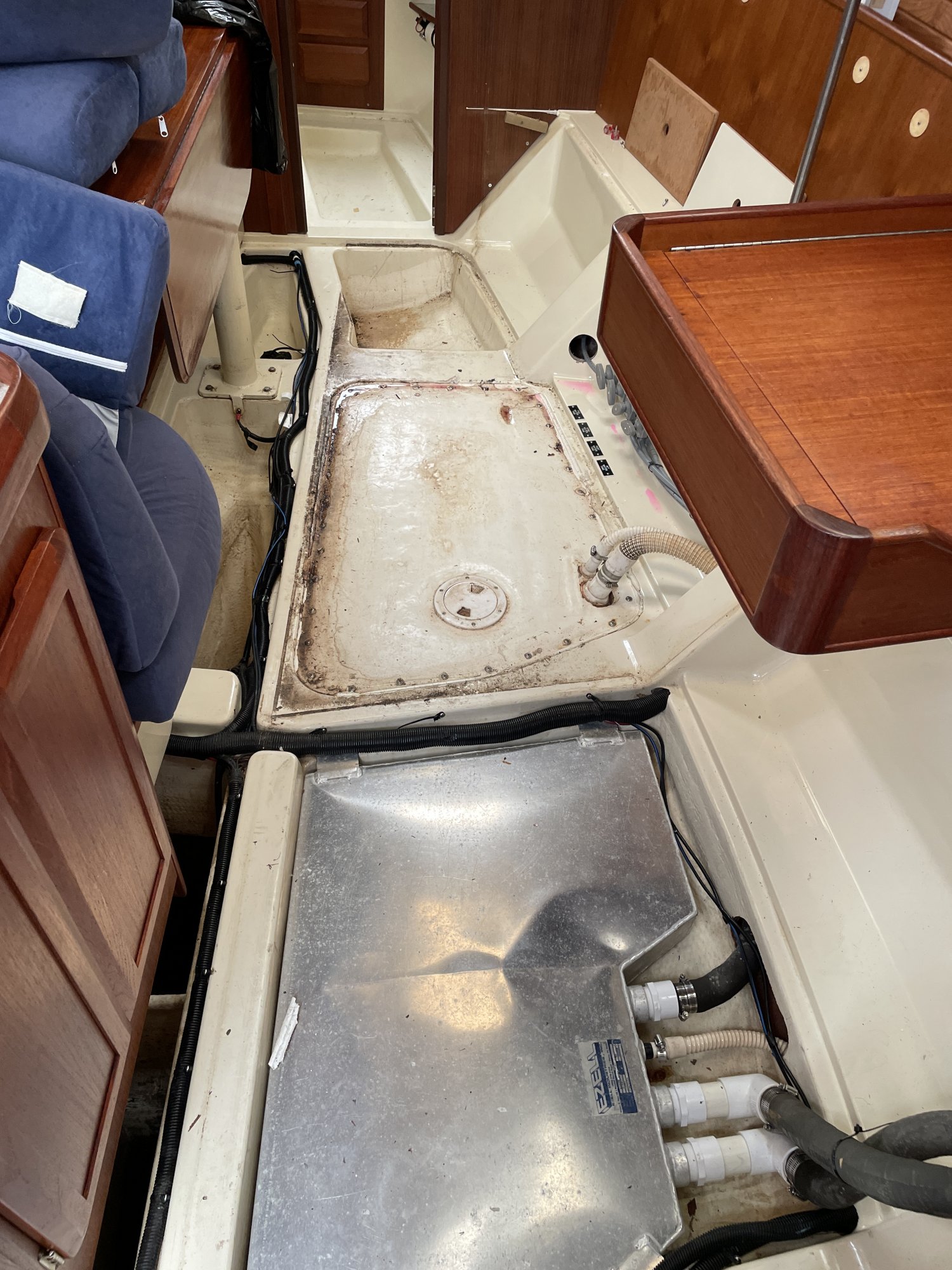

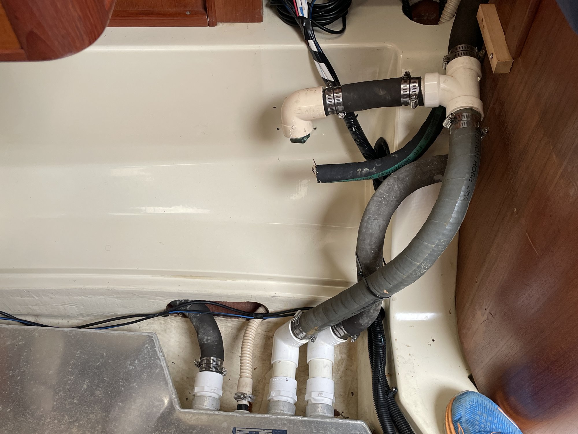

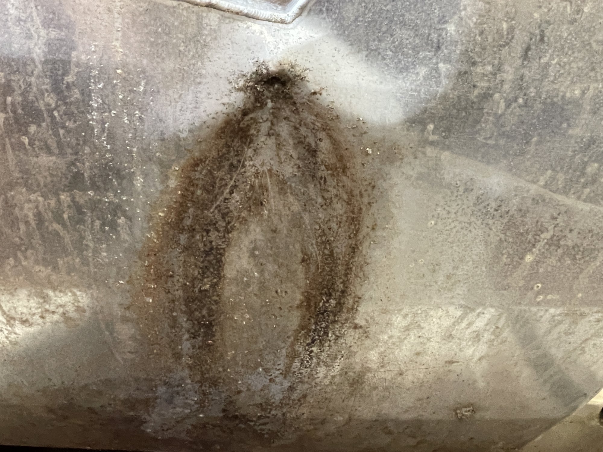

I have been putting this project off for three years now. The only original problem was the failure of the macerator pump (which can't be used on the Chesapeake anyhow) and resulting leakage. The pump was removed and all offending tubes were closed off. The original tank did not leak, but it looks like it was damaged by implosion and pumped back up due to a clogged vent (note picture). I learned about this problem on the forum....after I bought the boat. The vent was clogged by the outside screen and debris. Once this was opened the tank emptied/vented properly. It might be leaking now or the tubing is permeated. Either way it is time to replace everything. I am inclined not to replace/plumb for the macerator. Most of the other "fun" jobs are done...I told my wife I prefer "preventive maintenance" to a catastrophic repair.
I have read the other threads numerous times, but I would like to condense the information here:
1) Replacement tank from Triple "M" plastics.
a) Have them make a 1 inch vent.
b) Where do I get new fittings and their sizes? These are threaded in?
d) Tank sensor to coordinate with Raymarine?
2) Use Raritan Saniflex
a) Length from forward head 19 feet. Use old hose fastened as described to pull lubricated new hose back to tank.
b) So what size and total amount for forward head, saloon head, pump out and vent?
c) How to access vent and deck and new fittings? Looks like a major pain.
Any help would be appreciated. Thanks in advance.
Of course since I have the cabin sole out I happened to check the port and starboard water tanks. They look pretty scummy. Method for cleaning tanks without removing the entire lids? Spray or sponge into them or use pressure washer on low?

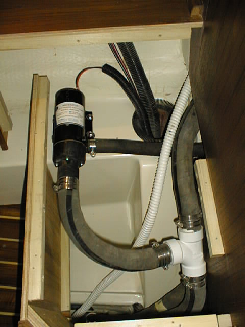

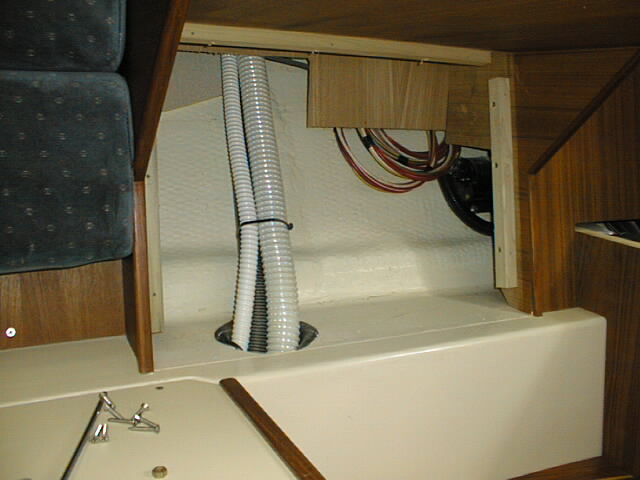

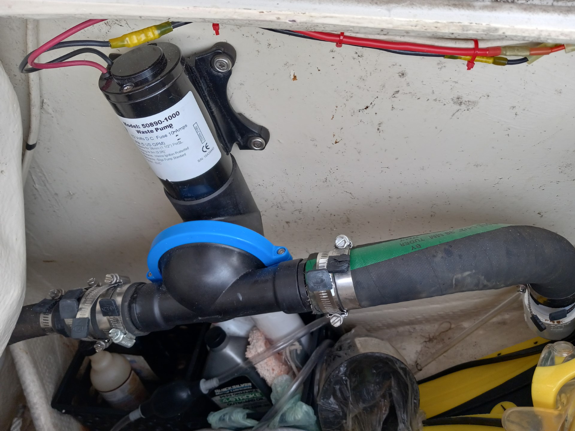

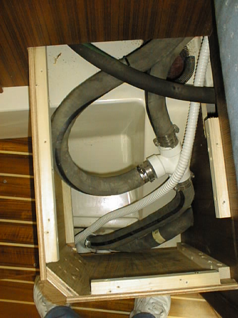

The macerator pump is a weak link in the system. Since we have to have it disabled on the Chesapeake and never use it the pump goes bad before it is ever used. Then it leaks. Maybe I could include a valve before the pump so waste does enter it during pump out. The macerator is horizontally mounted to the clean out line with a 'T" so waste flows past and slightly into the macerator during pump out.
The macerator's original location was PITA to service. I moved it to the shelf under the NAV seat and positioned it for easy service. You might want to consider this option even if you are not going to use it.
The attached pictures how the original location and the hose routing. The first picture shows the new location of the macerator.
Rick D
Jun 14, 2008
7,190
My macerator was moved when the boat was recommissioned for me 25 years ago and is in a similar position to Rich's. I never saw it in the OEM position, but where it is now is an easy service FWIW.

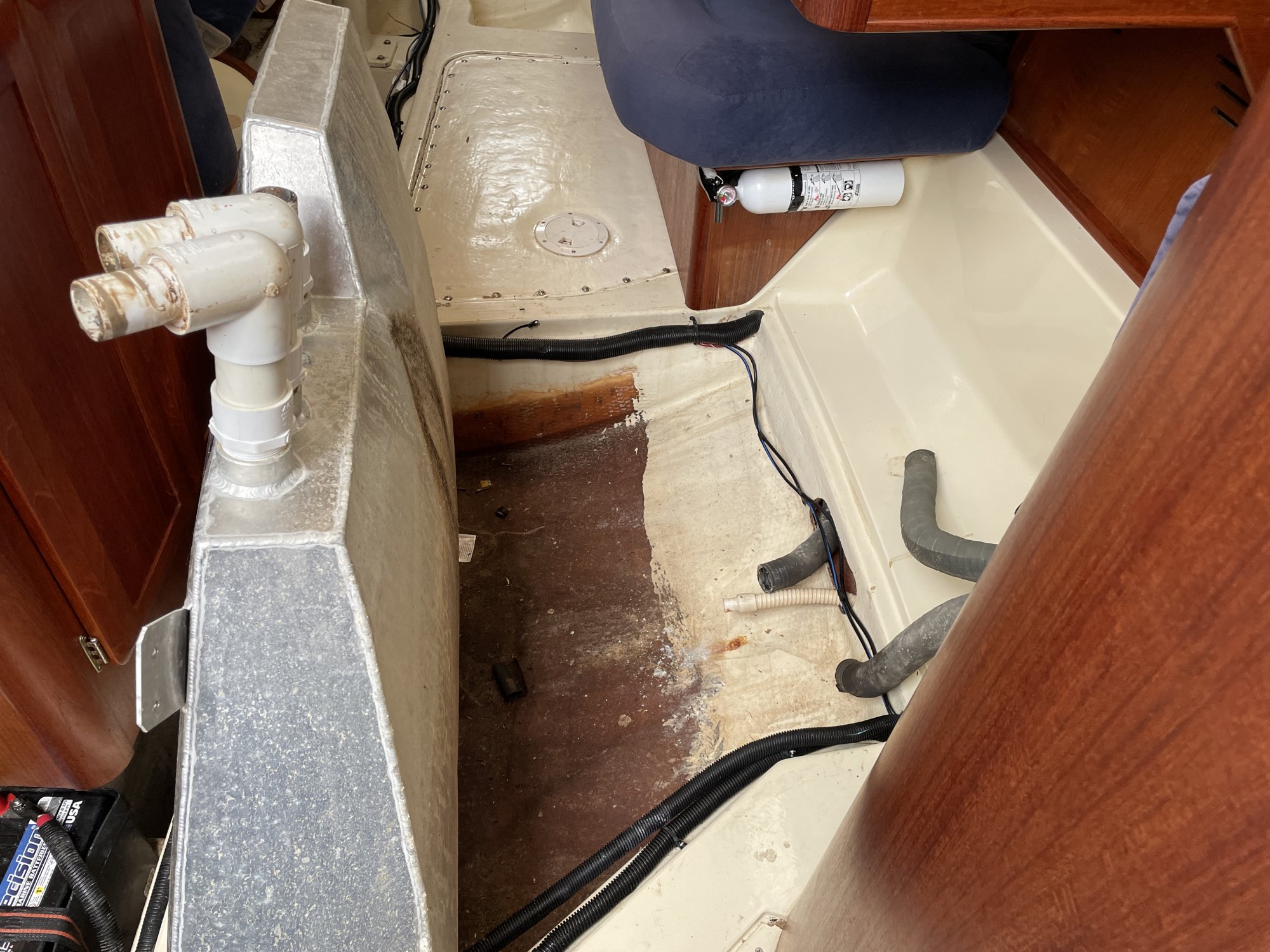

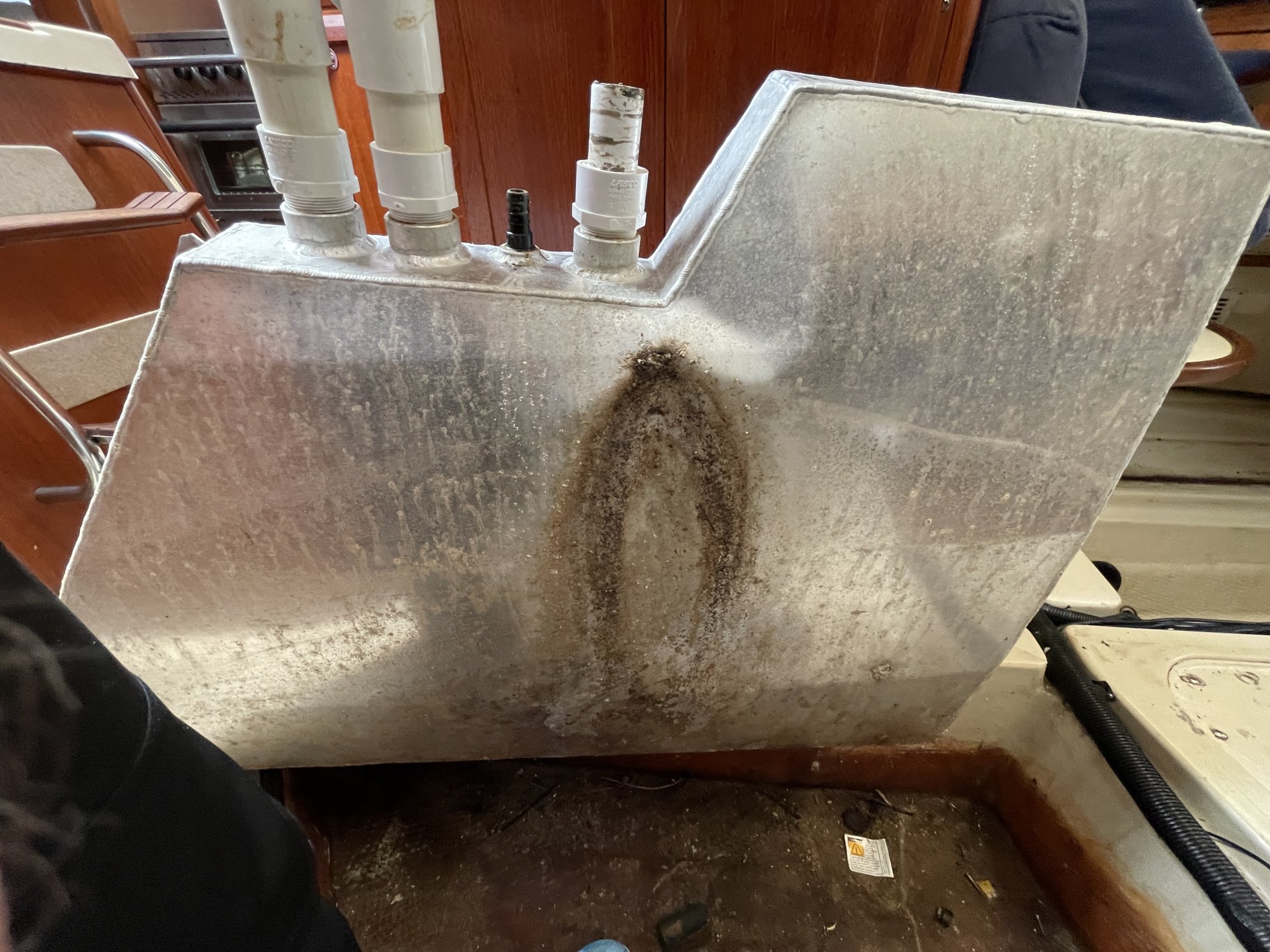

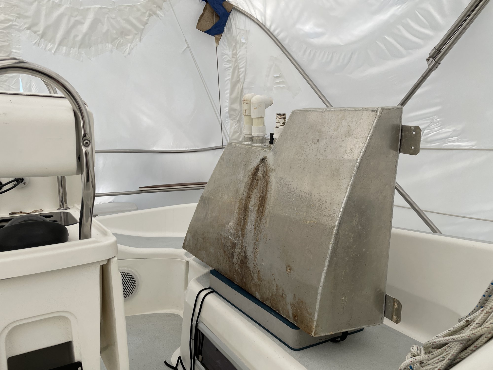

Ok so the holding tank is out. I was afraid that I was not going to be able to pull 1 1/2" off of the fittings. With a little bit of twisting they all came off. From the pictures you can see that there was a small hole on the bottom of the tank and corrosion under the vent. We were very fastidious in previous seasons about pumping out the tank and rinsing every weekend which probably limited leakage and odor. It was starting to smell.
The best part was lifting the tank (with some fluid and antifreeze) out the companionway by myself. The openings were obviously "up" by my face and I got stuck in a position where I could not move and every attempt to rotate or translate the tank created a blossom of tank stench in my face. Of course any reasonable person would have made some attempt to close off the tank before moving it, but in my rush to get the job done I neglected this important step.

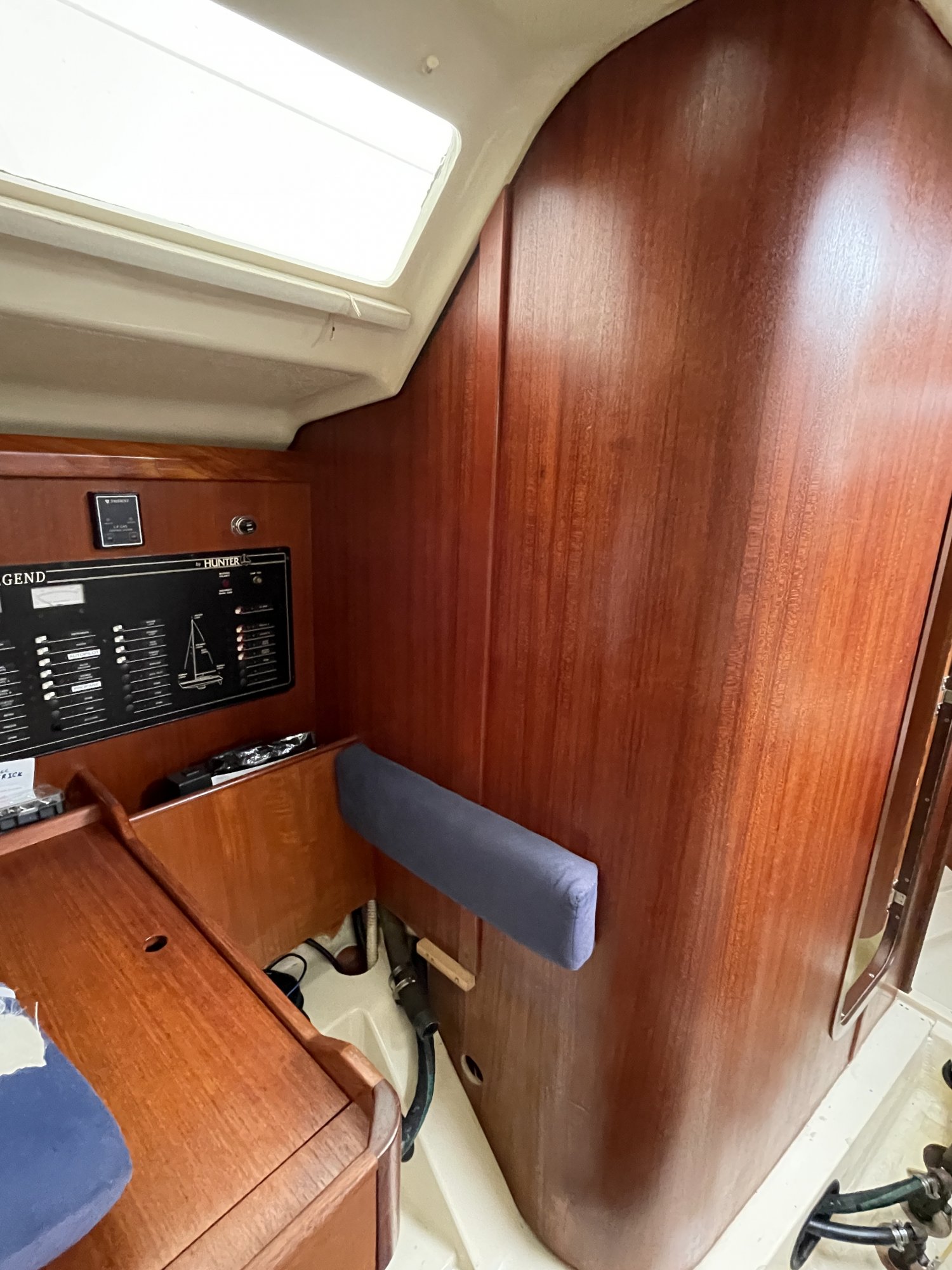

I have the custom tank ordered. My next question is how to access the deck fitting and vent through hole? Looks like I will have to drill out a few bungs and remove the vertical panel behind the navigation station. I also need to calculate the total 1 1/2" Saniflex and 1". Because of the long run to the forward head it looks I will need about 30' of tubing. I can run most of the tubing while waiting for the completion of the tank.
Unfortunately, curiosity got the best of me and I wanted to examine the status of all the cabin sole pieces. I found areas around screw holes that had gone punky and discolored areas. Using penetrating epoxy and repairing as best I can at home. It is about a twenty piece jigsaw puzzle. This also means refinishing the sole, another major project. I have tried to space out the projects over a couple of years so at least we get a few months of sailing in the summer. I do enjoy working on the boat, but some projects have more "fun" return on dollars and time spent.

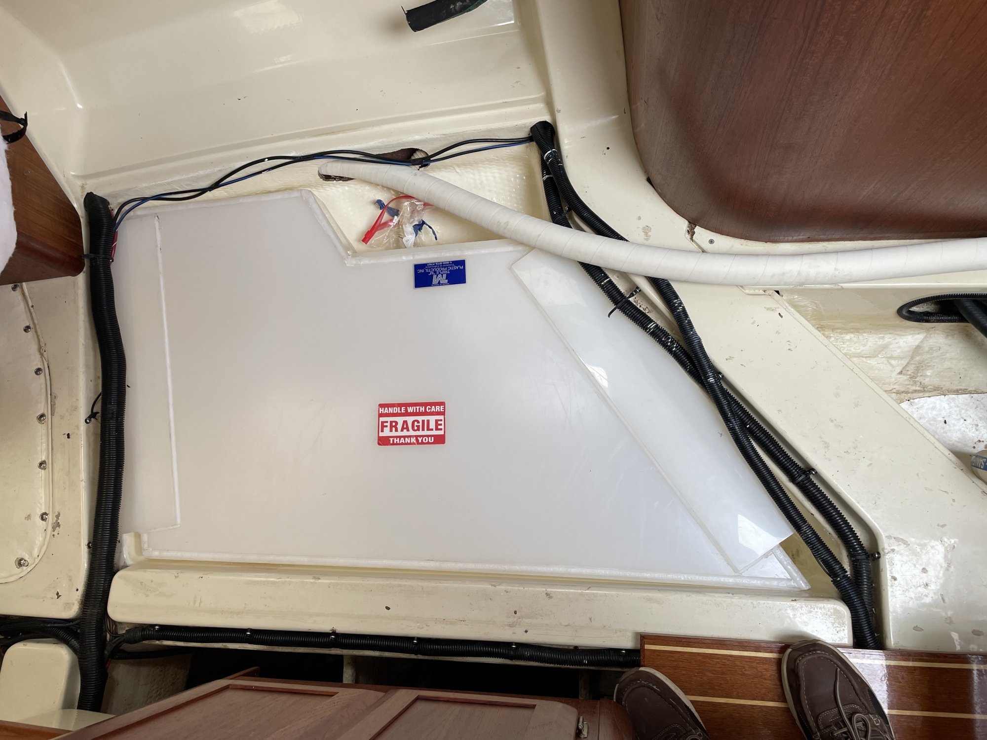

Finished my holding tank project. The tank from Triple M was not made to the proper dimensions despite them having the proper drawings and even a sample tank to follow. They said it was "difficult to make" after claiming they have made hundreds of them. Over two inches short on the longest dimension and flanges were wrong. They did not offer to remake it. Oh no we are so sorry...is that inconvenient for you? Expensive mistake. It fit in the space just ok, so I used it anyway. Would not recommend their service unless absolutely necessary. Used external SCAD tank monitor which was easy to use and calibrate. Difficult to locate Dometic hose adaptors 1.5" but Marine Sanitation and Supply had them at a reasonable price. Used Raritan Sani-Flex which ran "easily" from the bow. Both heads working well.
Positioned macerator as per Rich's suggestion. It tested well on the hard with tap water in the tank. Cleaned the water tanks, refinished all the cabin sole (like 22 parts) and reinstalled everything. Also had my hull soda blasted. Had to wait for temps and wx to get good enough to start painting. Could not get any help so did two barrier coats and two ablative in one 12 hour day as per manufacturer's time specifications. Nearly killed me.
:huh:
Feb 10, 2004
4,170
Hunter 40.5 Warwick, RI
I am very surprised that you tank was made wrong. Your mis-made tank is the first I have heard about. Even more surprising is that Triple M didn't want to make it right. I wonder if they have had a change in ownership or key personnel?
At least you able to use the tank and you have lost maybe a gallon of capacity.
