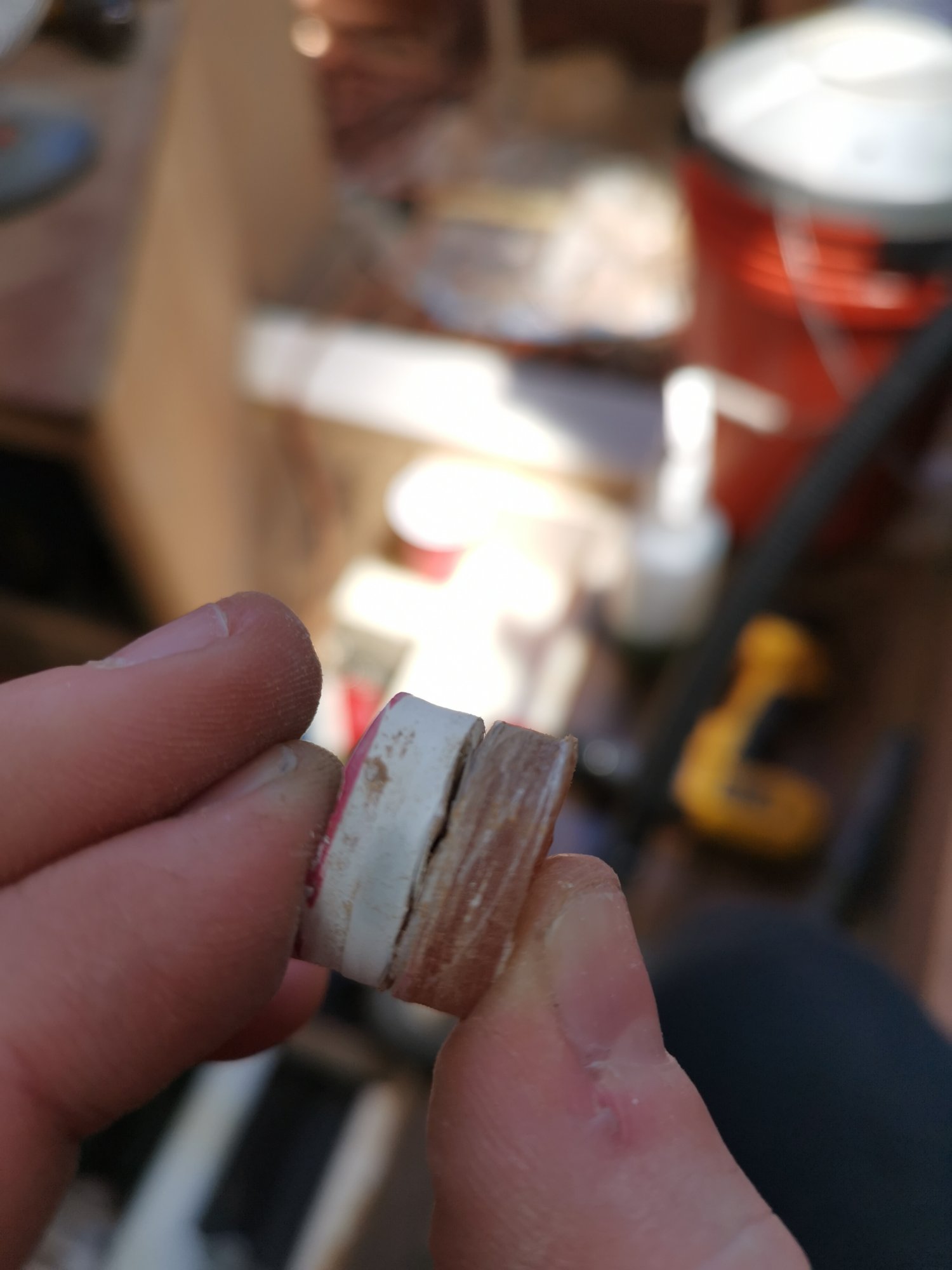

I drilled the floor of the bilge and here is what I got can some one tune in?
1,667
Hunter 34 Alameda CA
The white layer is most likely the hull liner. Is it separate from the non-pigmented piece? Did the non pigmented piece break off or cleanly separate from what is below it? Did stinky water follow that piece up when you removed it?
My thought would be that the hull liner may not have the piece of plywood under it like many of the H34's do. The liner is still a separate step in the manufacturing process where it is bonded to the hull. It should be physically separate from the hull at the bottom of the sump area.
When I drilled mine out with a larger hole saw, I took the center drill out so I would not poke down too far. It looks like in your picture, that pigmented layer is all the farther you need to go to gain access to the trapped water that fills the hull up to the next set of limber holes opening up the liner for some water once it gets really full to cascade into the sump. Notice I don't refer to it as a bilge because that is at the inner surface of the hull (under the liner).
