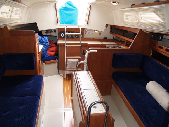

I made a binocular rack over the LONG winter and I'm wondering what might be the best faster to use to hold the rack to the fiberglass adjacent to the companionway. I'd love to bolt it in place with washers as backer plates because I believe that to be hollow but I doubt I'd get my hand inside to thread the nuts. The spot will be on the left in the photo, right above the VHF. Any advice?

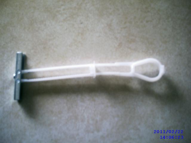

I,ve used Strap Toggles alot,If you got hollow space they work great .Big box stores carry them.Nice thing is you can remove bolt and reuse toggle.

The strap toggles are great and I thought about that. The problem with those is that you have to make such a big hole to get it in place.

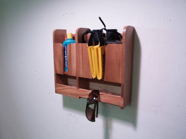

Thanks for all the input guys. I know you're all dying to know what I did. I mistakingly thought I had access underneath where the VHF radio is in the picture, but I don't, so I went ahead and drilled pilot holes and found there was gelcoat and fiberglass but no plywood. The fiberglass was thicker than I expected it to be and I got screws to bite very well. I also took Don's advice and used VHB tape along with four screws. The nice thing about the tape was that I expected the surface to be flat (it's a boat...what was I thinking?) so the rack rocked an 1/8 to 3/16 of an inch or so, so I was able to build up the tape to fill the void rather than cinch it down to conform and possibly cracking a glue joint or the wood itself. It looks great and was a nice winter project. I'll get a photo next time I'm at the boat, I forgot my camera this time around, but this photo shows the rack hanging in my studio wall.
Is that one of the SeaTeak pieces that West Marine sells? I picked up a nice towel rack for the head on clearance early this spring for $8 and couldn't be happier.
DannyS
May 27, 2004
933
Beneteau 393 Bayfield, Wi
FourPoints, no, I actually made it myself out of some scrap mahogany I had laying around.
