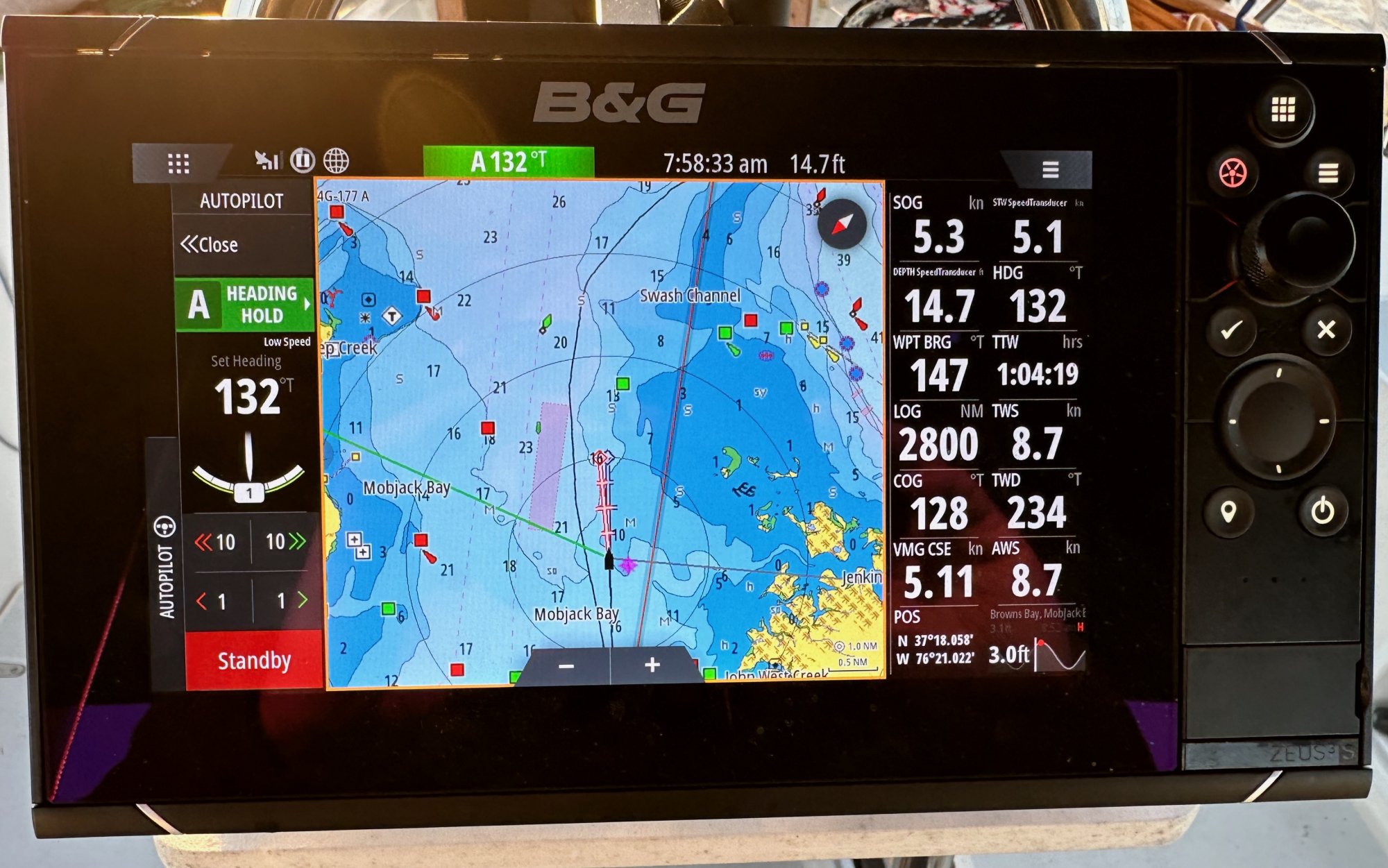

On Second Star, we have a 9" B&G Chartplotter at the helm. Two displays are on the bulkhead, one display has Speed through Water, Speed over Ground, Depth, and VMG. The other display has a graphic display of wind and current directions and wind speed data. All the data needed to sail the boat is easily visible by everyone in the cockpit and the data is available without the distraction of the fun things on the chartplotter screen.

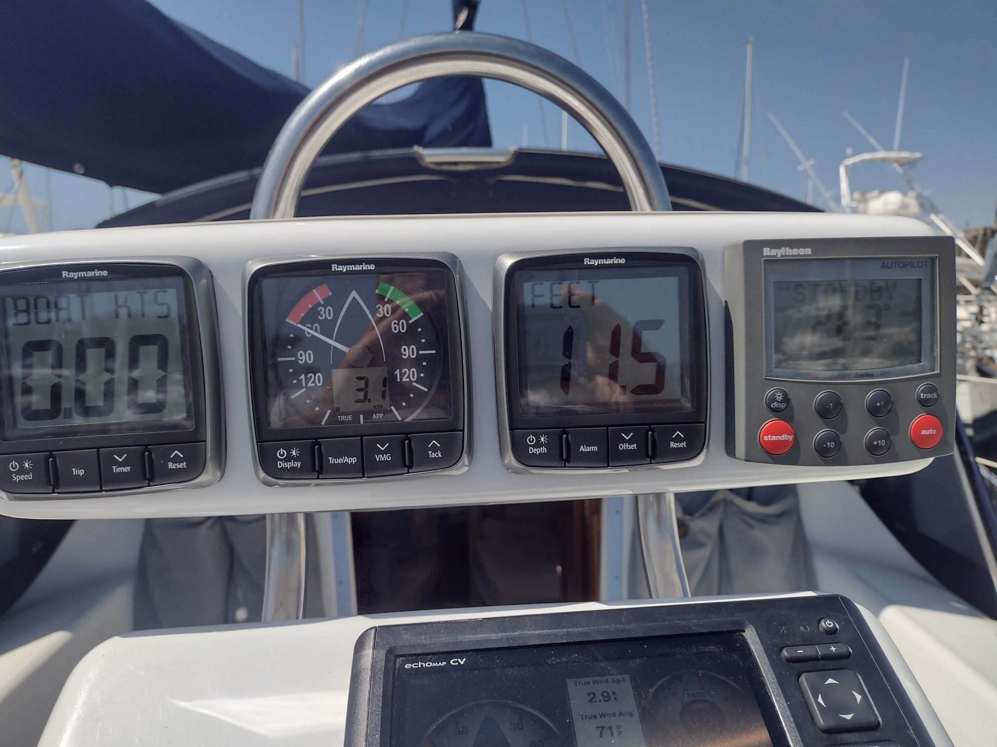

I have a 7" Garmin CP/MFD and recently replaced my older RM ST60 instruments with new I50, I60 instruments. In the attached photo you can see the wind page on the Garmin is great when standing in front of it. However, when I sit in the stern perch seat I can see the 4" speed and wind gauges easily while on AP. When I originally installed the Garmin I didn't intend to network it until I saw the wind and navigation pages available on the Garmin.

Here's our chart plotter screen when we're out cruising. There is a lot of information on the 9" screen. All of it is important for maintaining a course, however the essential information, depth, SOG, COG, and VMG are lost in the 14 data displays. Those are on a 4" display on the bulkhead.
The one drawback to bulkhead displays is, as @Davidasailor26 says, is someone blocking the display. Usually it is just my wife and I on the boat, so her spot is on the starboard side and the displays are on the port side.
