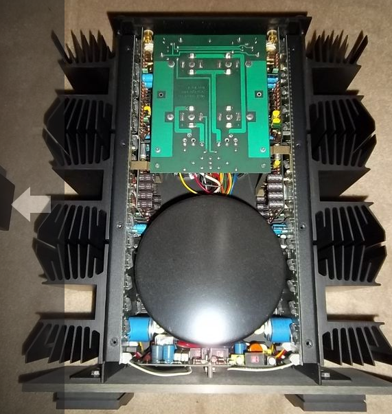

This is what a 150 watt per channel amplifier would really look like. This amplifier weighs 90 pounds and requires its own dedicated 20A outlet on AC power..

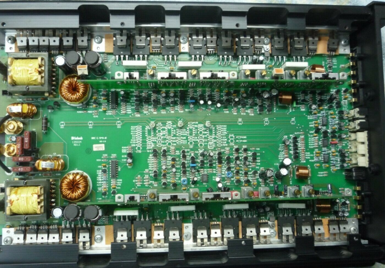

This is what a "chip amp" looks like. They are found in most car in-dash stereos. it is about the size of a quarter and weighs about the same as a dime.
Car stereo ratings are most often heavily "massaged" numbers taking one specific easy to drive frequency, at a horrible THD distortion level, and rating a split second peak to trough. They have other sneaky ways of rating them too, like the "W" does not even mean watts but 400"W" or "WOW" factor and some other bogus shenanigans. These decks are more like 4-8 listenable WPC at best at 12.3 - 12.7V and perhaps up to 9-11W at 14.6V... Car audio companies are among the most misleading of any consumer brands when it comes to marketing claims, but they get away with it because the industry is rather lax, and only a few companies want to self regulate. Some manufacturers are more legit than others but the legit manufacturers lose out by being honest in a sea full of liars.
To be fair here is a 100 WPC car amplifier (at car audio "quality"). This one only has somewhat misleading specs and rather decent sound quality. It will set you back about $2200.00... This amp is 3" Tall x 12.5" Wide x 18.4" Long. It will draw upwards of 30 - 50A DC when listening and 2.5A DC sitting there at idle doing nothing...

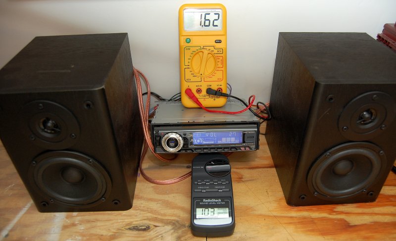

From a typical car deck, such as a Kenwood Excelon, 0.5A - 1.0A renders a very "listenable" level but we have efficient speakers, two in the cockpit and two in the salon plus a sub..
This is two channels driven into 4 Ohm nominal speakers w/92 SPL "rated" efficiency. The voltage was 12.65V. A white noise CD was used and an SPL meter. The stereo is pulling 1.62A at 103 dB. 103 dB is very loud.
If we use Ohm's law we can see: 1.62A X 12.65V = 20.49W.. This stereo was sold as 200W or 50W per channel (4 channels). Between the input and the output there are also lots of efficiency losses to account for. At a nearly cranked volume, into two channels, it can barely pull 20.5W from the bank. This is why the real power is closer to 4 - 8 WPC or 4 - 11 WPC at 14.6V....
