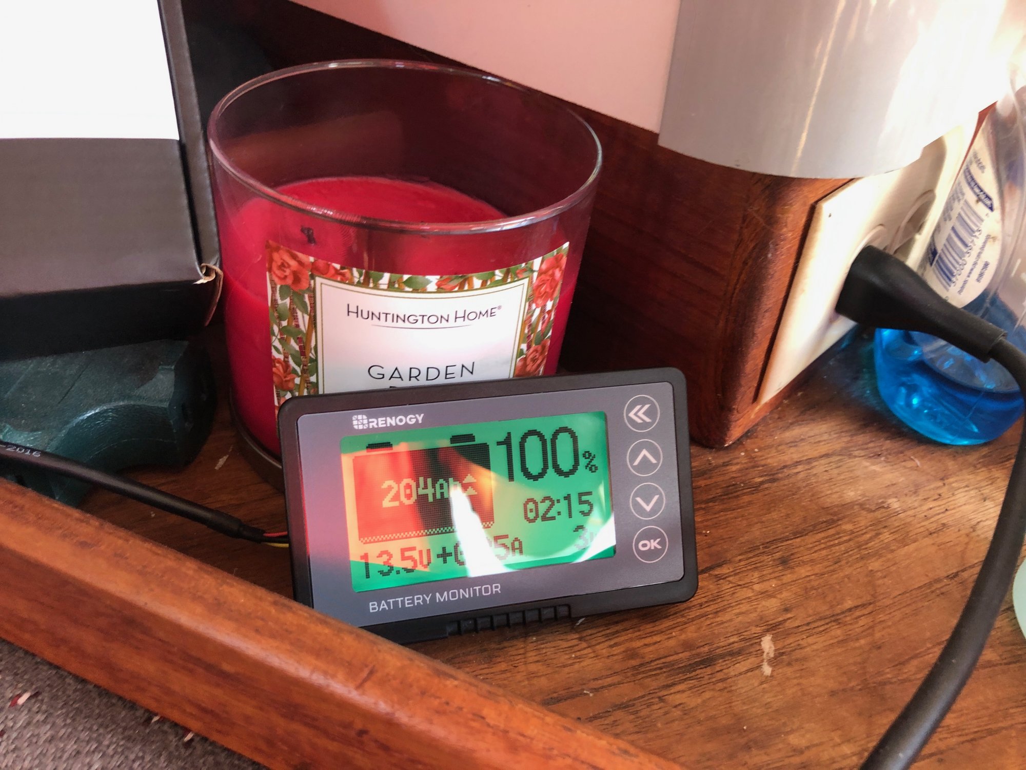

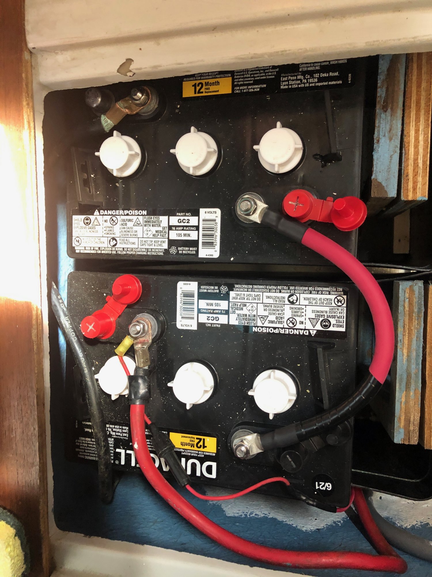

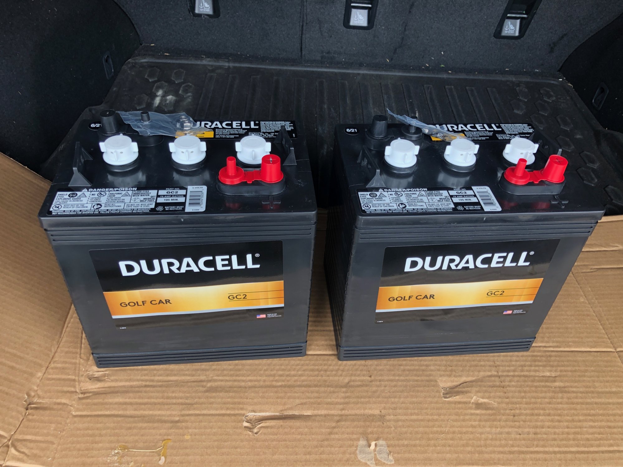

I replaced my 2 age ing group 27’s with 2) 6-volt golf cart batteries from Sam’s Club. These give me 215 Ah capacity at 12 volts.
i really like them.
I am still thinking about a start battery, but felt comfortable enough to go out on a 2-night, 3-day sail without a backup.
i installed this $80 battery monitor to keep an eye on the batteries..
Your needs are pretty light. You should be fine without a start battery, as long as you are charging up every day or 2.
I have fridge ( but did not run it on my 3-day sail). I have no solar or generator.
