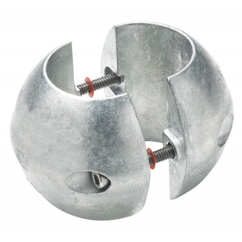

Maybe a picture of the "inside anode" would be helpful. Maybe it "is" a SS retaining collar. They do make "collar" anodes that look similar to the retaining collar. The nature of the metals surface or other markings would be a clue to which it is.
It’s definitely and anode.
It’s definitely an anode, like in this pic...
