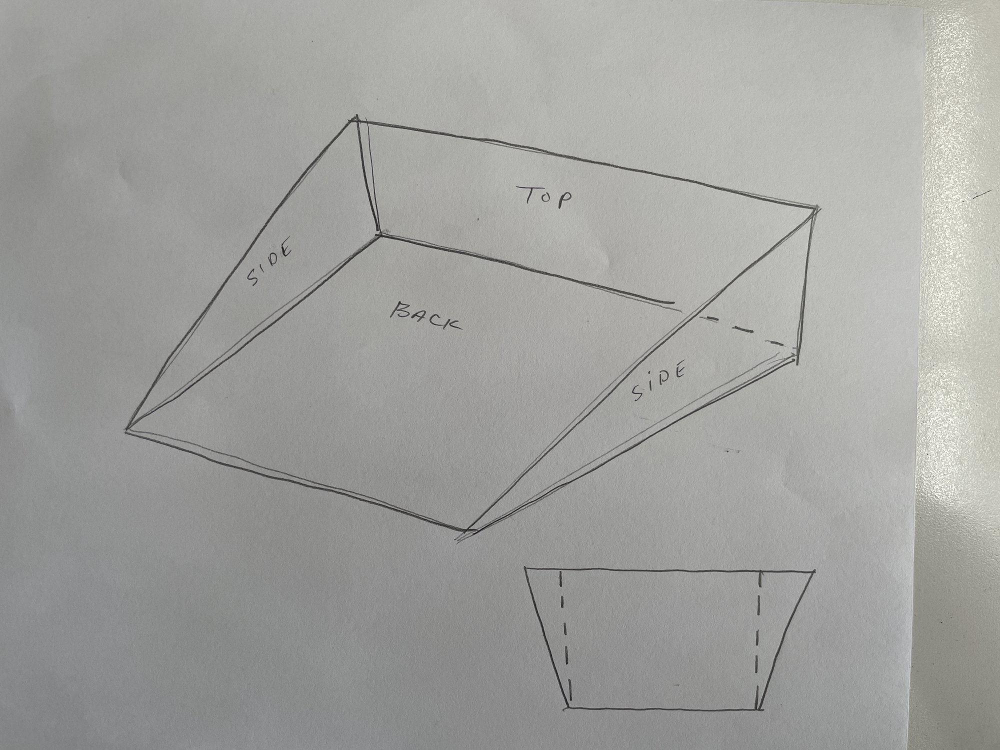

I do have a router, radial arm saw and table saw along with the skills to fabricate something like this. As I see it, there would only be four pieces, a front flange, 2 sides, and the back (which would have 2 horizontal heat bends forming a shallow bottom and a deeper top). What would you recommend for an adhesive to join the pieces together?
It depends how you make it. If you have a strip heater or can make two sharp linear bends then it would be three pieces (see drawing). A trapezoid shaped back piece, a top for it and the flange. If you cant do the heatbend then you could cut the sides as separate pieces and glue them on. In this case it would be four pieces plus the flange.
