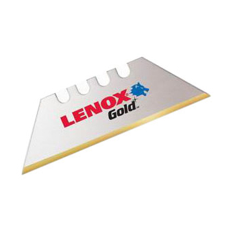

Definitely a razor utility knife for me. Make sure you have a sharp blade in your knife. I do low voltage wiring for a living, and have found that the good blades like the Lenox Gold Titanium coated last almost 4 times longer than the cheap blades. Went from changing blades 3 to 4 times a day to using a blade for more than one day between changes. And if you by the 50 pack, they don't cost that much more than the junk.
