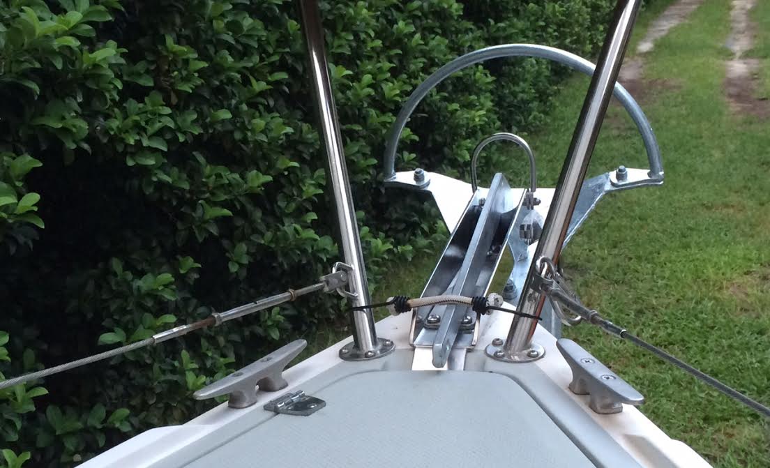

Where does your forestay attach in this pic? Also do you think there is clearance for my roller furler? I bought the CD anchor roller but never put it on as I was trying to figure out how to do it properly.
Sep 30, 2013
3,646
The forestay attaches in the same place it always does, since the original stem fitting simply mounts inside the roller. So your furler should be just fine, unless I'm missing something.
Now for the bad news. I tried to use that CD roller, but the biggest anchor it would hold was the 8lb Danforth which CD mentions in their description. Anything bigger and the flukes would dig into the hull. I couldn't even make a nine pound anchor work. I started a couple threads about this at the time, but Photobucket ate all the pics. :mad:
