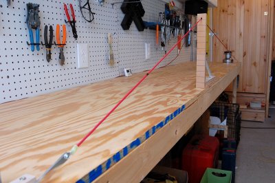

KG, this is from Maine Sail's old website --- I'm glad it's still there 'cuz he hasn't migrated everything to the new site and if some of this priceless stuff is lost it would be a real loss.
One could make the point that by essentially tilting the bottom based on the slope in your example, the trig could be easy to know the relative similarities of angles, thus translatable to "scope" in flat bottoms.
