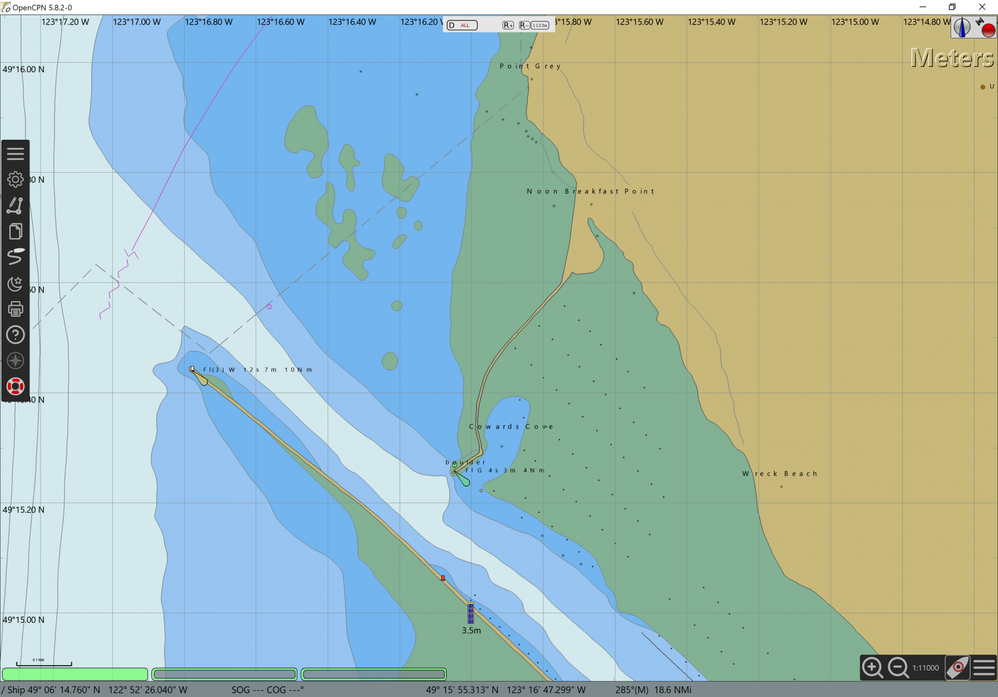

TES 246 Versus Bowser, BC
I'm thinking of anchoring overnight in Coward's Cove, at the mouth of the north arm of the Fraser River, behind the breakwater. Has anyone anchored there? What is the bottom like? (26 foot boat, retractable swing keel)

Doesn’t look very inviting unless you needed shelter from a westerly.
Apr 5, 2009
3,327
I don't know. With a shoal draft retractable keel and behind the break water, it probably wouldn't be too bad unless there was a lot of wind. I assume that your rudder will also retract so that it is not the deepest point.

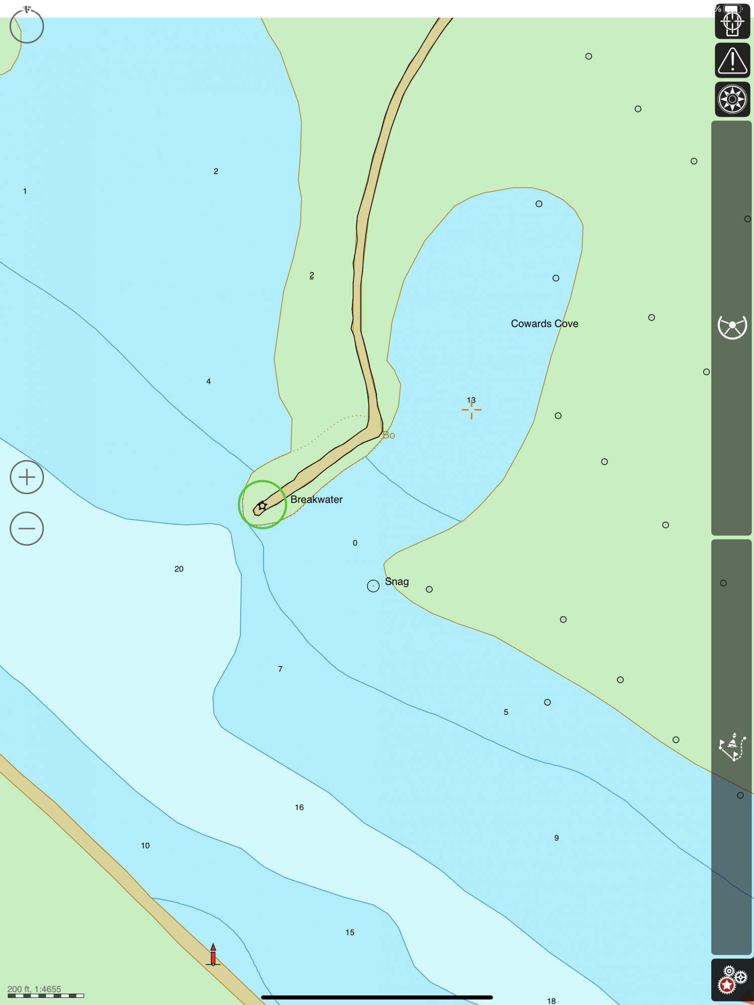

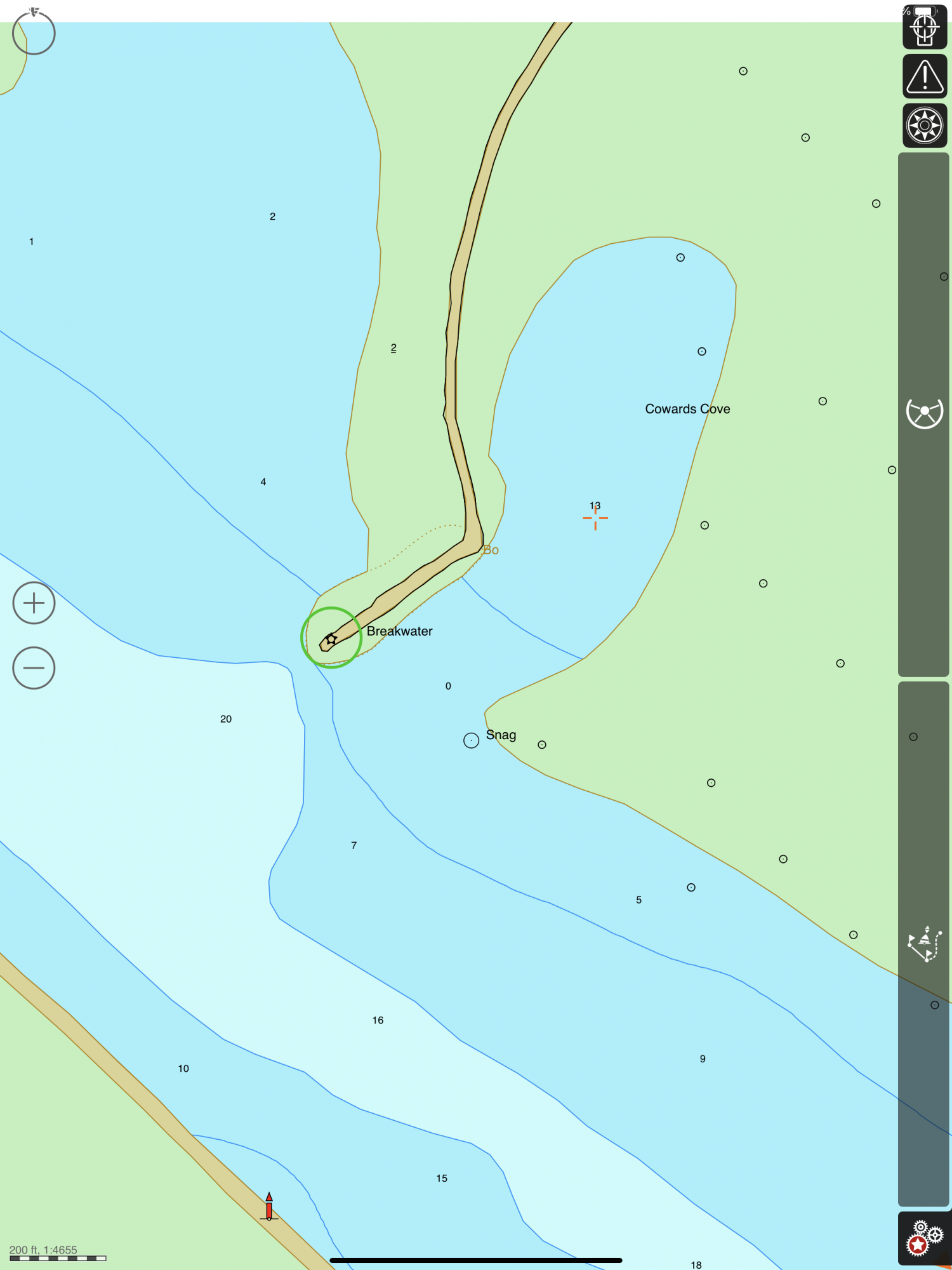

its tough to see but my second pic is of my ISailor chart and it shows “0” as the min at the opening.

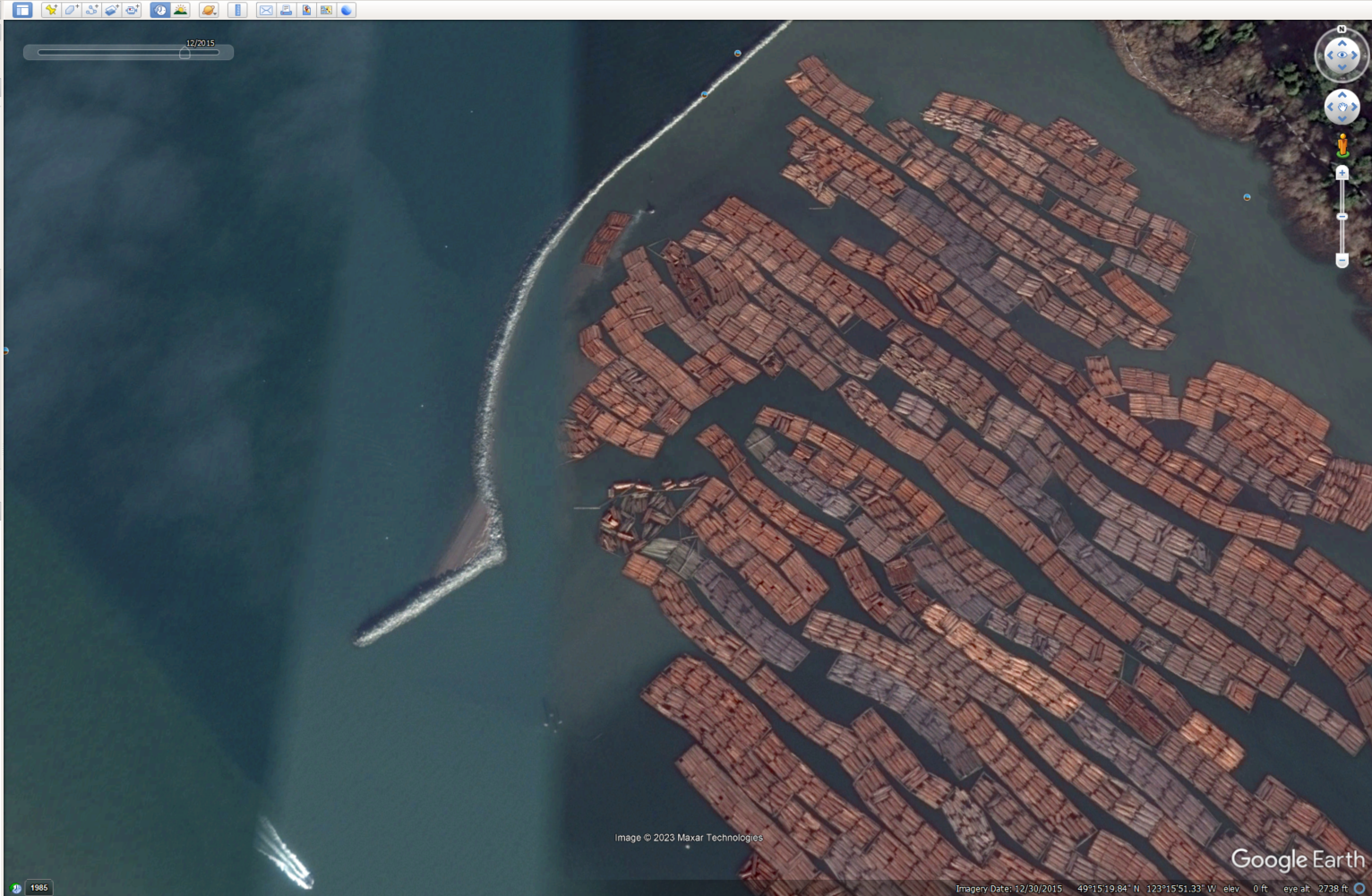

I just looked at Google Earth and think the bigger problem could be that the neighbors might get pushy.

Go to Google earth and zoom in on the cove and hit the date button on the lower left corner. they have photos from probably 50 different dates, and several show the mud flats. I find this very handy for checking out marginal areas.

Tedd with so much beautiful water to explore I wonder why Cowards Cove?
I zoomed in on the breakwater using Mapcarta satellite view and here is the image.
Not only the log rafts, but plentiful loose logs. Flotsam drifted ashore free from the log raft. Mud, glacial silt, decaying organic wood bits, work boats moving log rafts in and out of the cove.
Suspect the cove would be unpleasant as an anchorage.
A search of 2 guide books has nothing listed about Cowards Cove as an anchorage.
