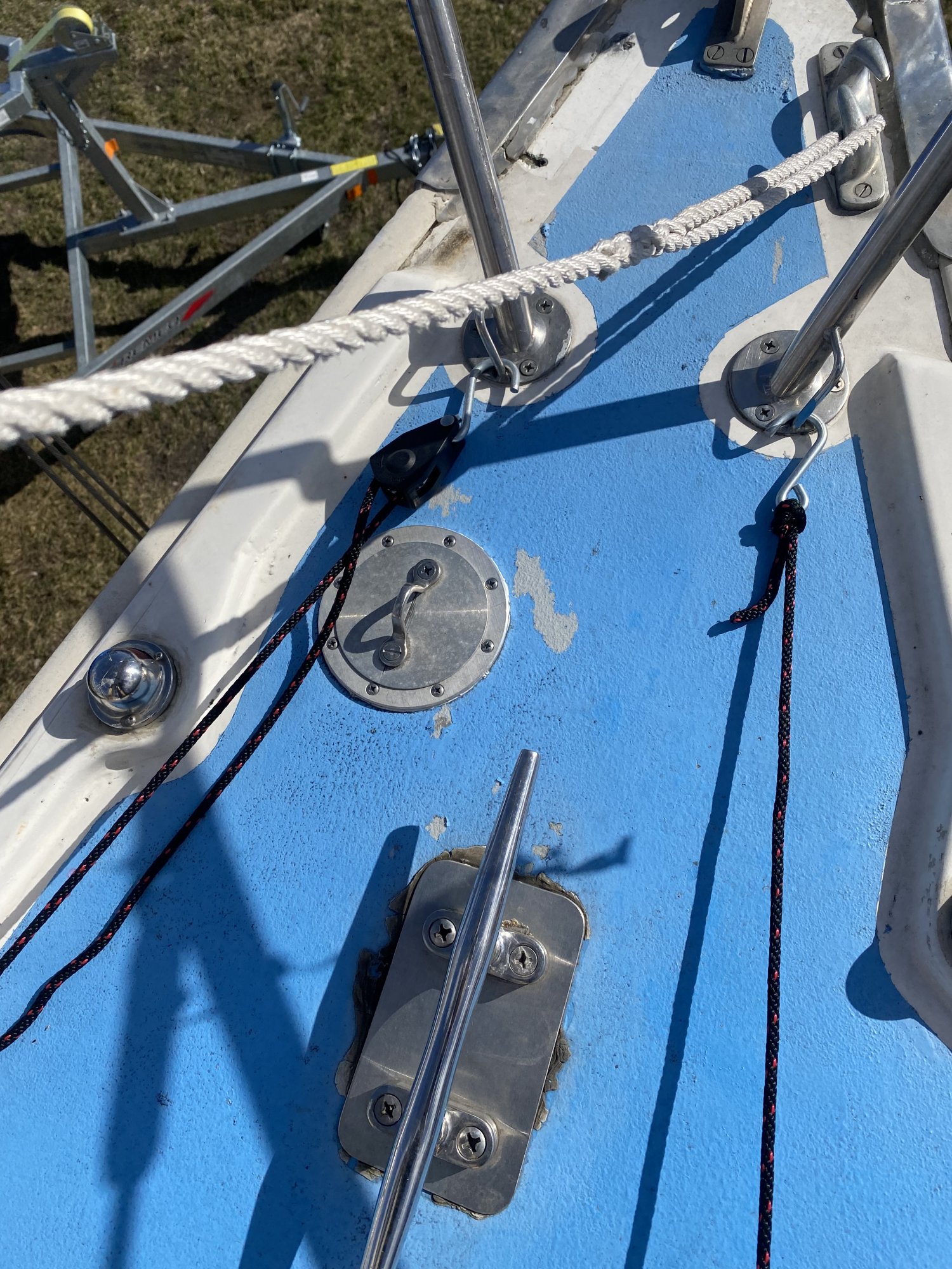

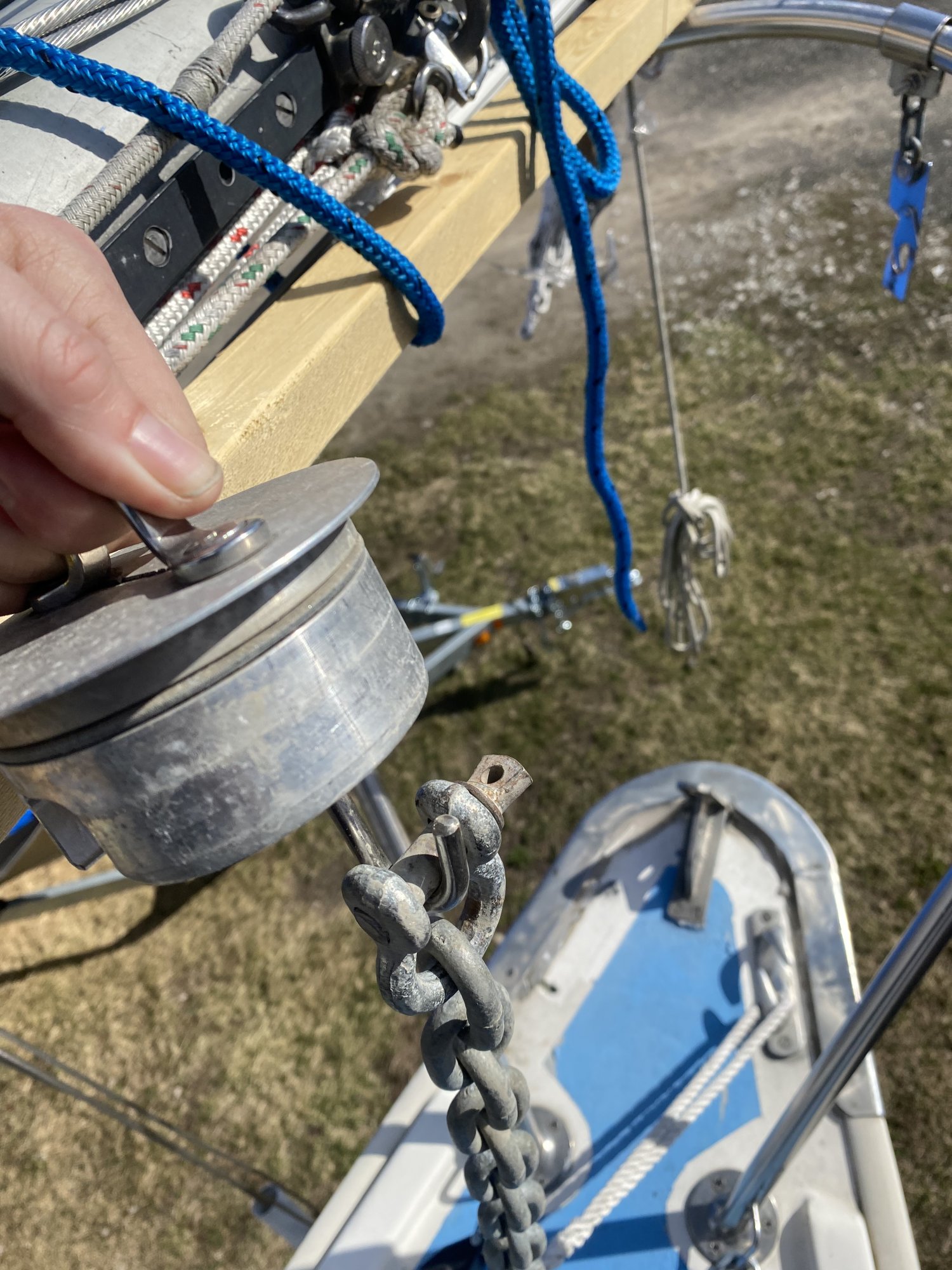

Hey everyone, still waiting to put the boat in the water, I was inspecting the foredeck and the PO’s weird system to keep the anchor chain and rode in the forepeak
The rode and chain is under the round plate and is held in place by a hook, I don’t want to have to fasten the anchor to the chain every time I beed to anchor and I don’t want to leave the hole open all season.
what would you recommend?

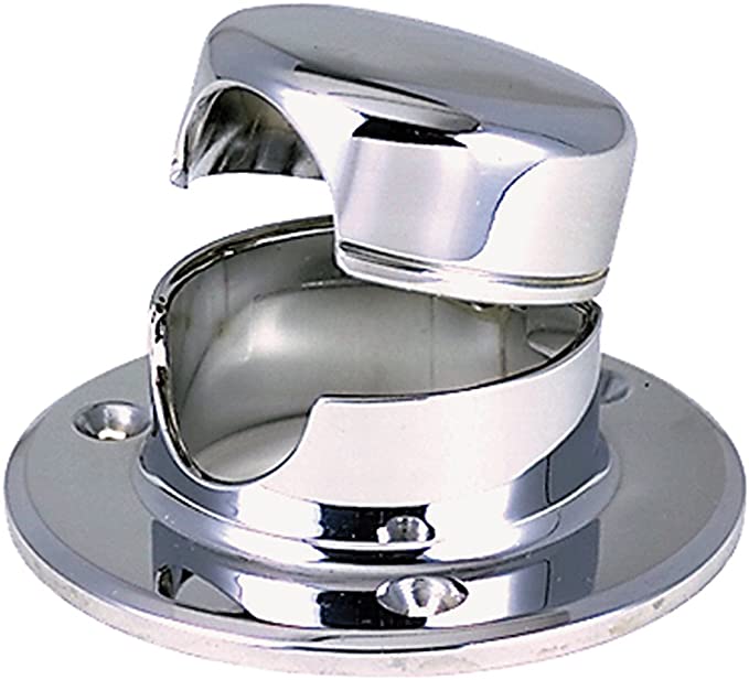

That is goofy! Is the chain locker isolated from the cabin, and does it have a drain? Could be no, and that's why he needed a weather-proof seal on the chain locker. If yes, get one of these:
$30 on Amazon.

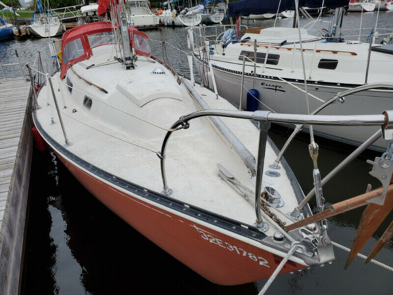

I’m guessing that the PO did not have a space for the anchor roller. Where did he store the anchor? Where will you locate the anchor roller? It may be possible if you solve that problem to set the windlass to use the pipe hole where you currently have the rode and chain.
Not a lot of available real estate on your bow deck.

The anchor rides on hangers on the pulpit, I thought of those caps, but I think the hole is too big
it drains to the bilge, not ideal I know

My C&C 27 had the cap sort of like the one JVIS posted, but with a hook to hold the chain. When racing the anchor was stored below so the spinnaker wouldn't catch on it and the chain hung on the hook. When cruising I used the pulpit hangers for the danforth anchor with the chain attached. Hanging a link of the chain from the hook, even while attached to the anchor, keeps the cover closed.
Knowing the waters that fred1diver sails, this arrangement is just fine. A bit of rain water may find its way into the chain locker but not enough to be of concern.
The alternative is just leave it as is and attach the chain each time you want to anchor.

I took a closer look at the cap and it has a recess to let the rode pass with the cap partly raised and will still prevent rain from coming in, now just have to figure if I’m going to use a shackle or a biner
