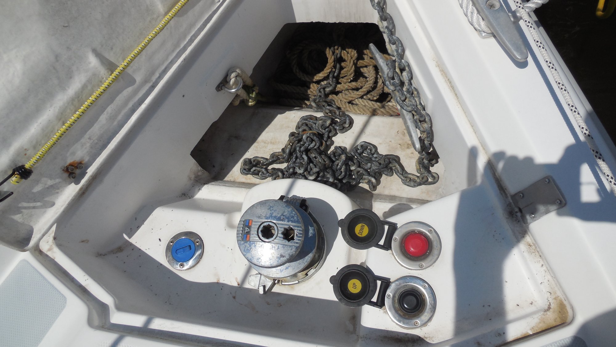

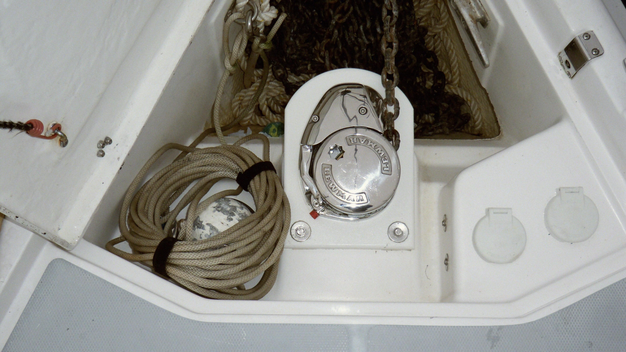

Again about my factory installed windlass. When at anchor, I never left the anchor rode on the windlass but secured it to the large cleat shown in the photo. To start the anchor retrieval process, I would wrap the rope rode around the gypsy with some of it hanging over the edge of the windlass platform. As I raised the anchor the rode and then chain leaving the gypsy would just spill over the edge of the windlass platform shelf onto the next lower shelf and then eventually down into the anchor locker. Gravity and the inertia of the moving chain had a lot to do with this and I was there, operating the windlass, to clear any problem. I had this boat for ten years and never had any problems with this operation. It was my habit not to run the windlass continuously, especially when it was under a high load. I retrieved the anchor rode in short busts, waiting for the boat to glide forward, taking some strain off the rode. I did this to partially reduce wear and strain on the windlass motor and to spare its brushes.
