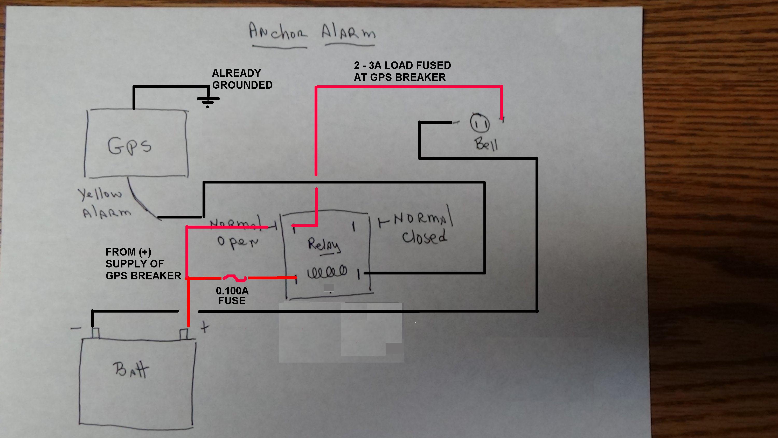

Hi Ralph, thank you for your input. In the attached schematic,
how would you hook them up?
Jan 4, 2006
6,493
Remember this is a schematic. Your power supply comes from the (+) terminal on your GPS breaker. Don't run it from the battery. Protect the GPS internal switch with a 0.100A fuse. The same wire can continue on through the normally open switch in the relay to provide (+) power to the bell. The GPS breaker will protect the new wire from an overload. Your installed GPS already has a ground in it, so don't concern yourself with it. The solenoid coil circuit is now complete.
The ground wire from the bell will go back to the (-) bus bar in your panel. And you're finished.

What your GPS does not do with that yellow wire, is put out current to the alarm, or anything else. It only acts as a switch and it's either OPEN:
and no current flows because there is nothing there to conduct the current or it's CLOSED:
and the current which YOU supplied (in your diagram) flows because there is now a conductor in between the contacts. You have to supply the current to energize the coil by installing new wiring from your GPS breaker .
For your second question, the relay common contact is on the switching side of the relay and you will attach one wire of the new alarm supply to this common contact and the other wire will go to the "normally open" contact. In this way, when the coil receives electricity, it energizes and becomes magnetic. This magnetism is what pulls the relay contacts together and allow current to flow to the alarm.
