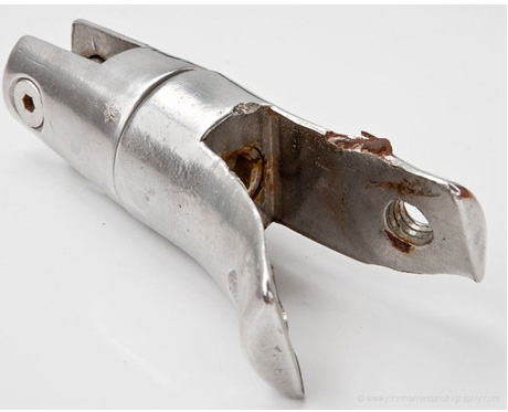

The Manson Supreme is the worst offender, mine used to come up 75% of times the wrong way.
Buy an Anchor Straitener. It is a stainless steel swivel with a cleverly angled solid piece of SS beween the the swivel and the chain which when it hits the roller forces the anchor up the correct way. I have had one for over a year and without fail the anchor always comes up the right way. It is a brilliant bit of kit. Several Chandlers sell them, try Boat Gear Direct in the UK. I think mine cost around $50 and was delivered to Australia within days.

buy An Anchor Straitener. It Is A Stainless Steel Swivel With A Cleverly Angled Solid Piece Of Ss Beween The The Swivel And The Chain Which When It Hits The Roller Forces The Anchor Up The Correct Way.
brilliant !
