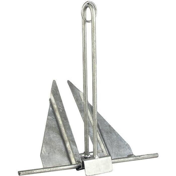

Defender has a 9# Genuine Danforth Anchor is which the size you need for $45. Not sure how much you would save on Marketplace.
The anchor you don't want looks like the photo below. They are designed for easy retrieval, the ring slides to the anchor flukes and the anchor comes out backwards. This also happens in a 180° wind shift, the anchor pulls out and won't reset. Fine for a lunch hook, but not for overnight.
Thank you. Just placed the order!!!! The ones I was looking at looked like the picture above.
