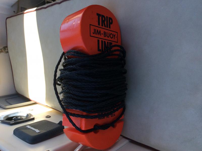

I have done an online search including YouTube and the manufacturer site but cannot find out how to use this. Can someone help me?
Gunni
Mar 16, 2010
5,937
You tie it off to the fluke-end of your anchor, many anchors have a hole for just that purpose. When you drop your anchor you toss the float and freed line with the anchor. Then if you need to unstick your anchor you can motor or dinghy to the trip line and use it to pull your anchor in-axis with the flukes, easing retrieval. It also serves to mark your anchor location in those crowded anchorages, or in cases of clodish skippers who might want to lay their anchor rode across yours. Frankly that looks like a pretty lightweight trip line. I use an old halyard.

The brief description of this particular device indicates that after the line is attached to the fluke of the anchor, the rest of the line is wound around the float, and deployed along with the anchor.
The idea is that the anchor will run to the bottom while the foamy buoy unspools its line as it heads to the surface. When it appears, you retrieve it, cleat the line off in the slot on the end of the buoy (paying out line for any expected rise in tide, I assume), and viola. Now just pay out your anchor rode and set as usual.
The tricky part seems to be retrieving it and cleating it off before you begin falling away from your deployment spot.
