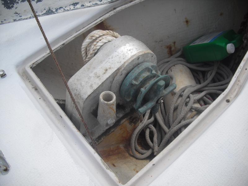

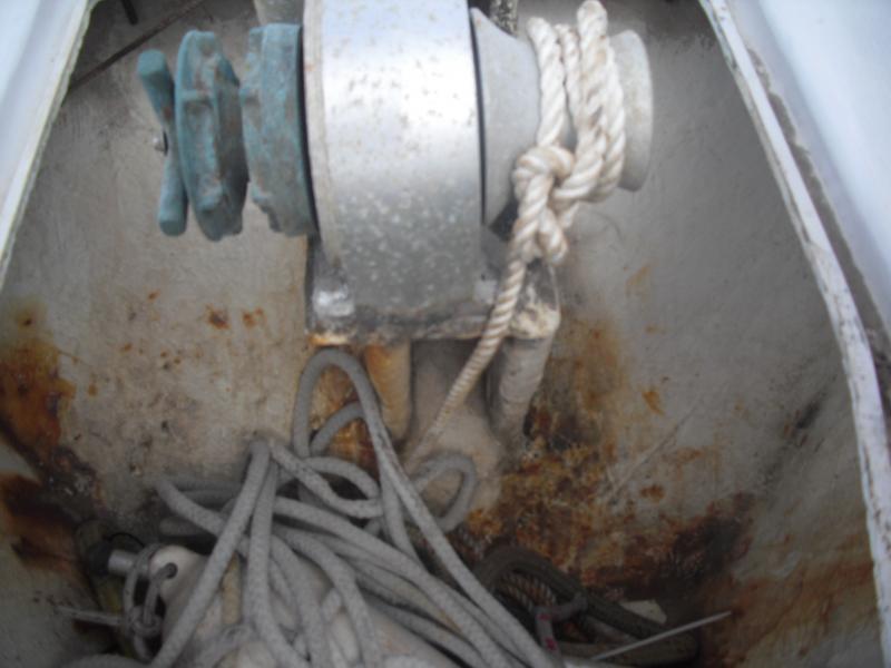

Thanks for the info, the gypsy on my horizontal windlass is for line on port and looks like 3/8" chain on starboard side gypsy, boat is a 1977 jeanneau (french), can I use 3/8" G-4 windlass chain???... REd
My Simpson-Lawrence has a specific gypsy for different chains, so if I changed from my 3/8" BBB, to 3/8" G-4 the chain dimensions change and so does the gypsy.
1,483
The gypsy on my Lewmar will only accept 3/8 G4. Can't use BBB. I'd be surprised if you could get away with switching chain types.

Anybody know which chain for an older jeanneau????REd

Is the bbb chain wider, which would also make the next link deeper into the gypsy?? Can I measure the width and length on the gypsy to determine which chain?? Red

If your existing chain properly runs the gypsy then take your dimension requirements off of your chain. If should be HT, BBB, or Proof - all different sizes. Here are size dimensions for each (make sure to add 2*chain wire thickness for outside dimensions). Compare the inside chain dimensions to your gypsy chain spacing for proper fit to the gypsy.
