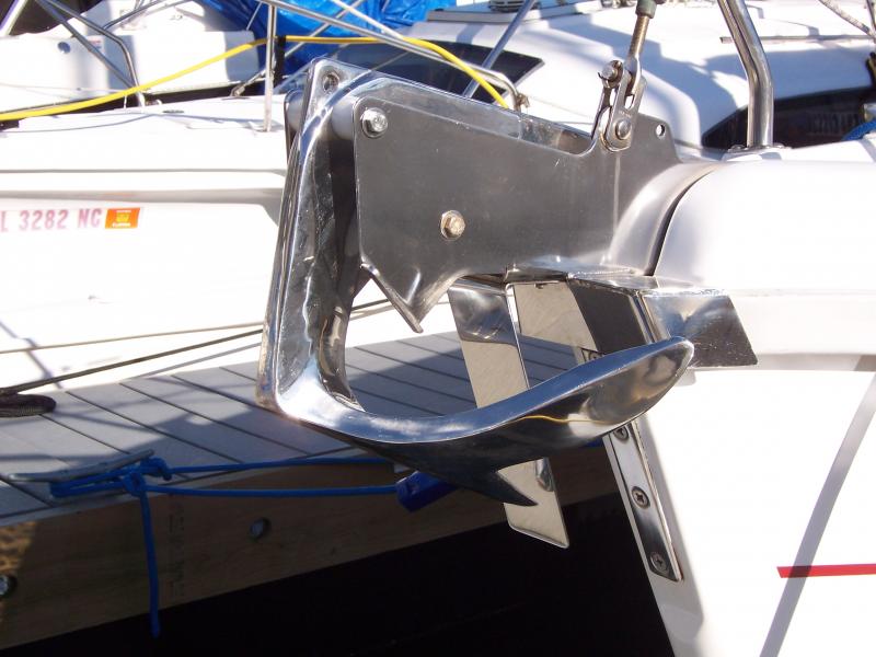

I had the same problem when I switched from my old Danforth to a claw type anchor. Installed a plate under the bow roller to deflect the anchor when being deployed.

Looks great. Do you have the manufacturer? How did you attach it?

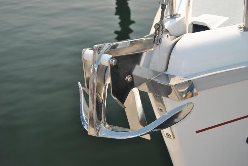

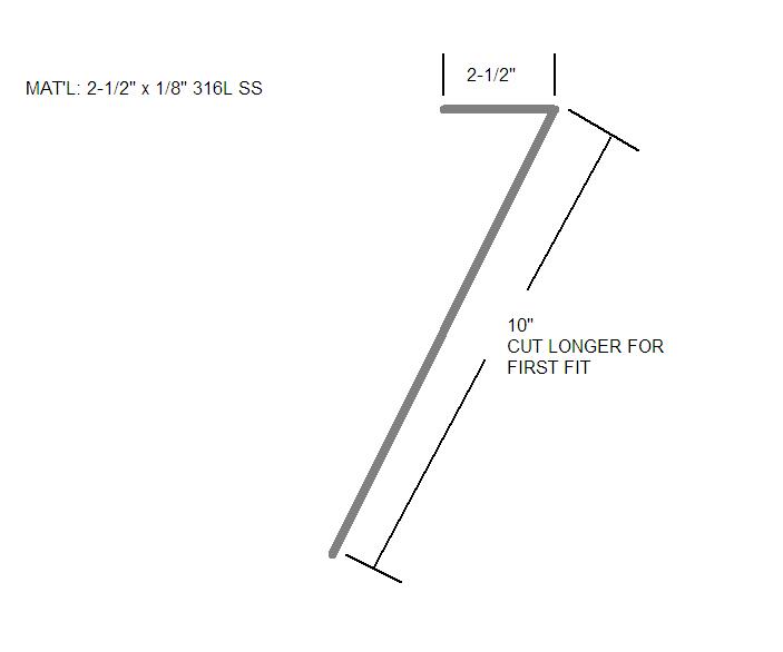

Nothing quite so fancy. The material is 316L - 2-1/2" wide X 1/8" thick. The top is hot bent over as shown hence the L in the 316 to avoid corrosion down the road. Bend to match the angle of your bow. Still shiny after five years. This photo may show it with a little more detail.
The real work was hand sanding down to #1500 grit and then polishing. It is attached under the existing bow roller with 1/8" machine screws.
