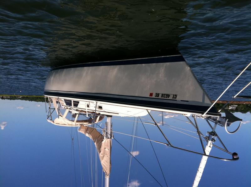

Rudy at D&R has the Red/Green Bow light, which I have mounted on my pulpit. It sits back just far enough to be protected by the rail. The plate it is mounted on is tack welded I believe.
The PO must have been worried about damage because I found two new ones in one of the compartments.
I also have deck mounted bow lights.
