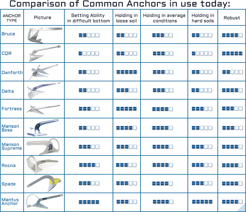

As a very general rule-of-thumb, you want 1 pound of anchor weight, and at least 1 foot of chain, for every foot of boat. That said, I have a Rocna 15 (33lbs) with 25 feet of chain for my O'day 35 (11,500 lbs). I have anchored up and down the east coast (brought my boat from RI to the west coast of FL in 2020-2021) without a problem.
I hesitate to share this (because comparative anchor discussions invariably bring out the trolls); but you may find this comparison chart that I used to share with my ASA 103 students helpful (Circa 2016). The source for this chart was an online discussion that I had with Greg Knutsen from Mantus Anchors. In my experience, I have found that the galvanizing of Mantus anchors has been lacking, thereby reducing their robust rating to less than indicated in the chart.

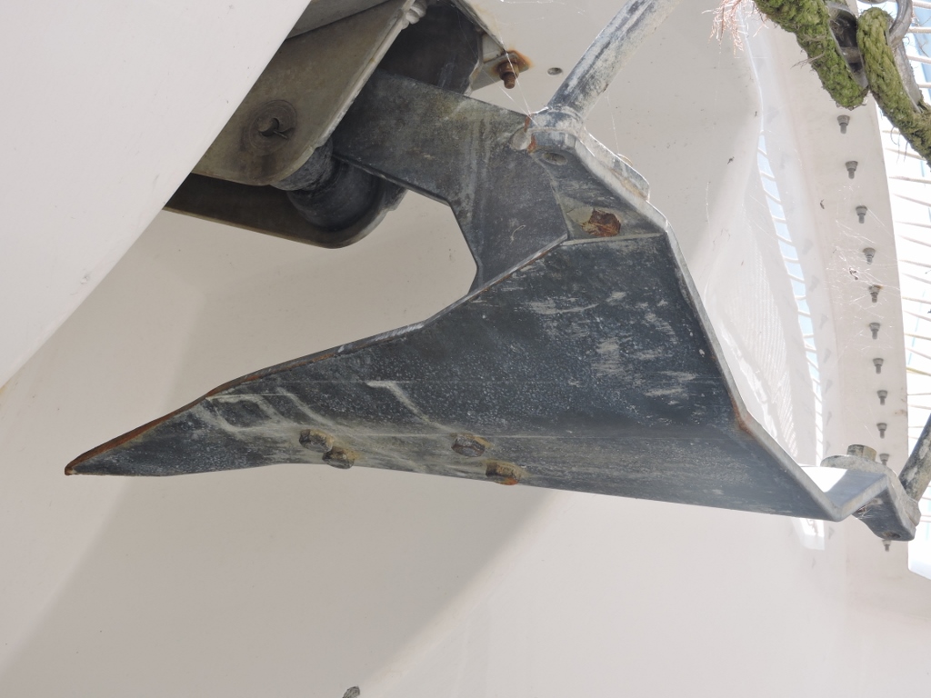

Well, I'm guessing that the chart you posted was a product of Mantus. From my considerable anchoring experience, the Rocna is by far and away the best anchor to use as one's primary anchor. Where it may not be suitable, the Fortress covers the need.
Below is a picture of a Mantus on a cat in Trinidad. The anchor appeared to be correctly sized for the boat, yet the tip was, as you can see, badly bent. A Rocna is much more heavily built and I do not ever see this happening.
Also, the Bruce, which I see so frequently, was never designed as a yacht anchor. It was designed to be a semi-permanent anchor for oil rigs and the like. Lots of folks think they are great, but I personally, would prefer that the single most important bit of safety gear on my boat, be designed for that purpose.
