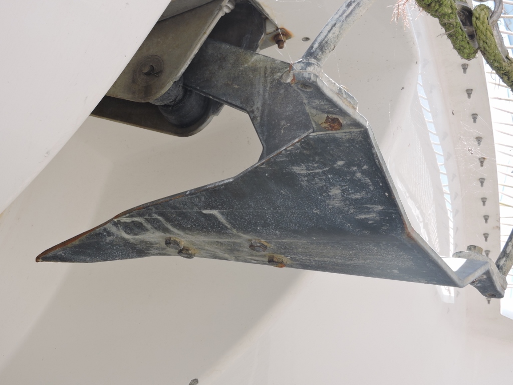

The anchor below did catch my attention enough to snap a photo. The anchor pictured seemed to be appropriately sized for the boat.
