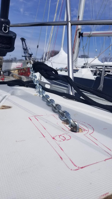

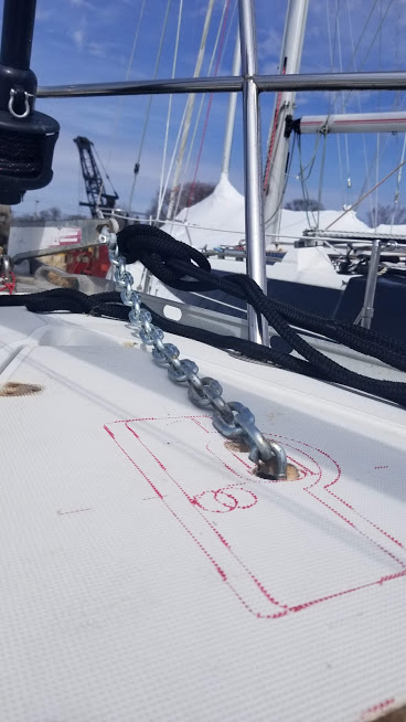

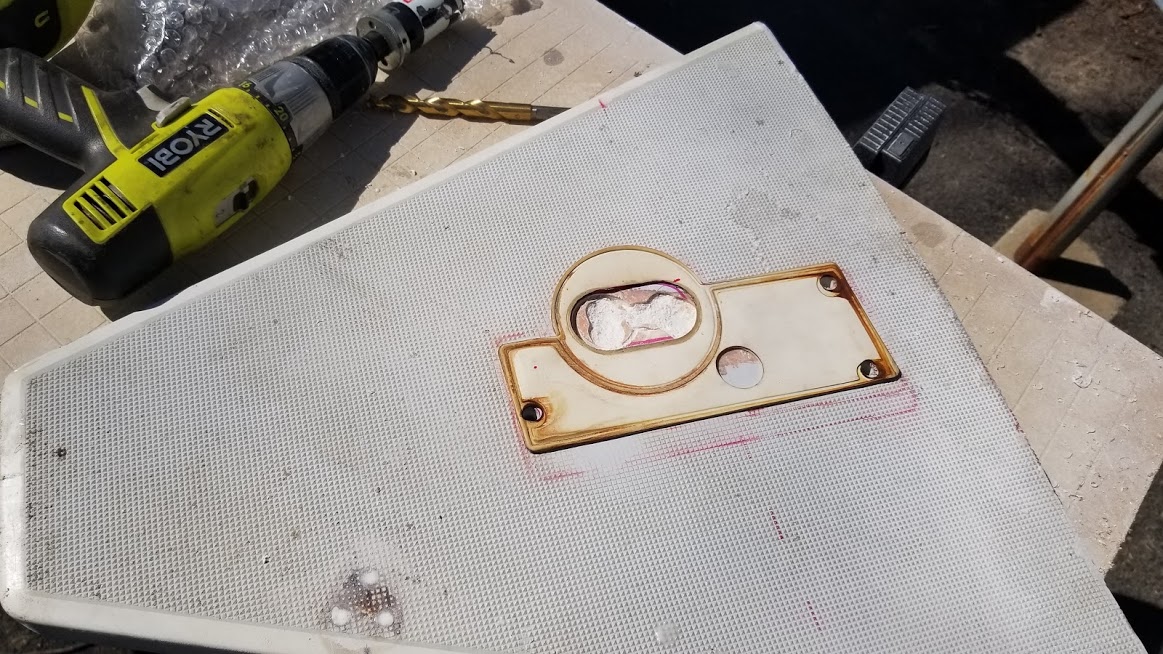

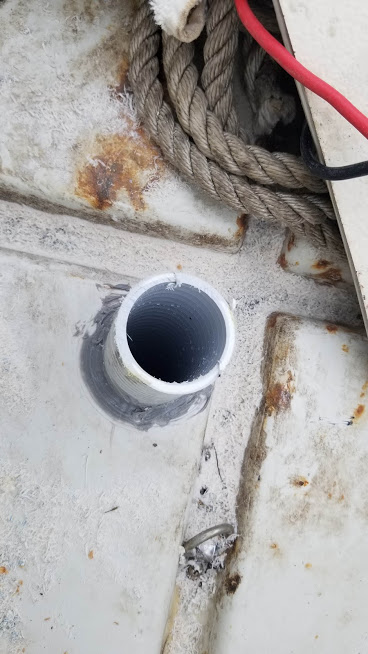

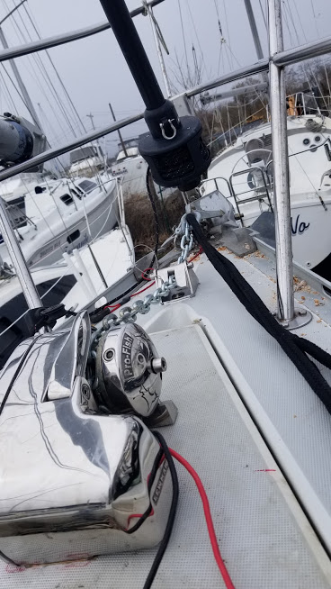

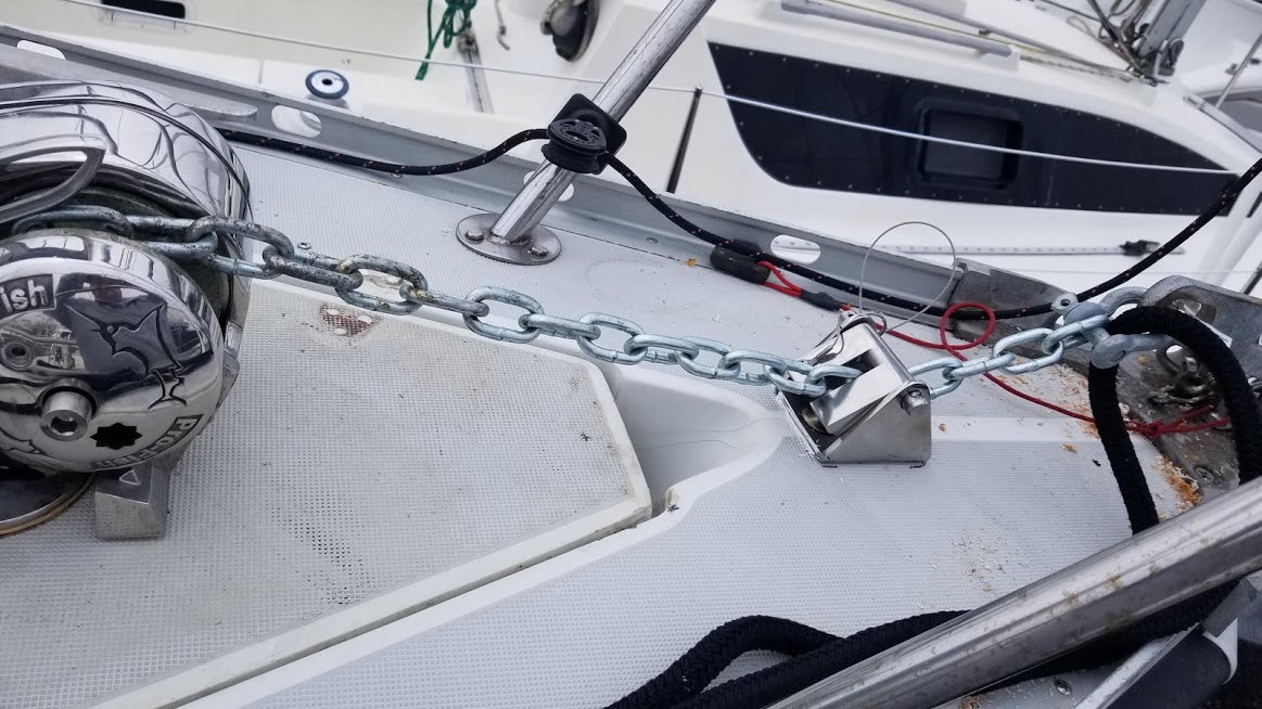

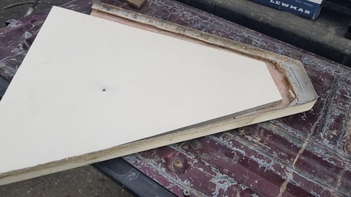

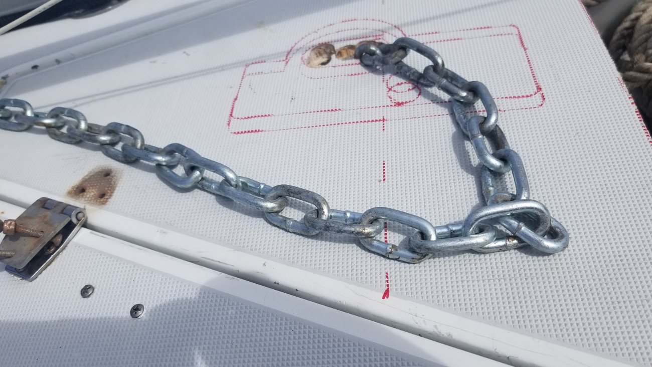

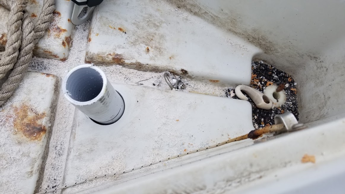

Well boys & girls, I have started to install a Lewmar Profish 700 on my ODay 322. It began with cutting the anchor locker hatch about 1/3 of the way aft, cutting out the core and replacing it with a piece of 3/8" fiberglass panel (pic1,3,4). Then locating the windlass as far aft as I could (Pic 6 & 8) installing a tube thru the existing anchor locker (Pic 11 & 12) so the chain will fall ahead of the forward bulkhead in the vee berth. I will then install another tube into the bilge for the chain to nest in the bilge under the vee berth, plenty of room. The piece of hatch with the windlass mounted will be screwed/bolted permanently in place (Pic 9& 10). The aft portion of the hatch will be reinstalled, with hinges so the area in the aft portion of the anchor ocker will continue to be usable. I have left the anchor locker drain intact so it will continue to drain as intended. I will put a rocker switch at the helm and a remote up forward (it will plug in below, able to come thru the forward hatch) for forward control. I am not in favor of putting additional holes in the deck for the foot switches. The plan is to use all chain. It nests better and will not hold moisture. I am hoping the additional weight forward will not be a problem. Stay tuned.....
Likes: Rick D
24,793
Should not be. Should allow you to add more folks and gear to the stern to so as to trim out. how much chain are you thinking of storing in your bow?

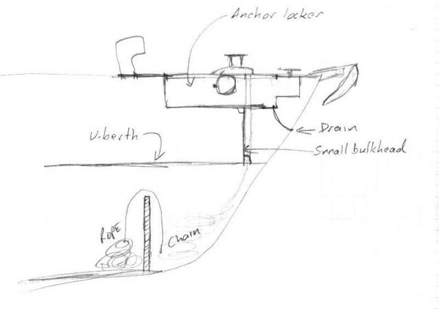

Here is a Sketch from another forum that has guided me. There was quite a bit of measuring prior to cutting. So far things have worked out, but as I said "stay tuned".....

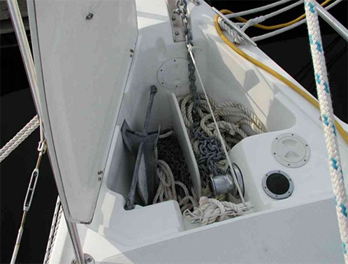

My anchor locker looks just like the one you posted, Phil. I like it. I don't have the divider, though, and store the anchor on the bow roller.

@NY BIMBO I did much the same thing but used 3/8 aluminium plate. I found that the fall from the windlass was not quite enough to trust it not to jam when raising the anchor but I can drop it without trouble from the cockpit.

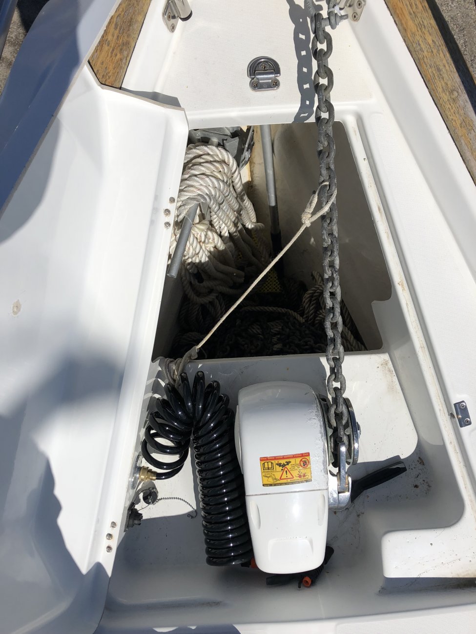

One of the features I was hoping for with my new boat was a roomy anchor locker and I must say my Beneteau 423 has a sweet one! I can easily fit in there when empty. Great placement for windlass. And a ton or room. Right now I only have 100 feet chain and 250 rode. Will be getting 250 chain and locker will ha e no issues with it. I also have room to keep my spare fortress anchor in there and typically store my spare chain and rode in there as well (50 chain 300 rode in nice bag).
Greg
24,793
Wow Greg... Room to spare. You might even have room for a crew bunk...
Maybe a crew bunk for a misbehaving crew member.
