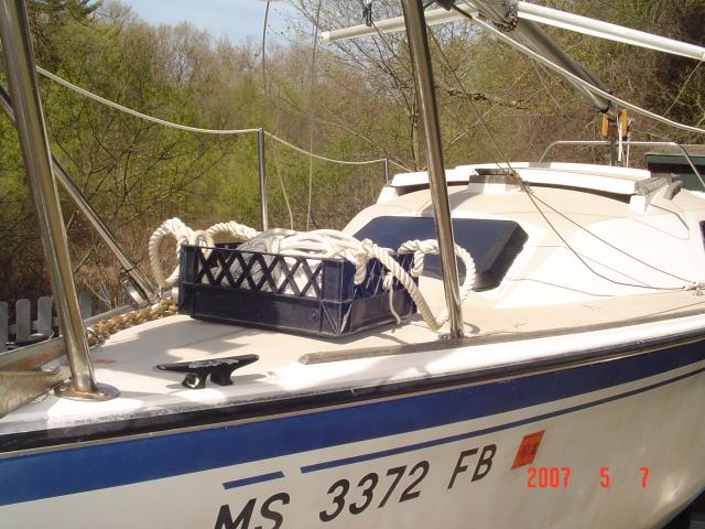

Danny,
I'm doing great! I've been getting out to the bay for the past couple of weeks, and the drawbridge is still a big PIA. I'm not too keen on feeding the anchor line through a hole in the bow. Perhaps you can install an anchor holder on your bow pulpit, and use something like a cut down milk crate or something that can be made, to hold the anchor line. Myself, I love my anchor roller. It's so fast and easy to drop or pull the anchor up with. If you just let the anchor rope drop into the crate, it always runs free the next time you need to drop the anchor. I have a BRM-2 stainless steel Bruce Anchor Roller/Mount that I bought at Worst Marine, years ago and I'm using a Fortress Aluminum Danforth Anchor that my friend Walter gave me that came off his 24' Chris Craft. You need to streamline the connections on the chain and line so that it goes over the roller without getting caught. I also use a swivel between the nylon braid line and the chain. I enjoy anchoring under sail. I just pull right up into the wind at a place where I want to anchor, and let the Main luff while I unhook the anchor chain and lower the hook. It's just that easy. When it comes time to leave, I raise the Main and pull the anchor up and sail off. To me, hanging out on the hook with my tarp over the boom at my favorite cove on a hot day is more fun than sailing around the bay with the sun beating down on you constantly. We hop into the kayak and paddle over to the island for some swimming and beach combing. It's good to hear from you Danny and maybe I'll run into you at the Spar Is. or Church Cove some day.
Smooth Sailing!
