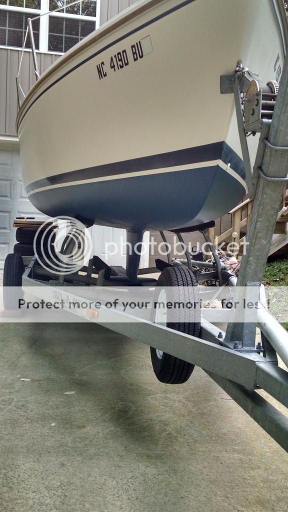

On my '89, it exits just above the water line and below the boot stripe on the port side. Is this different than others?

different than mine anyway mine exits way higher and dead center on the bow.
Yours looks like an improvement.
Yeah that's the setup I was talking about. Allen and I just have a small hole in the chine about 2" below the bow eye, with no fitting at all. I think I might retro mine like yours, and just plug my drain altogether and be done with it.
