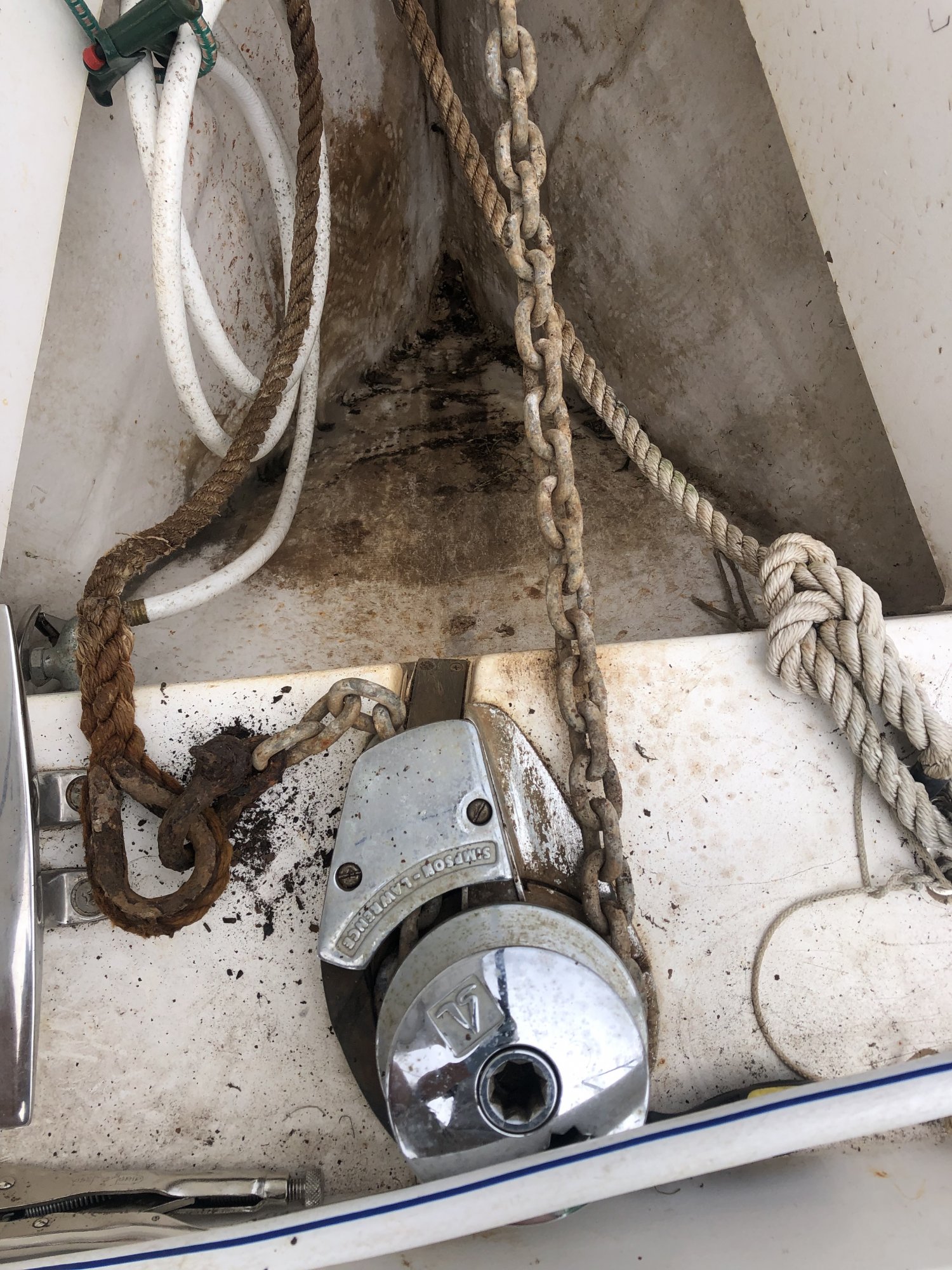

Anchor locker confusion
May 21, 2014
120
Hunter H44 Toronto
The shot below is the setup from the PO. I’ve no idea why the rode is attached to the chain like this. Obviously can’t go thru the windlass. Any ideas before I cut it off and splice? Thanks

On my similar setup I removed the cover that is stamped "Simpson Lawrence" so I could easily wrap the rope rode around the windlass. That cover is only useful with an all chain rode, if at all.

Even if it did go through the windlass, would you trust it as is? Looks well past time for replacement.

Remove the shackle and the thimble from the rope rode. Splice the rode to the last chain link. The articles above or youtube videos are good resources for the splice. The splice will go through the windlass without having to remove the "Simpson-Lawrence" cover. It does look like time for a new rode though.....that one looks very degraded.
Also, the gypsy will retrieve the rope rode as well as the chain. You don't have to wrap the rope around the capstan (the part that looks like a winch drum) to retrieve the anchor.
