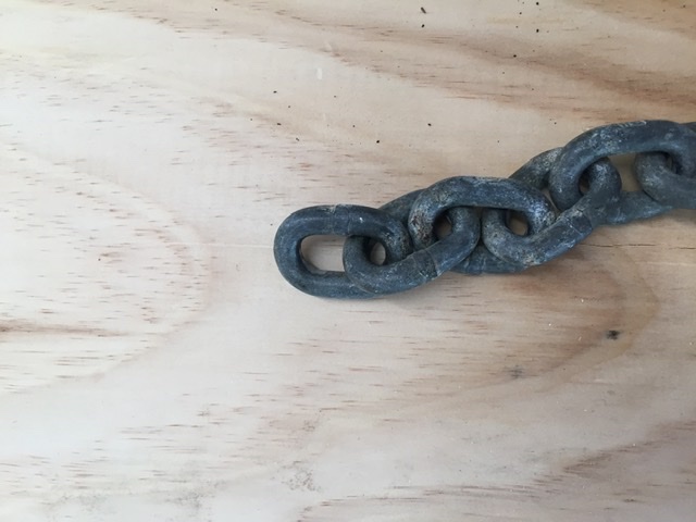

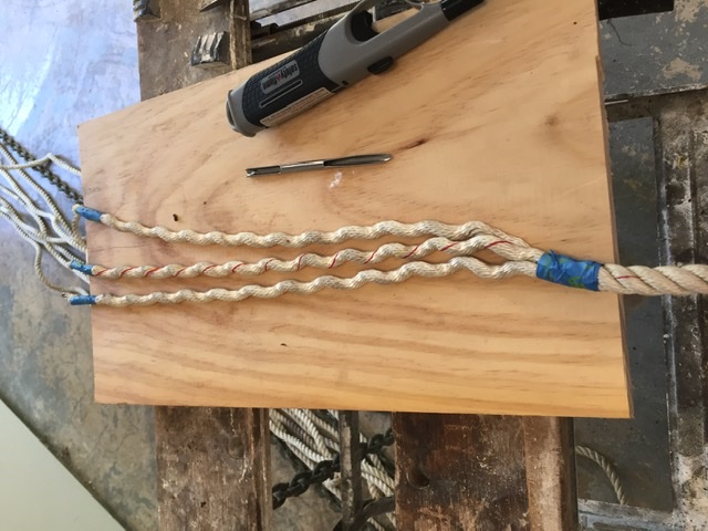

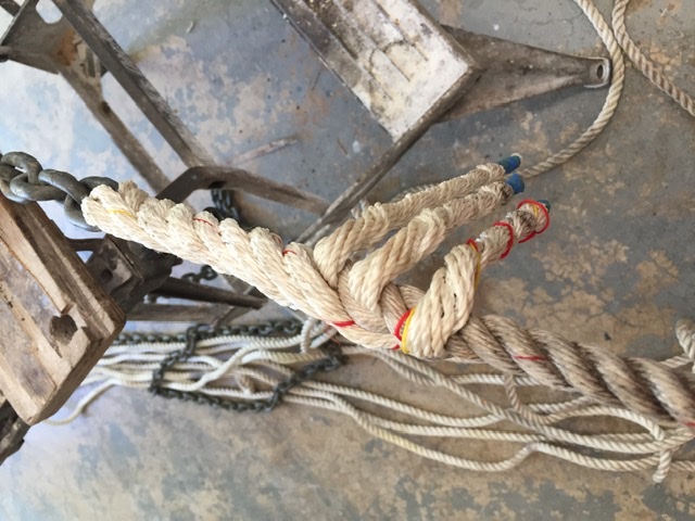

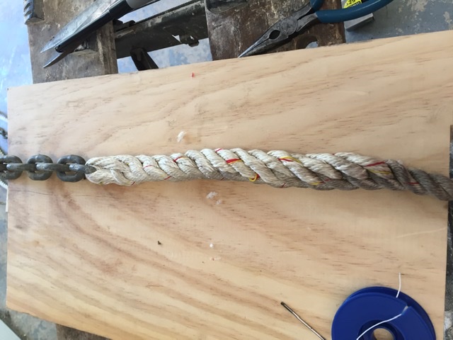

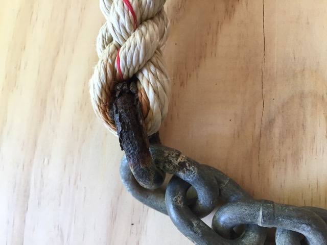

The chain link that the anchor line was spliced to corroded under the nylon. I am not sure what caused the corrosion but was an opportunity to learn a new skill. I was able to remove the offending link and resplice the line. Not perfect, but I will do better next time. I can’t remember how we learned new things before YouTube anymore. pictures attached.

Wow! Nice job. It's not easy to splice of old line. You might want to evaluate how old that nylon is, by the way, it has a fininte lifetime. But, the "fresh" part where you spliced it looks good. Another area for the rest of us to check for maintenance, for sure, that last link.
Thanks for sharing.

Thanks. It is probably pretty old nylon. Still looks good apart from being discolored in spots. I appreciate the advice. I can practice the splice with new line.

Thing is you need the additional tucks to taper the splice to enable it to run smoothly thru the windlass gypsy.
Not as many as shown. ;) On three strand, I would cut one strand after 4 tucks, another after 5th tucks on the remaining two strands, and then cut the third strand after a 6th tuck.
