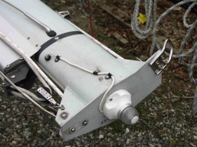

Installed a new Hella anchor (LED) light Sunday up at the yard. Previous PO had no anchor light. I pulled out a coaxial cable and cell antenna that I would never use and attached my power feed.Should have used the paperclip idea... as the two wires seperated just as they came out the mast base. The gods were with me on this one!I used the existing holes (didn't want to drill any more) to secure the wire (previously used for the cell bracket) and had to drill and tap 3 holes on masthead
