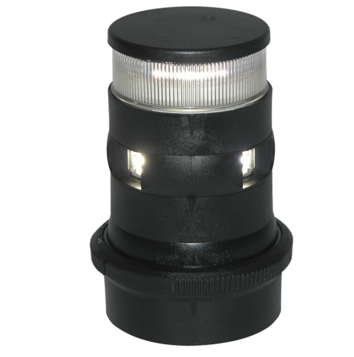

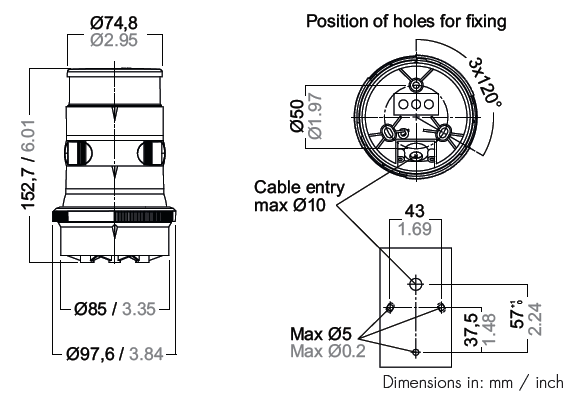

@sailor420 If that light has been atop your mast for 19years, you may find the plastic is brittle, and very cloudy. When you try to disassemble the lens it may crack in your hand. You will need to identify the light fixture (perhaps from image) to better understand how to get the bulb out. May need to contact AquaSignal
For example the Series 34 Masthead
Side-mount, pre-wired with 140 mm cable 2 x 0.30 mm2 / AWG 22, 2-hole mounting. Masthead, Masthead / Anchor, Tricolor and Tricolor / Anchor are with quickfits system, deck-mount
