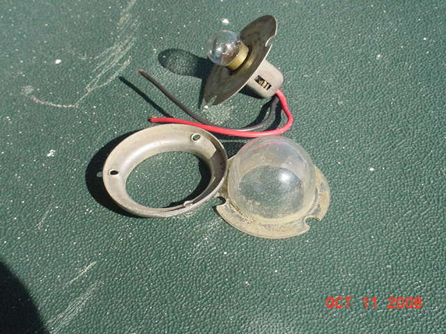

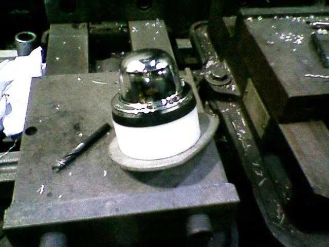

Thanks for the reply, but that doesn't really seem like the setup on my boat. I will take a look later when I get home, but I really think that mine looks more like the picture below.
I was expecting the bulb to be one of these types, but I guess I might be wrong.

Hey tommays - that's not an anchor light!!!!
From the picture posted it looks more like a stern light. An anchor light must be 360 degree visibility (distance viewable depends on boat size)

Jon - it looks like mine
I have a 1980 27'. I'm guessing mine is original and has held up well. If memory serves it's an aqua signal series 25. I can't remember if the bulb is the festoon with the dimples or the pointed end. Best to check the aqua signal web site to get the correct part number.

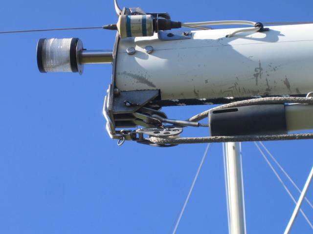

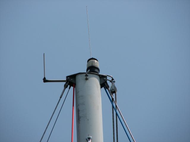

Here is the light, looks pretty close to the series 25 to me I guess... Also, in the picture, you can see there is no wind vane. Will a Windex 15 or something like that just screw into where the post is from the old one?
Also, look at that block for the spinnaker, I think that it's probably shot, can you just replace the wheel or should you/must you replace the whole thing?
It looks to me that it is a direct replacement with a Windex unit.

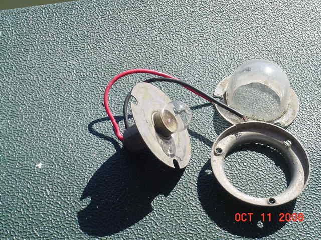

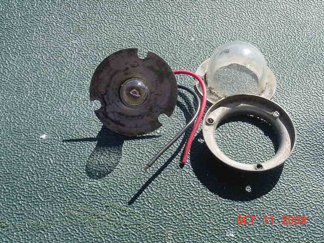

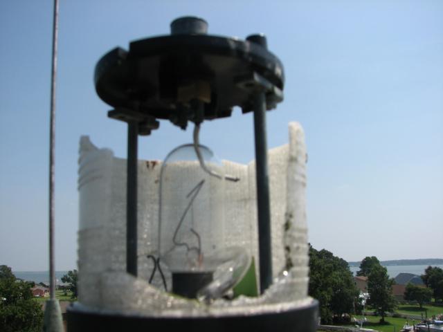

Well, we could have picked a cooler day to do it, but since she was willing, I wasn't gonna let the opportunity pass. So my wife went up the mast, a first for either of us. We had bought a windex to install and figured she'd install that and take a look at the anchor light as it looked a little odd in the pictures from the ground. Well, we'll be replacing the whole anchor light housing and all as it is completely shot as you can see in the attached pictures. All in all though, it was a sucess to test going up the mast and to install the wind vane. I gotta give my wife big time credit because I can think that there would be plenty of wives that would think their husbands were on crack to think they would send the wives up top. Astrid was actually pretty excited to go up and I was very safety conscious. We'll be replacing the anchor light completely next time as well as the block for the spinnaker I think.
