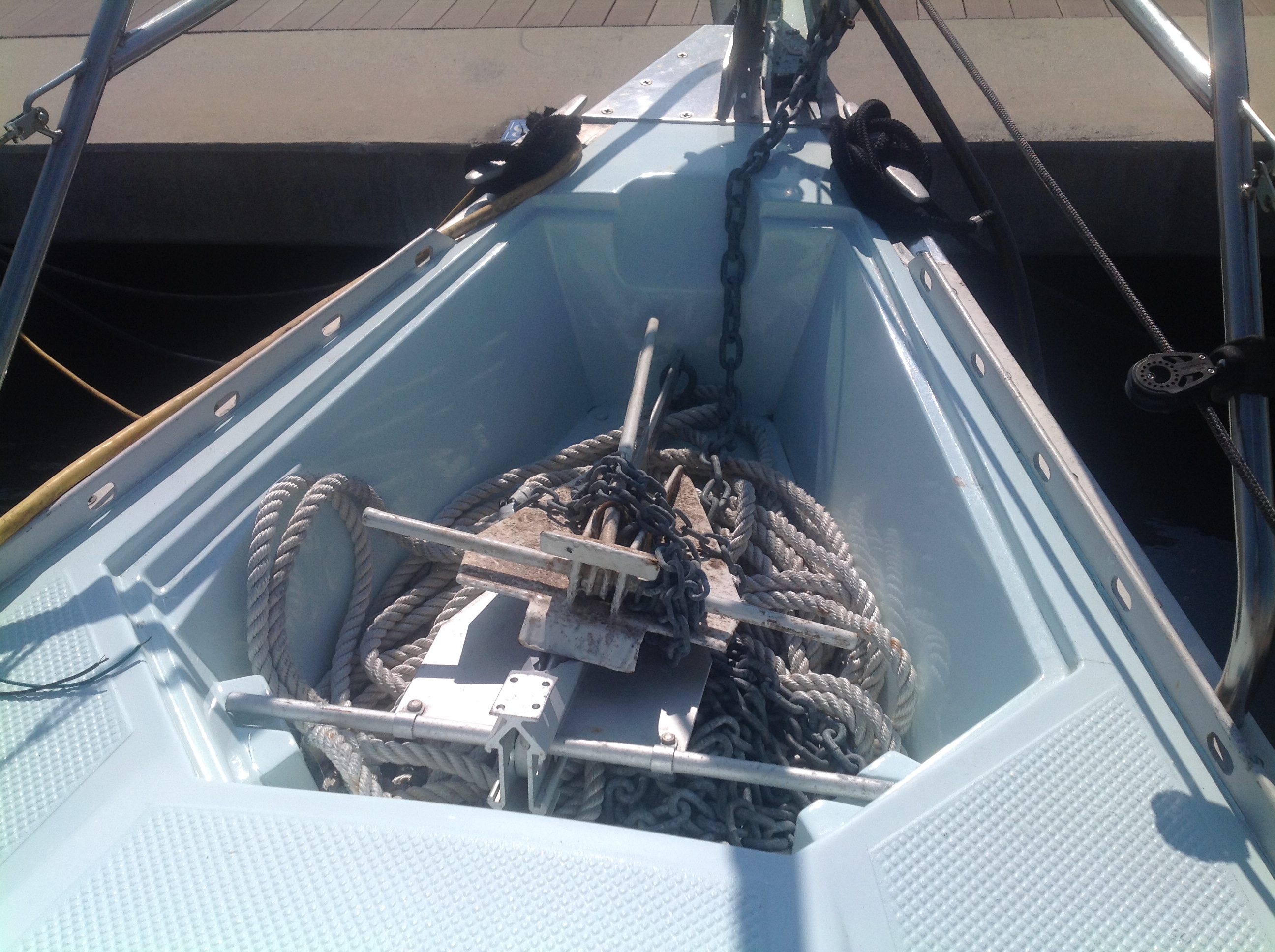

During Huricane Matthew lost Anchor Hatch from my 1984 Hunter 31' Where can I get a copy of the engeneering Drawing so I can have Hatch made, OR...anyone have any ideas how I replace it. Thanks....

I don't see any holes for the latch or for hinges (mine is hinged on the port side), so when you replace it, you might want to attach it to the boat.

Just had Boat painted, hinges and lock were not installed....Something hit anchor during storm causing Anchor to fall, suspect chain caused hatch to open and wind caught it.

Tough luck on that sorry to hear about that. Failing finding anything through salvage or Hunter. You may be able to make some thing from wood then glass it over. I have no idea if that piece would float or sink, but it may be worth looking/asking around your area if it has washed up anywhere.

If you make one from scratch, you may want to consider coring it with closed cell structural foam. When we bought the boat, we found ours had softened from water intrusion. I removed it, ground the bottom side off, removed the rotted balsa, and cut and shaped a layer of foam. I then sliced the foam like it was a loaf of bread into thin strips to help it conform to the top of the hatch. I glued all the pieces in with thickened epoxy, then reglassed the bottom. A herd of elephants can now dance on the hatch, and I don't have to worry about water intrusion anymore. I suspect it will not float.
