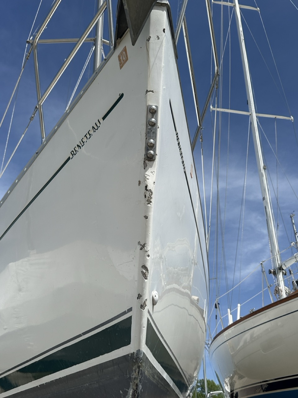

Sustained some anchor damage last summer to the bow (picture attached). Looking for advice on how to fix this.
I got an official quote from the marina I store the boat at and it was $4400. Thats not in the budget so I will have to embark on this myself. Luckily I have a friend who has done this work before and can help.
Here is the work the marina quoted:
- Repair with fiberglass and polyester resin
- Fair in polyester filler
- Sand smooth and apply gelcoat tinted to Beneteau white - RAL 9016
- When cured - sand and polish.
A neighboring guy in the yard suggested using a filler (epoxy repair kits) then coating with color matched gelcoat.
What do you think?
