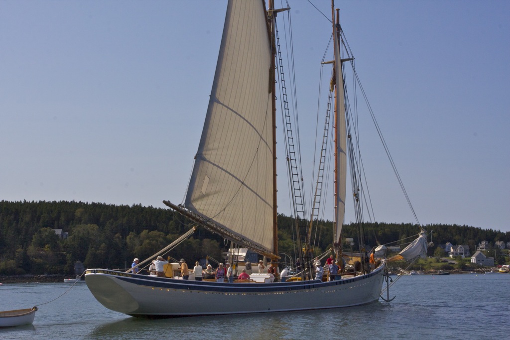

Our coast is full of schooners now in the charter trade. Many are over a hundred years old. A century ago these same boats were engaged in trade around the world. Docks were few in ports. These boats and the crews lives depended on them staying put on anchor. They learned how to (or didn't and were lost).
It's a joy to watch these old boats anchor for the night. It's a hand-labor intensive move. The plan is laid long before they reach their anchorage; locations weather forecast, dinner for the 'dudes', the sunset, other boats, etc etc, and finally, their anchor and how it performs in different bottom.
They set those anchors under sail (most of the schooners are un-powered). They still have the old fisherman anchors from the era the boats were built. Not the best available today but still a good all around anchor, if you know what you're doing.
The captain of the schooner American Eagle, rode this southerly into Burnt Coat Harbor off Swan's Island several years ago. We (under power) came in behind. They laid the big fisherman on the bottom running downwind and let the anchor set and bring the bow into the wind. Looked simple but another Fisherman is ready to run(this schooner I believe is powered but if so, the engine was not running).
We anchored alongside satisfied with the weather forecast (and the set of our anchor), for a good nights sleep. Another old schooner sailed in later.

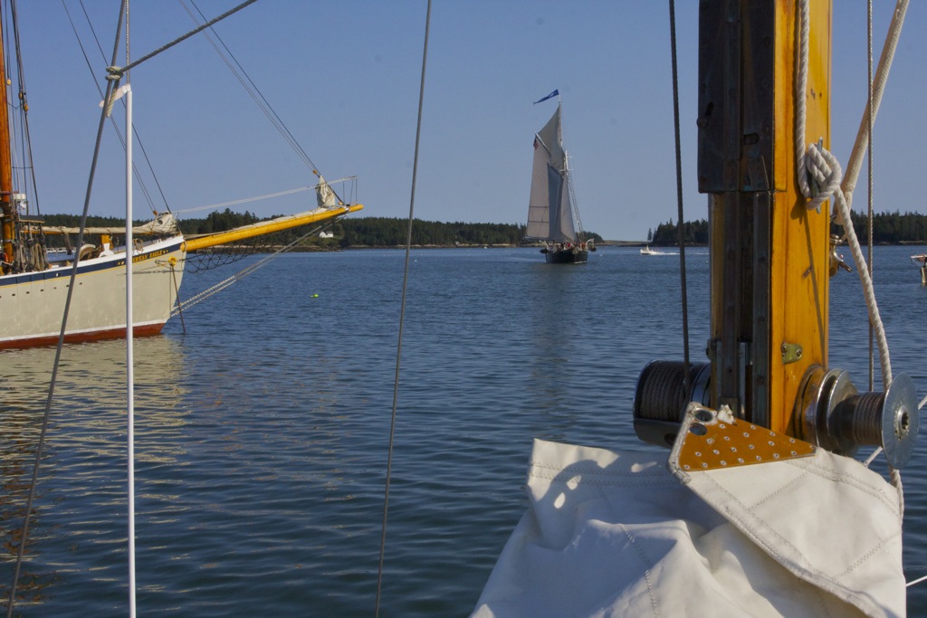

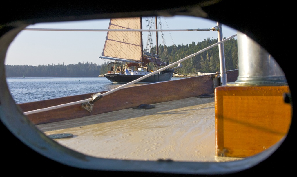

The captain steered the same anchoring maneuver, all under sail. This was the schooner Beaudoin. Beautiful sight in the slanting afternoon light. These old boats, still getting around the coast of Maine on antiquities.
