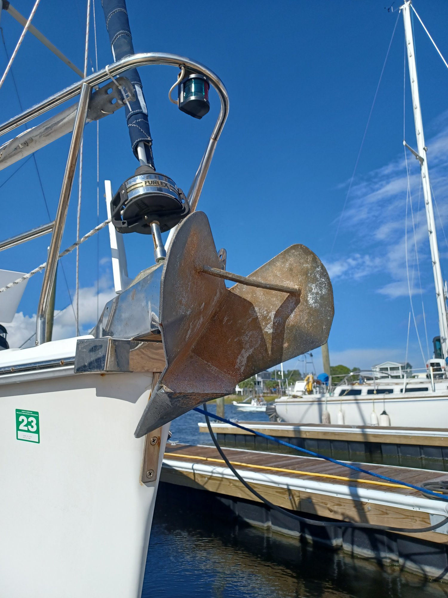

I'm trying to identify the grade of chain on a recently acquired 2005 Hunter 33, < 15000lb. The prior owner had 115' of triple strand 1/2" or 5/8" line back-spliced to the last link of 60' of chain... the links seem to have inside width of about 9/16" and inside length of 1" and a diameter of 5/16". The links seem to have "LL" and "wm4" written on them, but it is difficult to discern. I have tried to find references to these marking without success. the anchor is a spade shape. I want to understand what sort of anchoring power I have now. Chain and line look to be in ok condition, but is it (probably) worth investing in new chain and line and anchor anyway? Any ideas of what I have?
I want to take the boat from Wilmington, NC as far north as Maine and as far south as the Bahamas, where I'll be anchoring in up to 25' of water and withstanding up to 42 knots of wind. I'm thinking I need about 300' of 5/8" three strand twisted line backspliced (so it goes through my windlass) to 5/16 diameter chain and a 35 lb anchor with 1000 cm2 of surface area (how do you measure that>. How much chain, what kind of chain? Chain Grade 30 BBB, Proofcoil ? Grade 40 HT ? I know it is a personal choice, but given fact set above, any recommendation for anchors and bridles? If I have made an uninformed or incorrect statement, please smack me down with an explanation!

With 175 ft of chain and rope you will have slightly less than that recommended to achieve 7:1 scope. I would espeacially look at the anchor size to be sure it is adequate for your anchoring conditions, e.g., bottom, wind, current, boat weight/length. If the chain is in good condition, keep the chain and buy longer rope.
In my case, I replaced the tired and insufficient length anchor rode on my 2005 Hunter 46 with 5/16” x 50 feet G43 G4 chain and 5/8" x 300' 8-Plait Nylon Rope and upsized / changed anchor from the relatively light weight delta anchor to a much heavier Mansom Supreme. Others in the forum like more chain and a different type / size of anchor depending on their anchoring conditions.

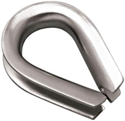

I got no smacks for you but would make sure that your "back splice" goes around a thimbal and is not directly slipped through the anchor chain... and then use a hefty shackle that has been wired closed.

Your existing anchor looks like a Delta. If it is 35# that’s a pretty good size for the boat, but I’m sure you’ll see lots of recommendations for a newer generation anchor (eg Rocna, Mantus, Mason Supreme).
I'm not sure and eye splice (above) and shackle that will feed through my windlass ... It'd have to be pretty small for mine ... Your boat is 4' longer than mine, must have the same size windlass so I will definitely look to use an eye splice over a back splice if I can. Currently the line is attached to the last link in the chain directly, which I do not like either .

To make the transition from rode to chain the most effective and smoothest running through the gypsy when deploying or retrieving is a rope to chain splice. It does require that you inspect the splice from time to time, just like everything on the boat. A thimble adds an opportunity for the rode to bind on retrieval.
