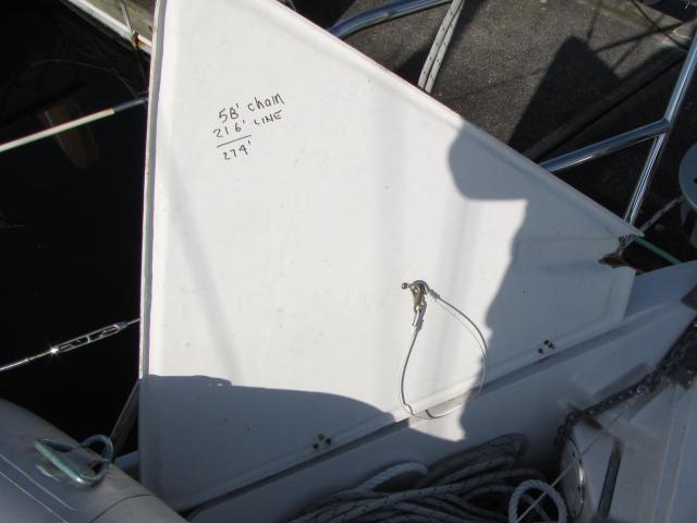

Yes I use the chain shown on My Maxwell 500.
Well if the anchor isn't set and the anchor doesn't hold...............Good night Johnboy.
Wichard long D shackle 1414 breaking load 8,000lbs
1/2' nylon line premium white 3 strand 7500 lbs breaking strength
1/4' HIGH TEST CHAIN swl 2600 lbs
Used this chain calculation for wieght
1/4" anchor chain is 113#/100' =1.13 #/ft
58' X 1.13 = 65.54 lbs
I also wear rubber gloves while on anchor duty.......
paulj :troll:
