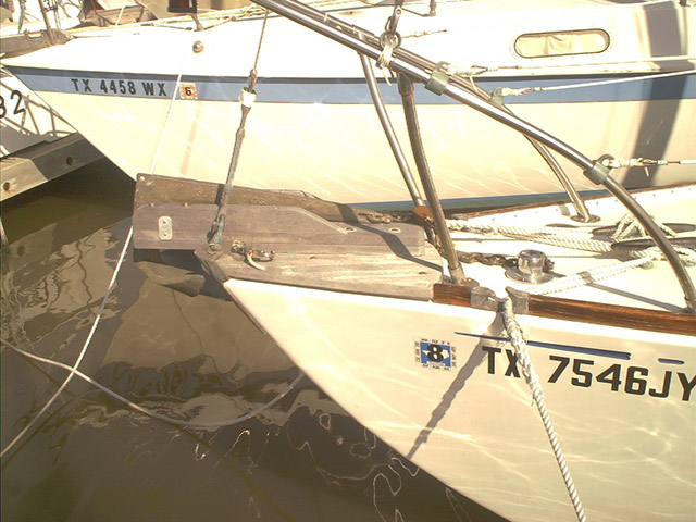

I carry 75 feet of 1/4 G4, 22 pound Bruce on a 25 foot boat. I've anchored from the tip of Texas, to Annapolis, and through the Keys and Bahamas. Altogether, over 11,000 miles.
I use a snubber always
I can count on one hand the number of times I've been into the nylon.
Gunni
