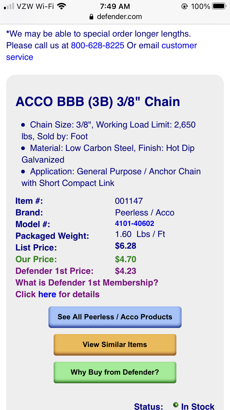

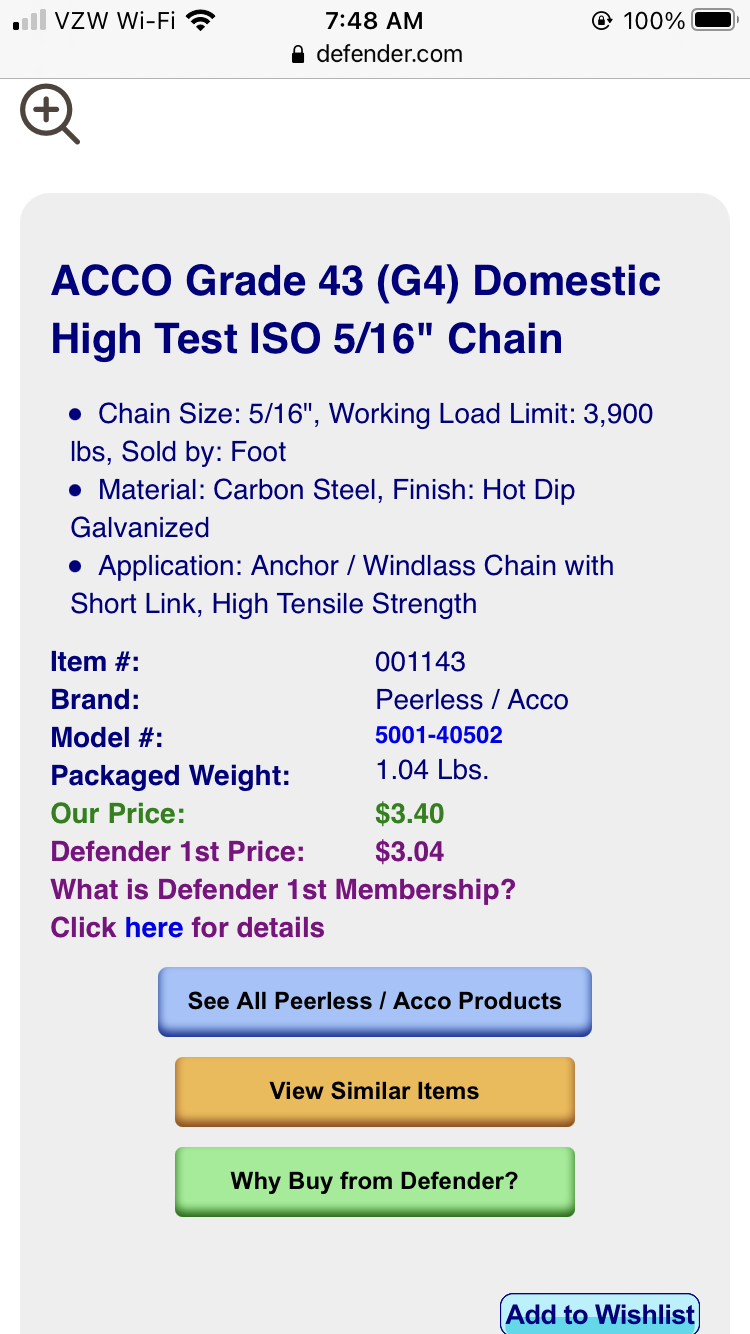

Hello all.... so upgrading my anchor chain. I currently have 3/8bbb which weighs 1.6lbs per foot, a working strength of 2,650 and a cost of $4.70 per foot. G4 is an option with a replacement gypsy and it weighs 1.04lbs per foot, has a working strength of 3,900 and a cost of $3.40 per foot.
I currently have 100 ft and want to move up to 250 ft so I’m terms of weight it would be 400lbs vs 260lbs. All around better for cheaper unless I guess one needs the extra chain weight or just want to use less chain and have a greater weight.
Opinions greatly appreciated.... thanks.

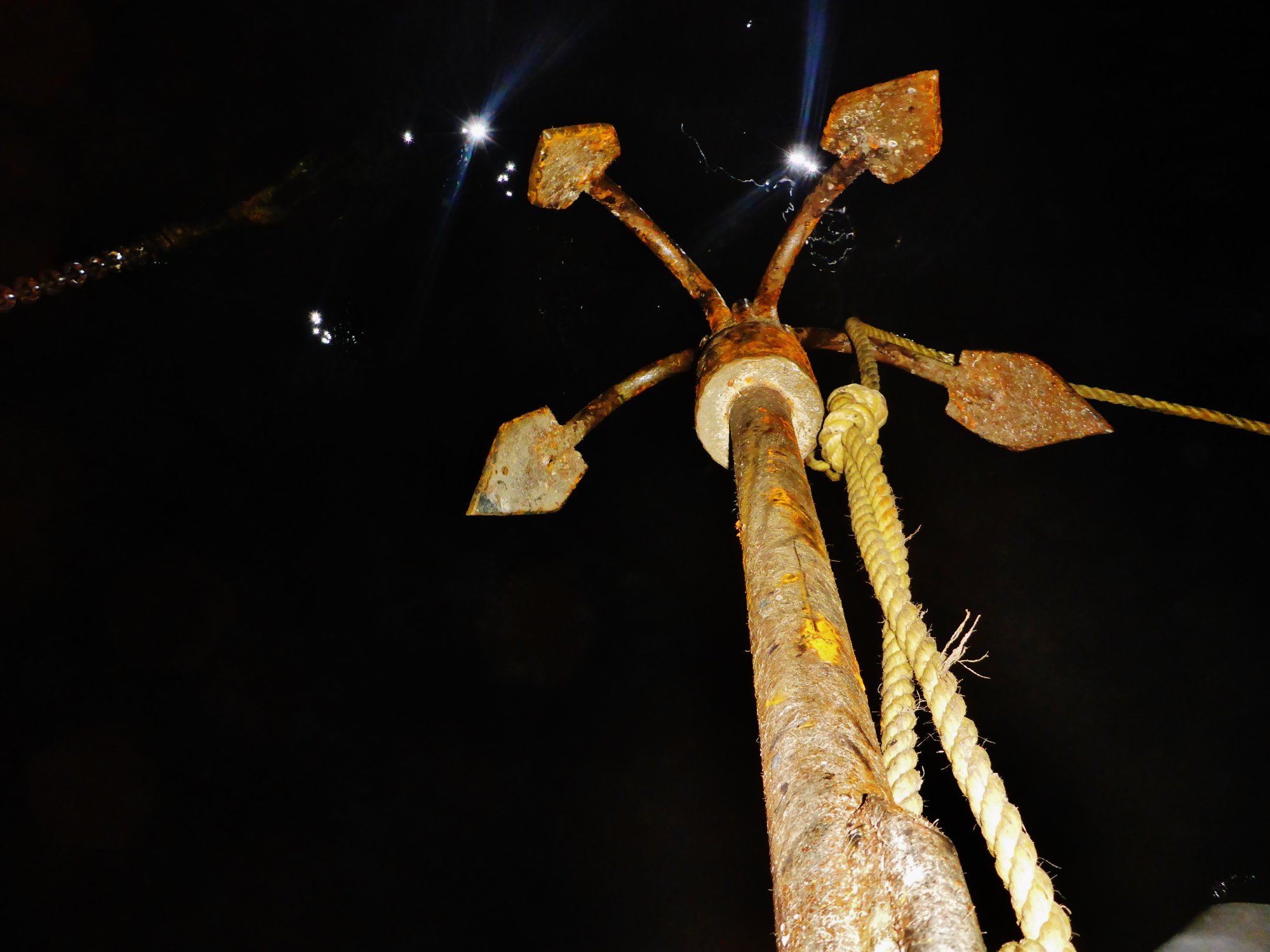

I'd have to disagree with this. I've used all chain or cable on every boat except light weight multihulls. The anchor below (about 300#) was fouled somewhere in the middle of my chain. It was dark and I shudder to think what it would have done to the bow had we been pulling the chain remotely, never mind what it would have done to a line rode over a day or two.

Hello all.... so upgrading my anchor chain. I currently have 3/8bbb which weighs 1.6lbs per foot, a working strength of 2,650 and a cost of $4.70 per foot. G4 is an option with a replacement gypsy and it weighs1.04lbs per foot, has a working strength of 3,900 and a cost of $3.40 per foot.
NYSail just to clarify, you are comparing 3/8" BBB to 5/16" G4 in your original post correct?

Thank you both......
The chain I’m looking at is American chain both galvanized from defender marine. 3/8 bbb and 5/16 g4.

Price difference is due to link size. I guess I'm not understanding your question?
5/16" = 0.3125" diameter
3/8" = 0.375" diameter.
17% difference in material - in just steel. Price difference in cost is not far off that at about 27%, but don't forget you've also got a measurable addition in galvanizing material and actual more chain length in the 3/8" links.... Seems like about right on the price differential...

I explored Fisheries Supply and found the same pricing difference. BBB galvanized is more expensive than the g43.
The G43 has a more than double WL about 5400 than the BBB at around 2600.
24,495
You will need to factor in the Gypsy cost as BBB and G43 use different gypsy configuration for most windlasses.
