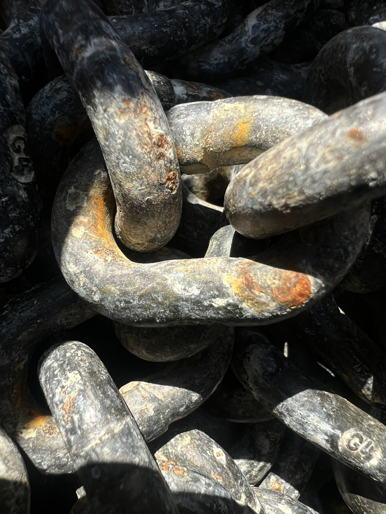

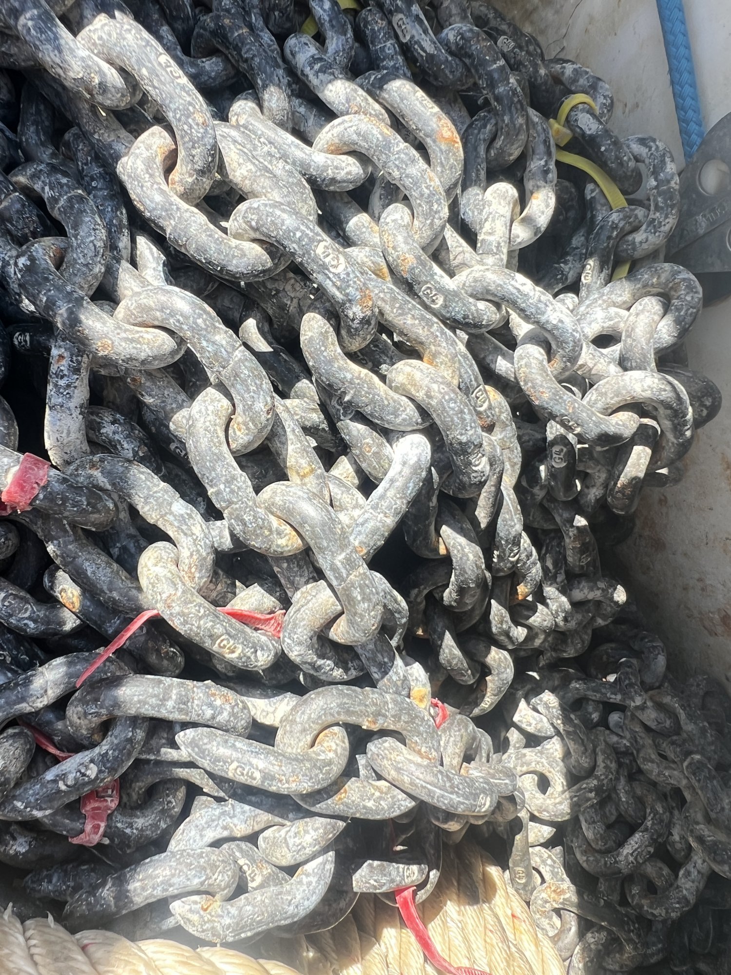

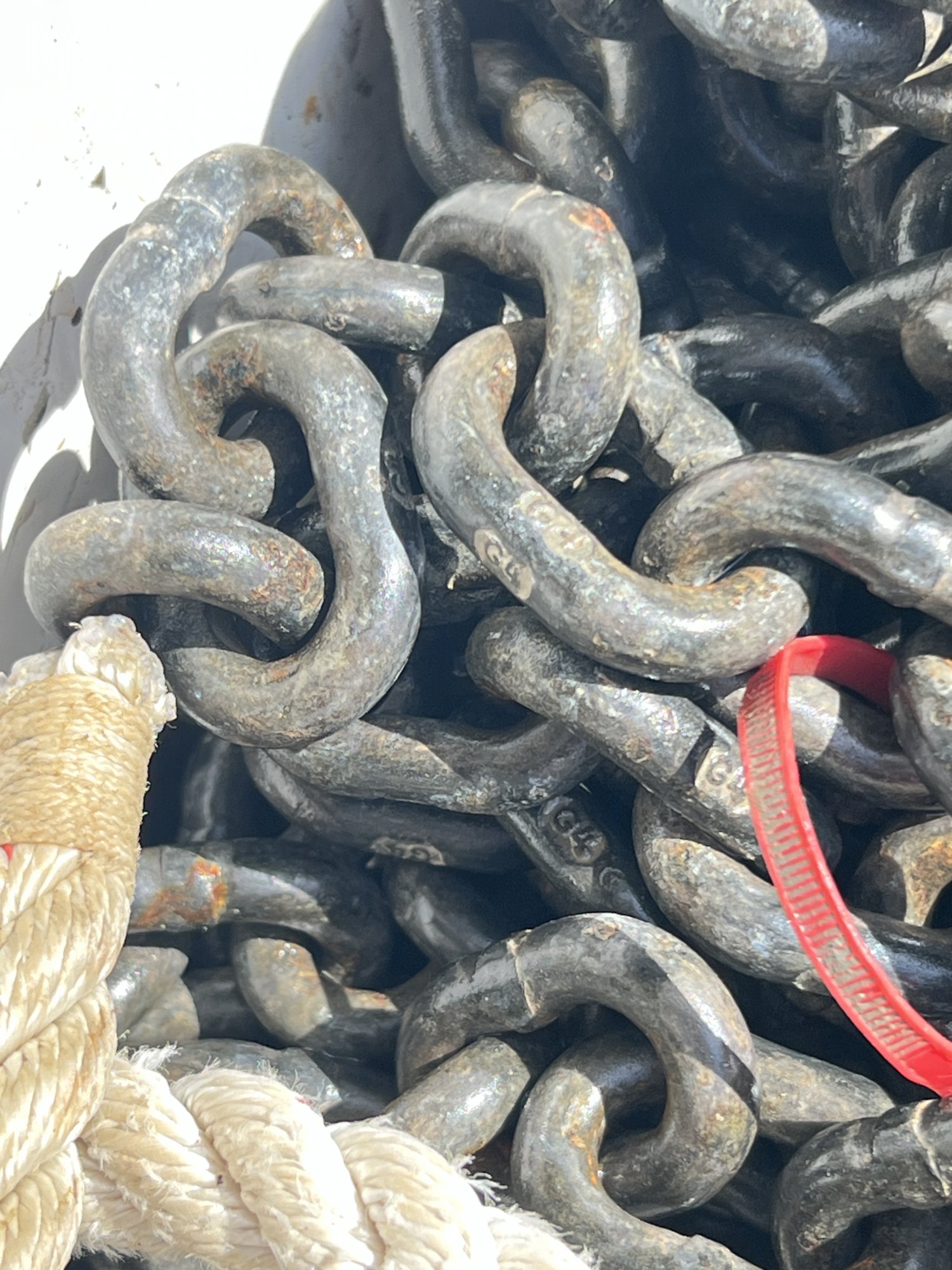

I’m noticing corrosion on my 134' Peerless ACCO 5/16" G43 from Defender after 2 years of install. Anticipate getting more longevity before noticing corrosion. Is this normal?I wash down the entire chain with freshwater after every cruise. I’m wondering if I should be doing anything additional? It seems like the anchor locker gets adequate ventilation through the furler hole.

Actually you chain doesn't look too bad in my opinion. I normally get 5-6 years out of chain before it becomes quite rusty.
I do have a dock-mate who rinses his chain after every cruise with Salt-Away. He thinks it is very beneficial. I am going to try it this year myself to see if I can extend the chain life.
One of the biggest destroyers of chain is the abrasion when the chain goes through the gypsy and bow rollers. That action tends to wear off the galvanizing and the loss of protection hastens the demise of the chain. And then there is the abrasion between links from the chain moving on the sea bed.

While ACCO is terrible quality chain (galvanizing), yours doesn't look unusual. But that would also depend on the amount of use it is getting. If this is from a dozen anchorings over 2yrs, then probably bad, but not if it is from a lot more anchorings.
Most of the corrosion spots look like they are on the weld. This is a tough area for galvanizing, as it often gets a bit rough there and can chip off. The other spots look like where the links connect to each other, and this is also normal.
But search around and you will find many stories about poor ACCO quality. We had a batch completely rust solid after 6 months, and another batch after 2yrs. The second batch was a year old when we bought the boat and hadn't been used more than a few times. It was rusted solid after a year of high use.

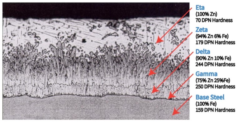

I don't think your chain looks very rusty. I think I've posted this before, but I'll do it again here.
Attached find a micrograph of hot dipped galvanizing. On the right hand side you'll see identified the different microstructures that are formed during hot dipped galvanizing. The top layer is called Eta and is pure zinc, very soft and can wear away easily. In your photos, you are showing a rust discoloration most noticeable where the chain links wear against each other. That wear will easily remove the Eta layer.
The next layer down you have the Zeta layer. Note that it is about 6% iron. Also note that the hardness of this layer is notably higher than the Eta layer. Your chain has likely worn the Eta layer down and what you are seeing is this Zeta layer. It will have a "rusty" appearance as seen by your photos but this layer is still protecting your underlying chain links. Or said another way, your chain is fine.
Just keep an eye on your chain, this discoloration may increase slowly over time as the chain slowly wears through the Zeta layer. You should see a visibly deeper rust discoloration when the wear goes completely through the Zeta layer and finally gets to the Delta layer. Your chain is actually still protected at that point, and it will last like that quite a length of time - note the hardness of this layer is substantially harder than either of the top two layers. But once the chain has worn to there, it would be a good time to start looking to either get your chain re-galvanized or replace it. It should take years to get to this point.

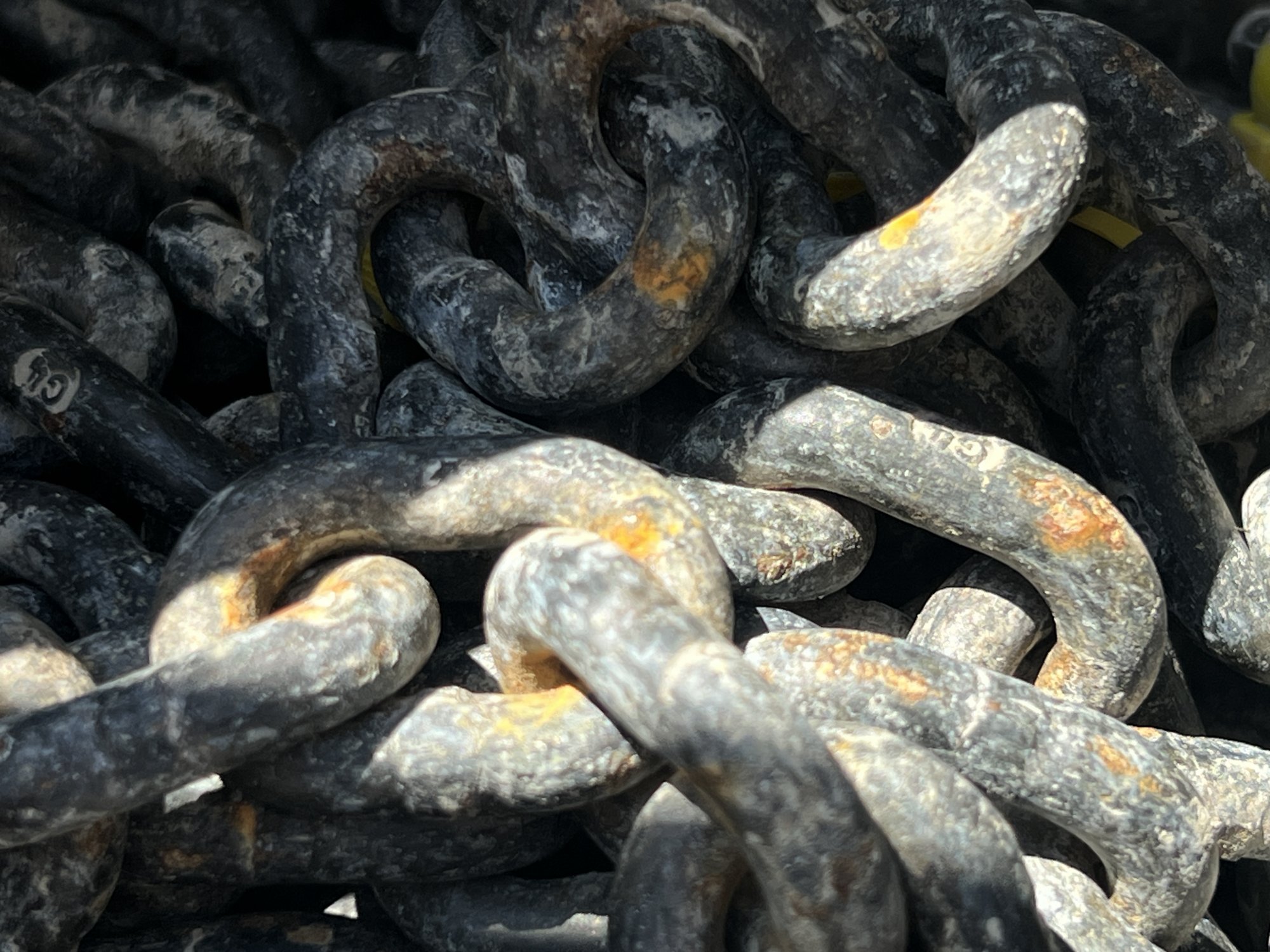

Here’s a picture of it dry. I had rinsed it off very well after our last sail.
I would consider that normal after 2yrs of use - unless those 2yrs meant anchoring 3 times or something. Pretty good, in fact.

Look, the truth is you can't evaluate your chain through photographs. If you are really concerned and want to know what the real condition of the chain is and if you should be concerned or not, you would have to have the chain examined and evaluated through a metallurgical examination. If you wish to do that, I can provide that service. If you do want to do that, send me PM and we can talk about it.
