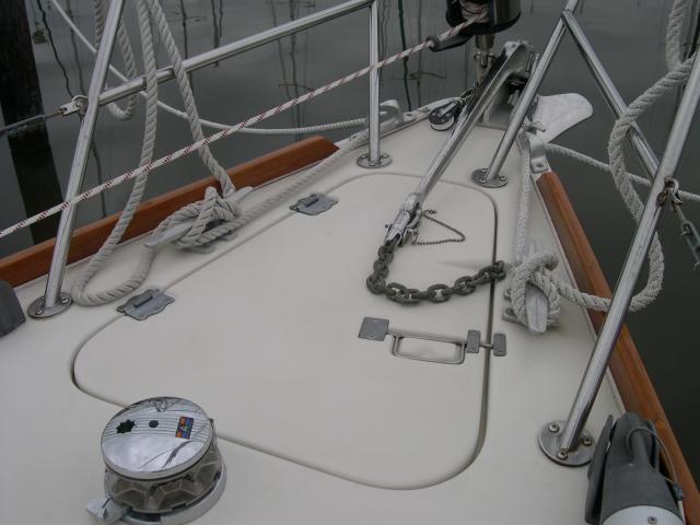

We mounted a manual vertical-axis windlass made by Simson Lawrance that works very well for us on our P36-2. Unfortunatly Lewmar bought S-L and discontinued the manual model. On thie model the rode exits the gypsy without a 90 degree elbow to direct the rode into the well. I coil the rode into the well by hand as I crank the windlass. I know of one person that is now watching Ebay for one. If it were not so hard to post a picture on this new site, I would show you a picture of our installation.
Send me a message with your e-mail address if you want a picture.

We have a 35lb. CQR clone by Spartan Marine. It (and a CQR) sit in the roller that is part of the stem fitting on the Pearson.
Here it is, if I can do it right.
Dave s/v ARIEL

There are two holes in the anchor roller to fasten the anchor to. In the fifteen plus years that we have had ARIEL we have never tied it in, even while sailing off shore. Now I know this is not good seamanship so don't scold me.
The shank is held in a pin lock fitting to keep the anchor on board as shown in this picture.
The anchor has a slight concave form between the fluke (or plough) and the hinge pin. When the anchor is raised, the roller sit in this concave section. The weight of the anchor has held it in place all these years.

Now I see how it works! A pin-lock fitting is what I need to keep the anchor in place. I like your manual windlass setup and will look for a vertical-axis unit to mount in the same way. I am looking forward to easier anchoring next year :)

We leave the rode in the roller and then directly to the cleat. I have a long pin to put through the roller fitting to keep the rode from jumping out.
I have tried putting the rode through the chock and then to the cleat to slow the "sailing" at anchor but it made no differance.
Just a note on a previous post, the pin fitting that we have to hold the shank on deck is similar to the "Anchor Lock" shown in both the Defender and West Marine catalogs. Defenders model 000144 is cheaper.
