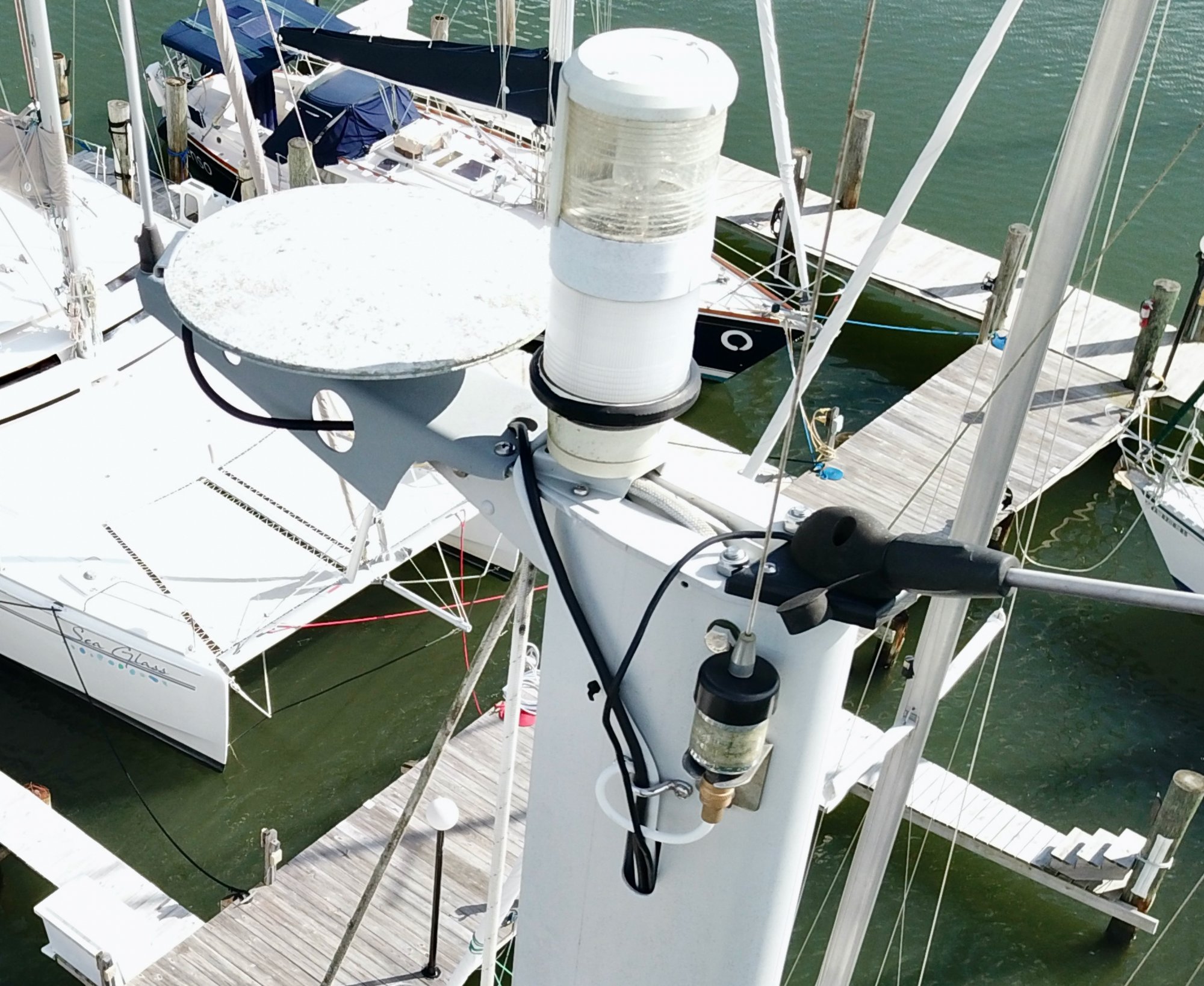

I would like to replace both anchor and steaming light (bulbs) with LED on my 2005 Hunter 33. Checking out the documentation I cannot find the make/model. Does anyone have any insight? Checking on the SBO site, it looks very similar to:

I recently replaced the anchor light on my 2005 Hunter 33 with a White Polar Star 40 from Dr. LED (for aqua signal series 40 and others), indexed.

It uses offset bayonet socket. I replaced my anchor light bulb with Marinebeam tri-lights smart LED. Steaming light bulb remains normal filament type.

We just pulled them and compared with led's from Marine Beam. The bayonet and socket has information regarding what type of bulb it is so not to hard to find replacement.
