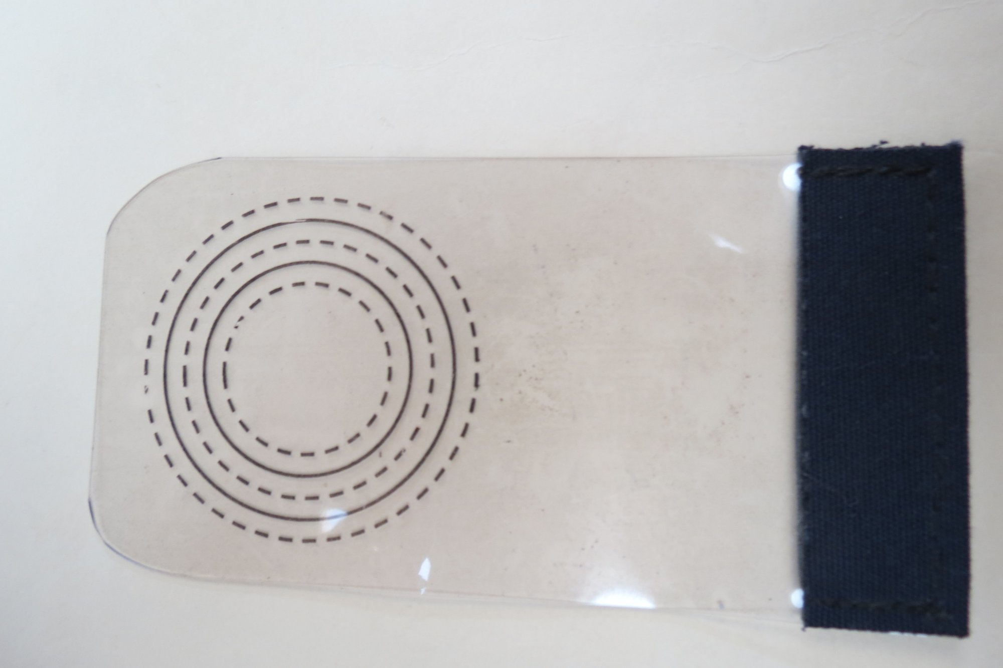

So I created a visual aid. It is a piece of light window glass vinyl that has been printed with concentric circles. Like this-
I sewed a piece of Sunbrella to the edge for easy holding. Now to answer the important question of being secure or dragging, I just hold this against my chartplotter screen and see if I can align the partial circle segments to the same concentric circle. It helps if you have placed a mark on the screen where you dropped the anchor, but that is not mandatory.

You can adjust the chartplotter scale so that your circle segments are within the range of the concentric circles.
Above, clearly I am within the outer-most circle proving that I am still secure with my anchor holding. Quick and easy. Even at 0100 in the pouring rain.
I've been using this aid for several years and given copies to a couple of my sailing friends.

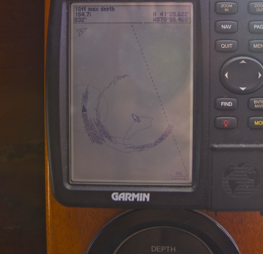

Nice tool! I use a GPS CP, 24/7, to keep track of the anchor. Once you've done it for a while, the signs of dragging, wind shifts, tidal change, are easy to spot.
When an anchor drags, it can show in a step that wasn't tidal. More importantly, it will trace a 'falling leaf' pattern while an anchor is dragging. I had that happen a few years ago when I drop the anchor on ledge on an island off Portland Me, at night.
It started to trace a small increment of growing arcs in the darkness. I could tell something was moving, just a foot at a time. Then those arcs began to grow! I bolted topsides and started the engine.

I recall this one showed a big-sudden wind increase. I use the white pointer to mark anchor location (at drop- plus set length), and to measure distances.
The Raymarne has a "track" function. When anchored, hit the start-track
The Raymarine has a "track" function. Once anchored, put the start track button and it will leave a line where the boat has gone. Like leaving breadcrumbs. you might swing in an arc, but should not go too far backwards as it might indicate anchor drag.

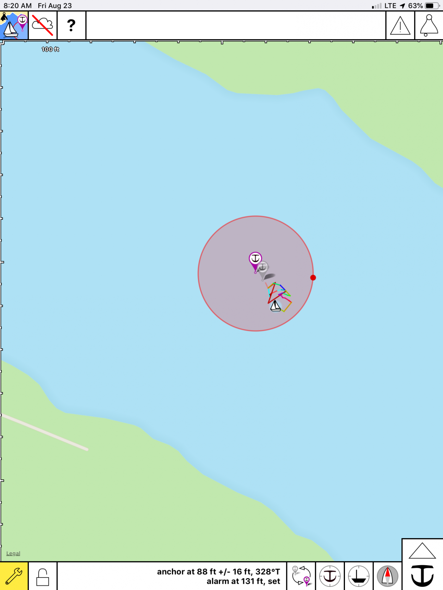

There are various anchor apps to choose from. The one I use is called simply “Anchor”. It does track the movement of the boat to a settable distance (5’ increments) or continuous.
Also you can raise the anchor if you go ashore with the device, lower the anchor on your return and then click on the app’s “Revert to the previous anchor position” icon. Ops Normal.

My antique Garmin uses 4 watts (black and white). Considerable but I've found having this anchor sentry on 24/7 is important to me, as well as a convenient clock. The constant tracing gives wind, tide and swing info on our anchor at a glance day or night. A phone is a nice remote anchor watch in your berth but not likely to have traced the detailed info of the boats movement. I remember many nights with a hockey puck compass or trying to get a bearing on distant lights. This is way better for me. :)

This is after just a few hours. The circle is where I have the anchor alarm set for. Unlike a chartplotter, the app is pretty coarse not providing much detail.
