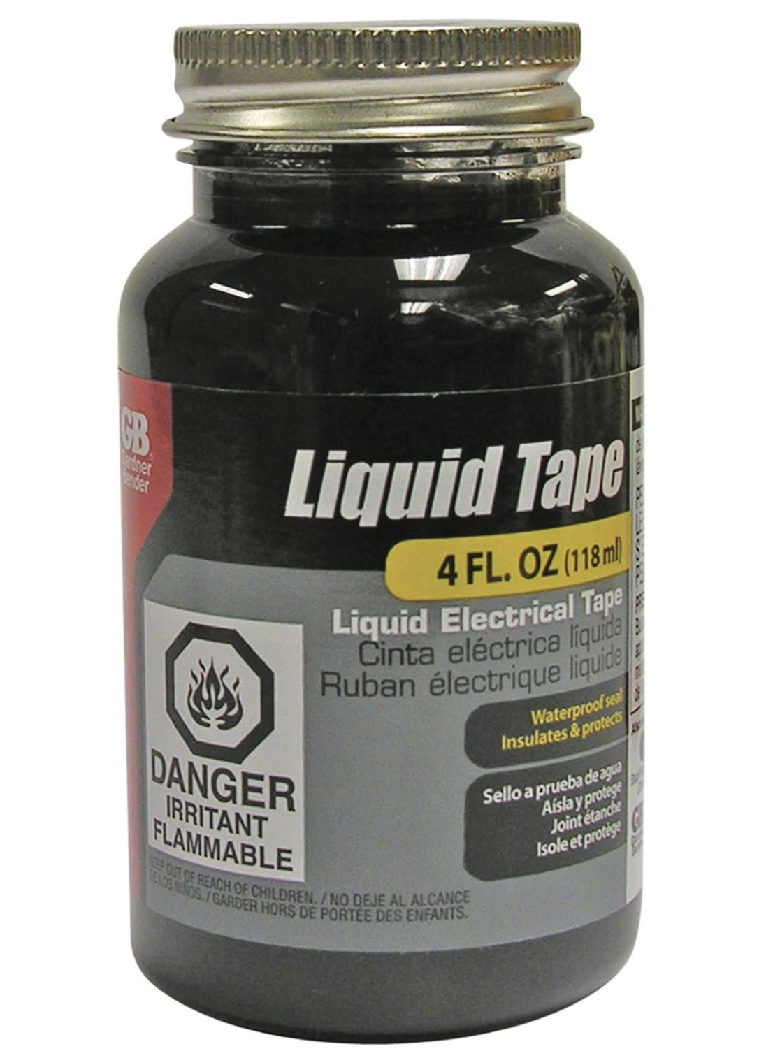

And I suppose heat shrinking could wait until I was back at a dock.
or use this.
They used this, when needed, for Hunter OEM wiring, per Joe Kerr, the electrician who wired my boat.
Jim...
