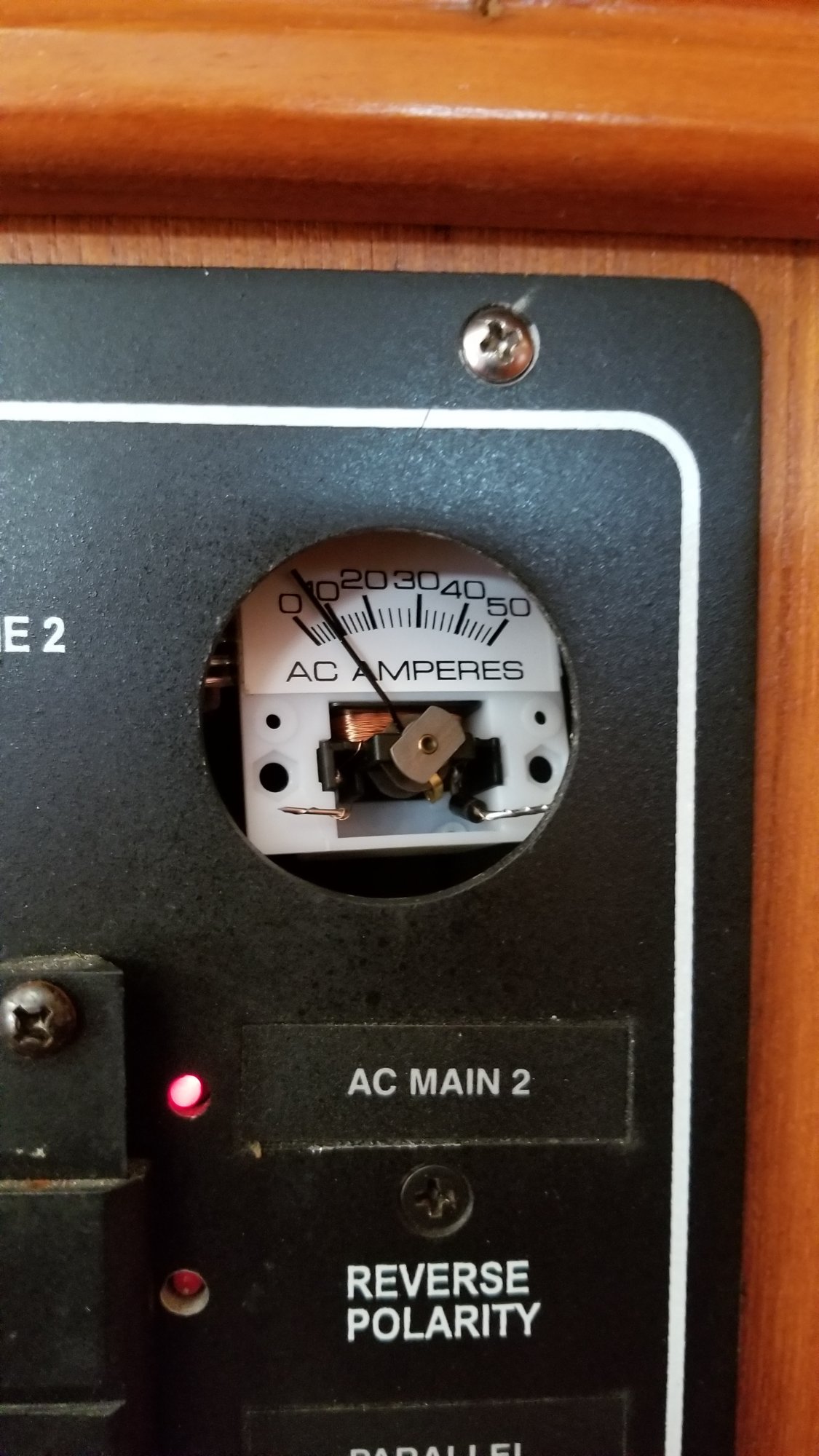

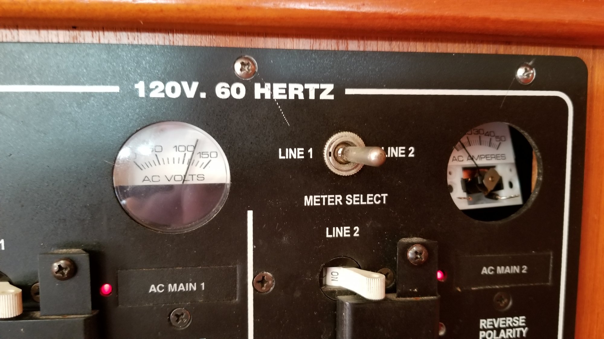

Hello. Any one know where to get AC amp meter guage for 2003 426? It is analog 1.5 inches in size. I can't seem to find one anywhere. Or thoughts on other options?

Post a picture please. I know of some electronic supply houses that could have a meter that would fit. Specific dimension would help. Meanwhile I will look for the link to the supply I am thinking of.

Blue Sea make ammeters. Looks like a 120V one. Have you tried local electrical shops?

Your panel appears to be a Paneltronics product. They made many of the electrical panels for Hunter boats. When we purchased our 1991 boat in 2002 the DC amp meter was dead from some sort of surge causing the heat sink to melt. Contacted Paneltronics and they sent me an identical replacement. You can reach them here: Paneltronics: Electrical Panel Manufacturer
