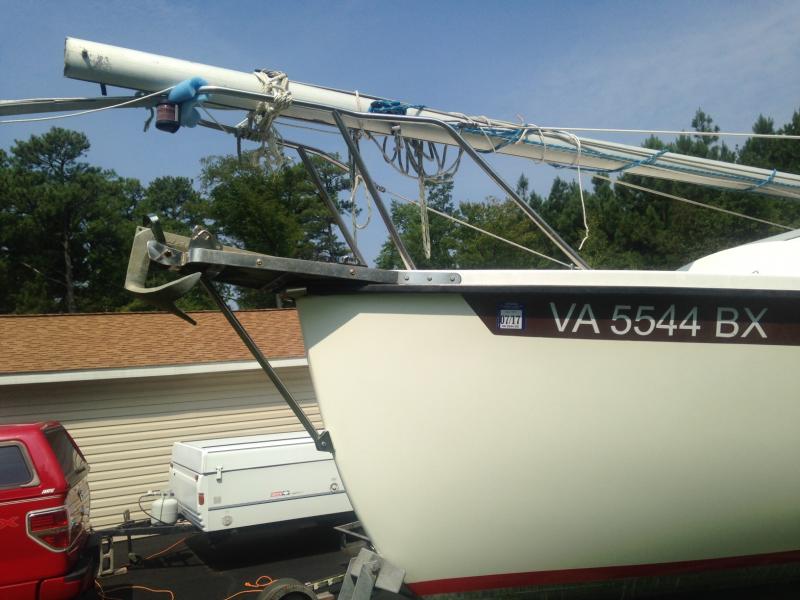

Here is a shot of the bow. I have a block attached to the anchor roller system for the tackline.
The idea was to run the tackline from the block on the anchor roller to the cockpit through stanchion fairleads.

As they say, "just checkin". It's not just about loads, it's about how those loads are applied to the hardware. If you had a block at the deck, but a 40 degree deviation in the line, there's a lot more load at the block than a deviation of 5%. Conversely, the same 5% deviation at the top of the stanchion would be a lot more subject to the overall forces on the line. A 40% deviation at the top of the stanchion would have the pipe coming to sit with you pretty quick.
A 5% deviation would hardly reflect a 100 lb pull on the line, but a 40% deviation would.
23,518
BO, keep the line low to the deck nearest the base of the stanchions and use Johnson bullet fairleads (or even other makes of furling line gear that have sheaves - but you're on a budget, right?), you should be just fine.

My 5/16" tack line runs down to a small block snap shackled to the stemhead, then back to the cockpit through a series of small bullet blocks shackled to the stanchion bases.... there is absolutely no pressure on the stanchions them selves. The same tack line can be used as a fore guy for my spinnaker pole by moving the stemhead block to a padeye on the foredeck... the rest of the line uses the same stanchion based blocks to get the line back to the cockpit area.
The tack line can often require some winch power.... so I would never consider running the tack line through stanchion mounted fairleads.

BO;
Follow the advice of Stu and Joe. You are correct about your boat and the loads when only using the boat in light airs at Colonial Beach. I use to sell them and to the best of my recollection, that is how I ran them when at Smith Mountain Lake many years ago. Good Luck on the install. Fair weather and happy sailing.
