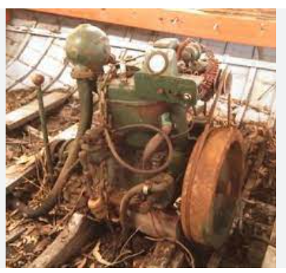

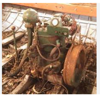

The photo that Ralph posted is not the engine in the boat in question.
Just like this is not a photo of me

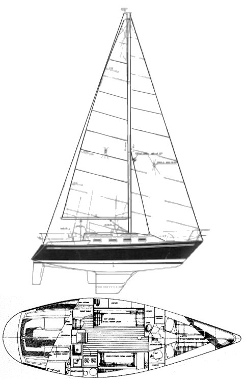

From sailboatdata.com
