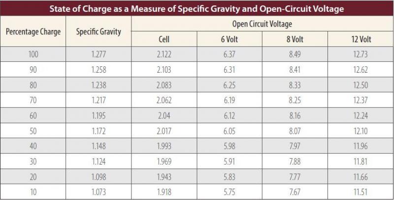

The short version answer is no - although your batteries will be happier and last longer if you don't routinely draw them down below 50% capacity.

Yes, I have a Magnum Charger/Inverter 2800 watt with the Magnum Battery Monitor. Showing 12.3 Volts now that the inverter is off.

12.3 is about 60 - 65% state of charge. I hope you are charging fully often.

For voltage to adequately reflect the state of charge the battery must be at rest for a couple of hours. If a voltage reading is taken on a battery that just a few minutes before had been subjected to a load the voltage reading will be lower than the actual and will reflect a lower state of charge.
