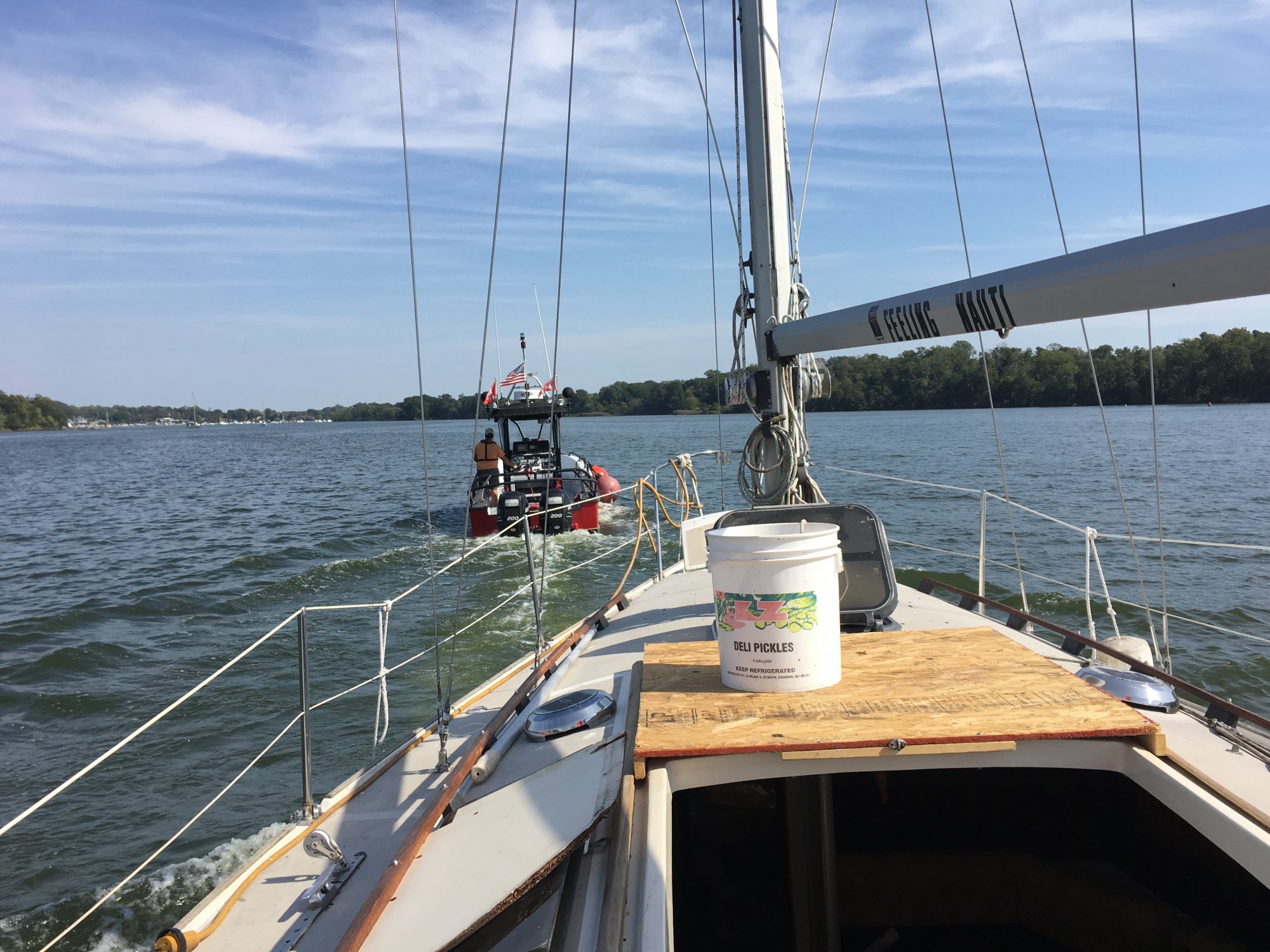

I used to think, I would never need to be towed. My last boat had a brand new outboard. This, new to me has a Universal M20.
Today it stopped working. Last year, just for cheap insurance I got Unlimited towing from BOAT US for $125. Best money I've spent. I got towed into my marina from the middle of the Sassafras, a tow without my unlimited membership would have been about $900. I recommend everyone should have it, either Boat US or SEA TOW. Don't leave home without it.
